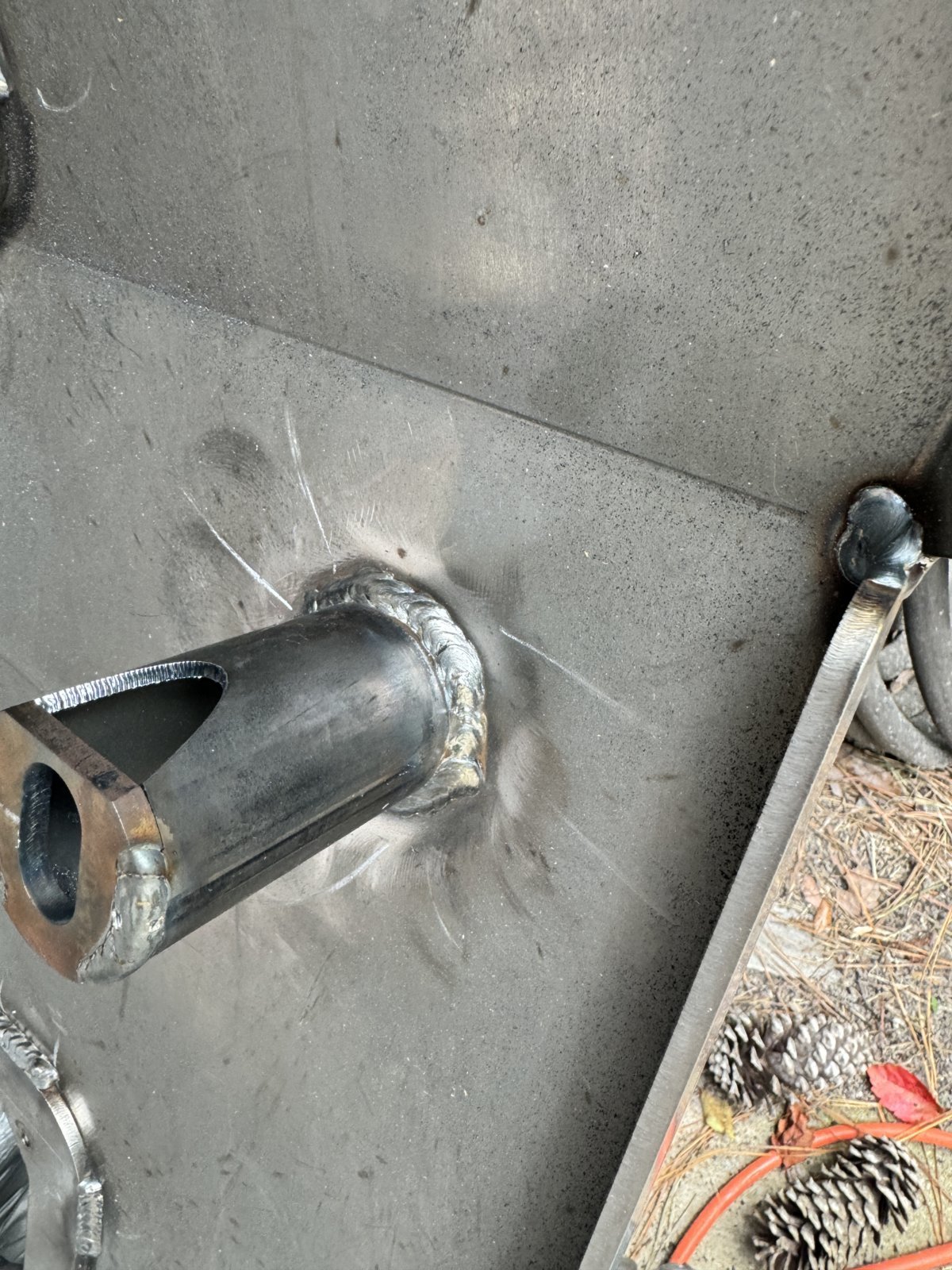

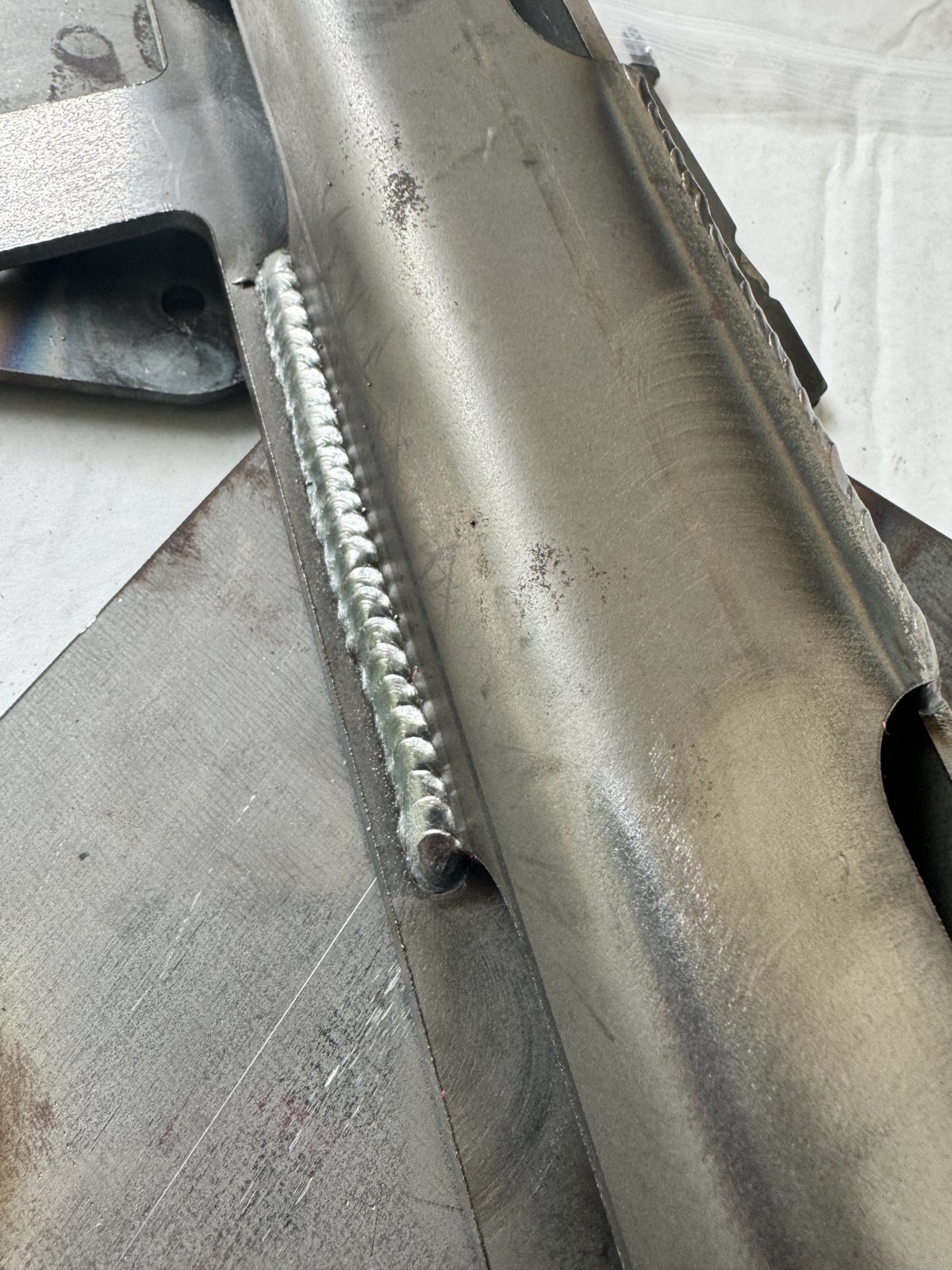

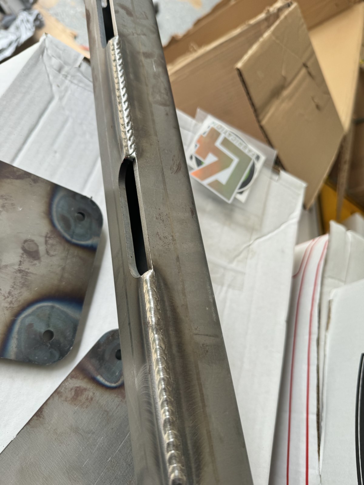

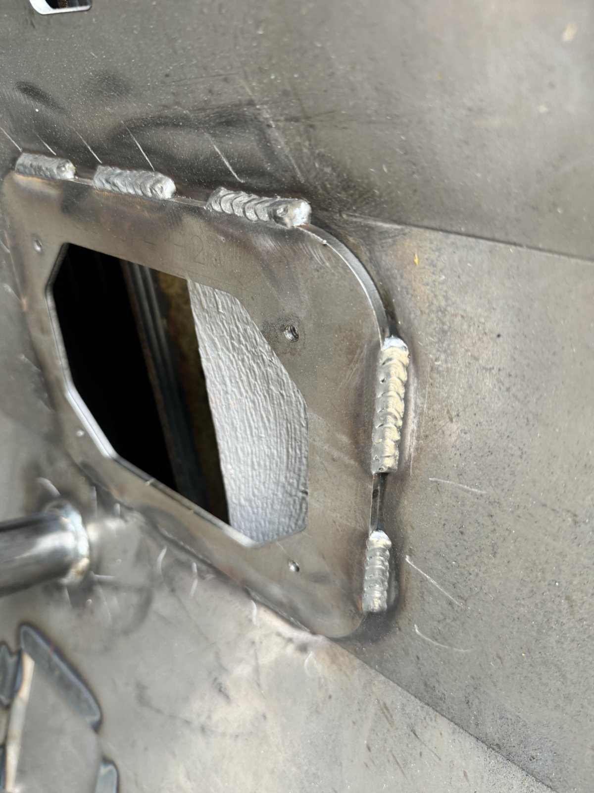

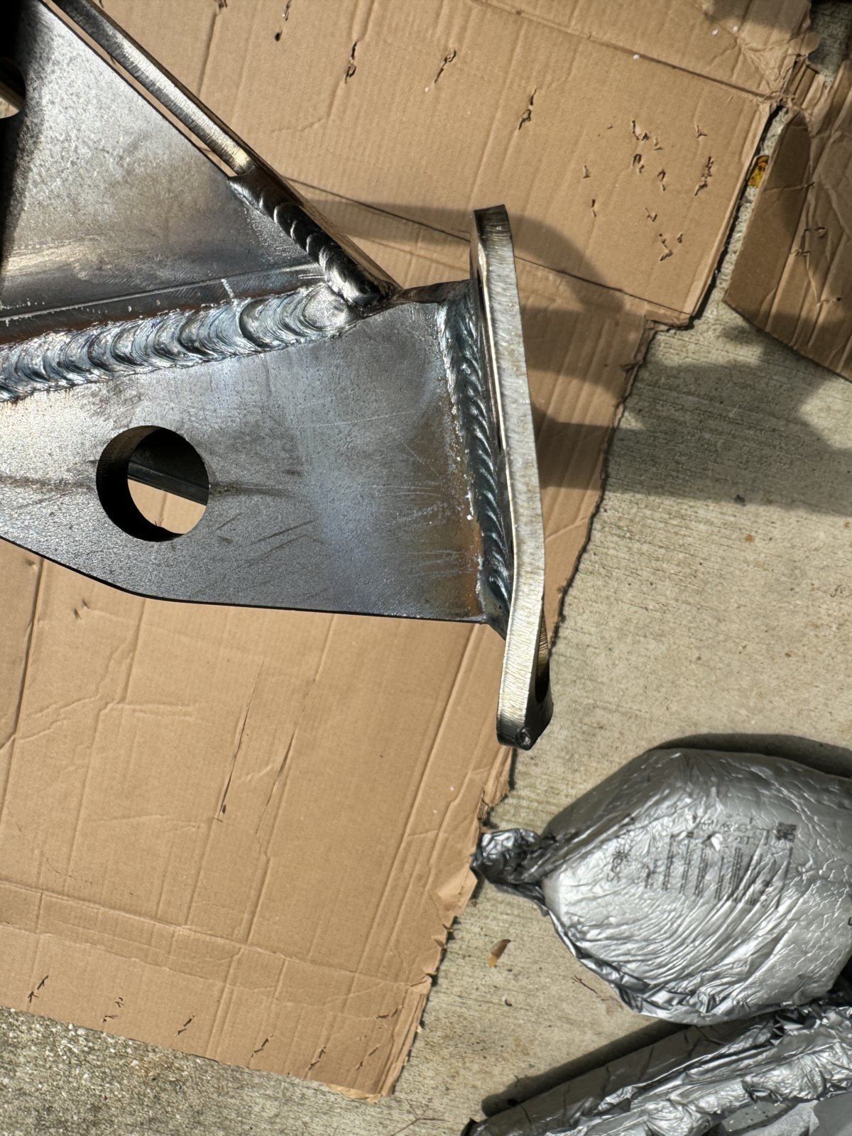

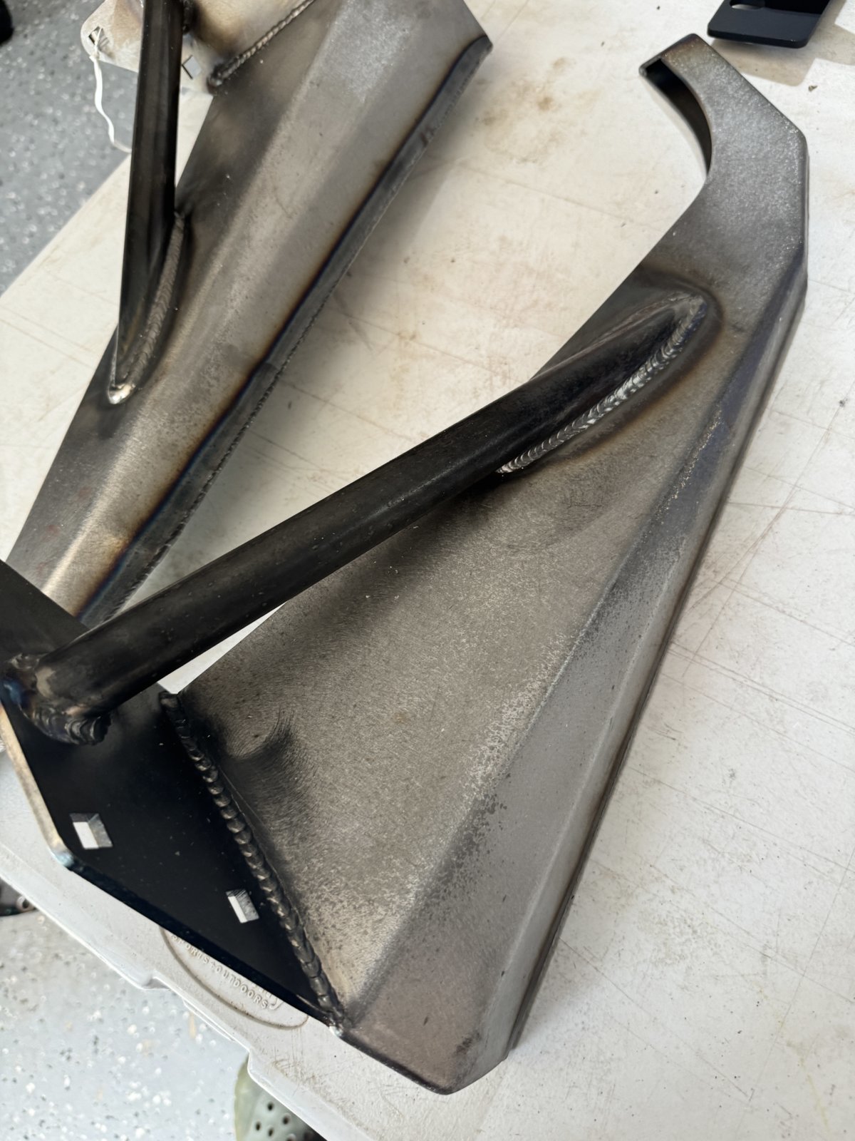

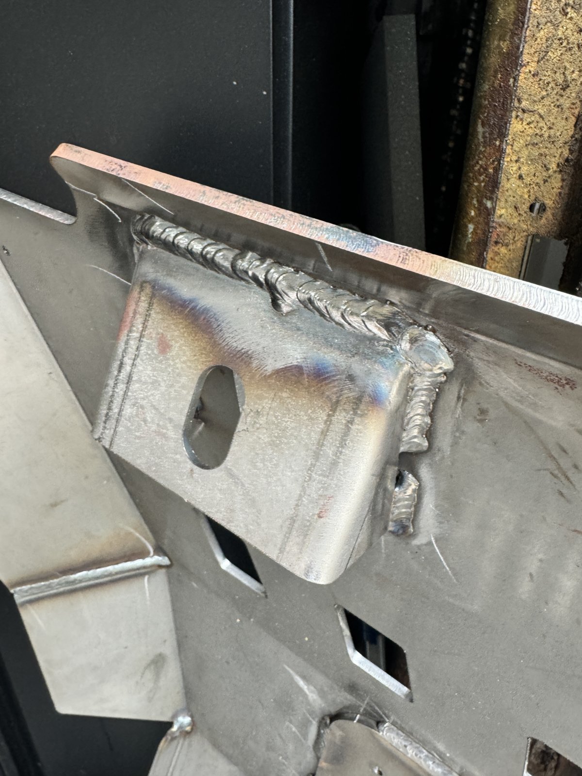

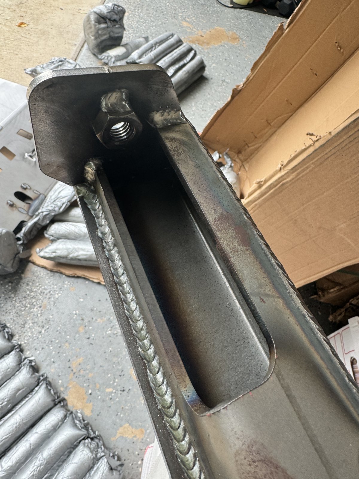

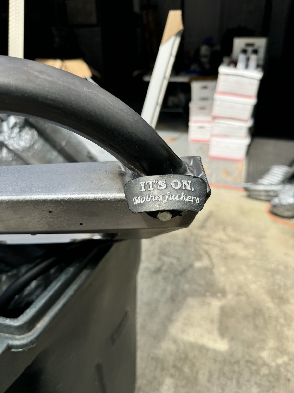

    Alright Tim, you motivated me to open the boxes. Here is some weld porn for you all, no complaints.
    IMG_1167.jpg IMG_1168.jpg IMG_1169.jpg IMG_1171.jpg IMG_1172.jpg IMG_1175.jpg IMG_1176.jpg
    Tons of room with plate option for fog locations under the wing.
    One small shipping bang.
    Test fit of the first mod.

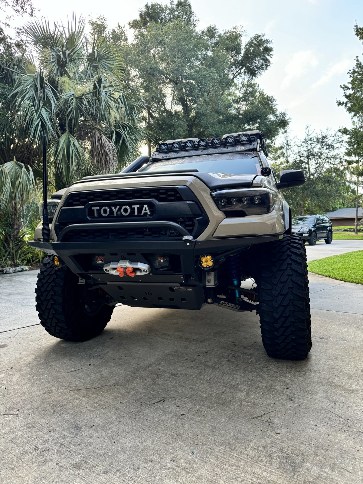

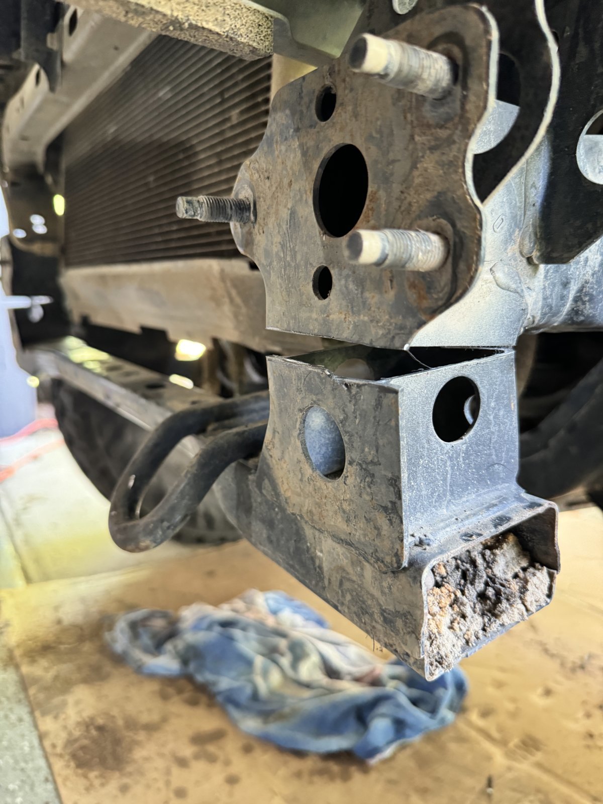

    Got mine installed yesterday. Took a bunch of extra elbow grease to make the bumper supports work with the King resi mount and the skid plate to play nice with the RCI mid skid. Both involved a decent amount of fab work. Simple cutting, grinding, making new holes, just time consuming. I used the BD fogs with a galvanized L bracket and SS self tapping screws into the wings. Antenna is drilled into the bumper. Only issue I had was the C4 frame support would not go into place with out some hammering. Maybe my frame was a little pressed in. Used Steel it for the bumper and skid. C4 has some really good install videos, so I decided not to film it.
    I want to mention, if you have a bumper with a winch already, this bumper will make the winch sit higher. I had to cut some of the front center support to make it all fit. It's like everything is higher and tighter than before. It's a bit more difficult to reach the free spool on the winch. I will most likely upgrade the PS cooler with the Mishimoto Fan combo down the road. The supplied cooler just looks real small next to it.

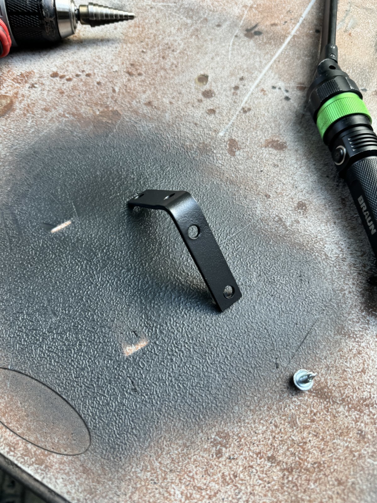

    Bracket for the fog light.
    Have not gone to take a look at it today yet. I was getting these vibes after everything was done yesterday.

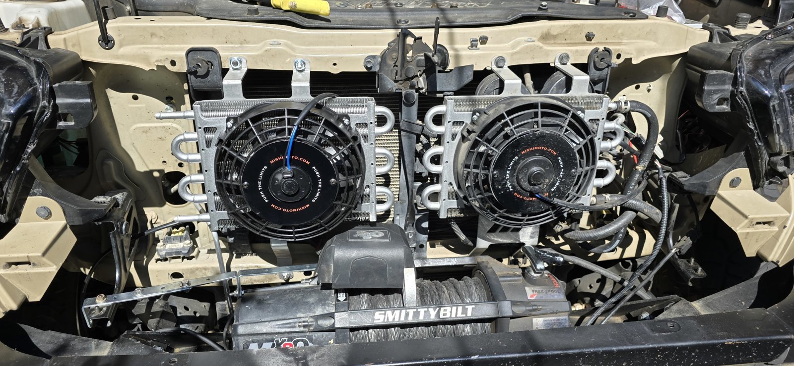

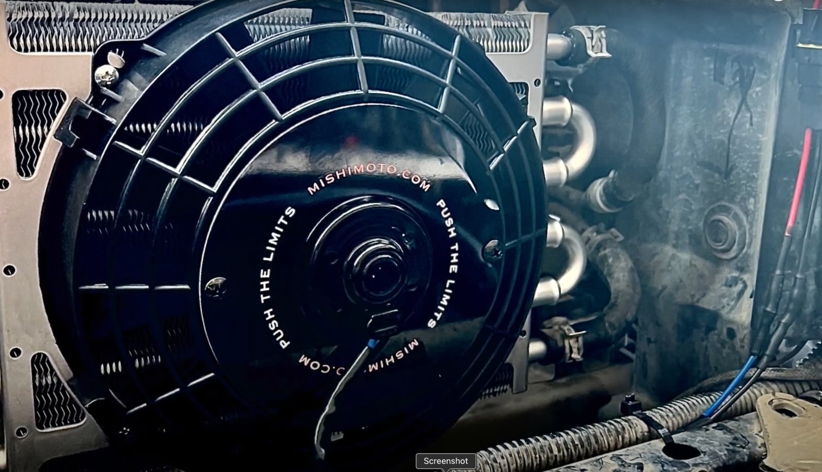

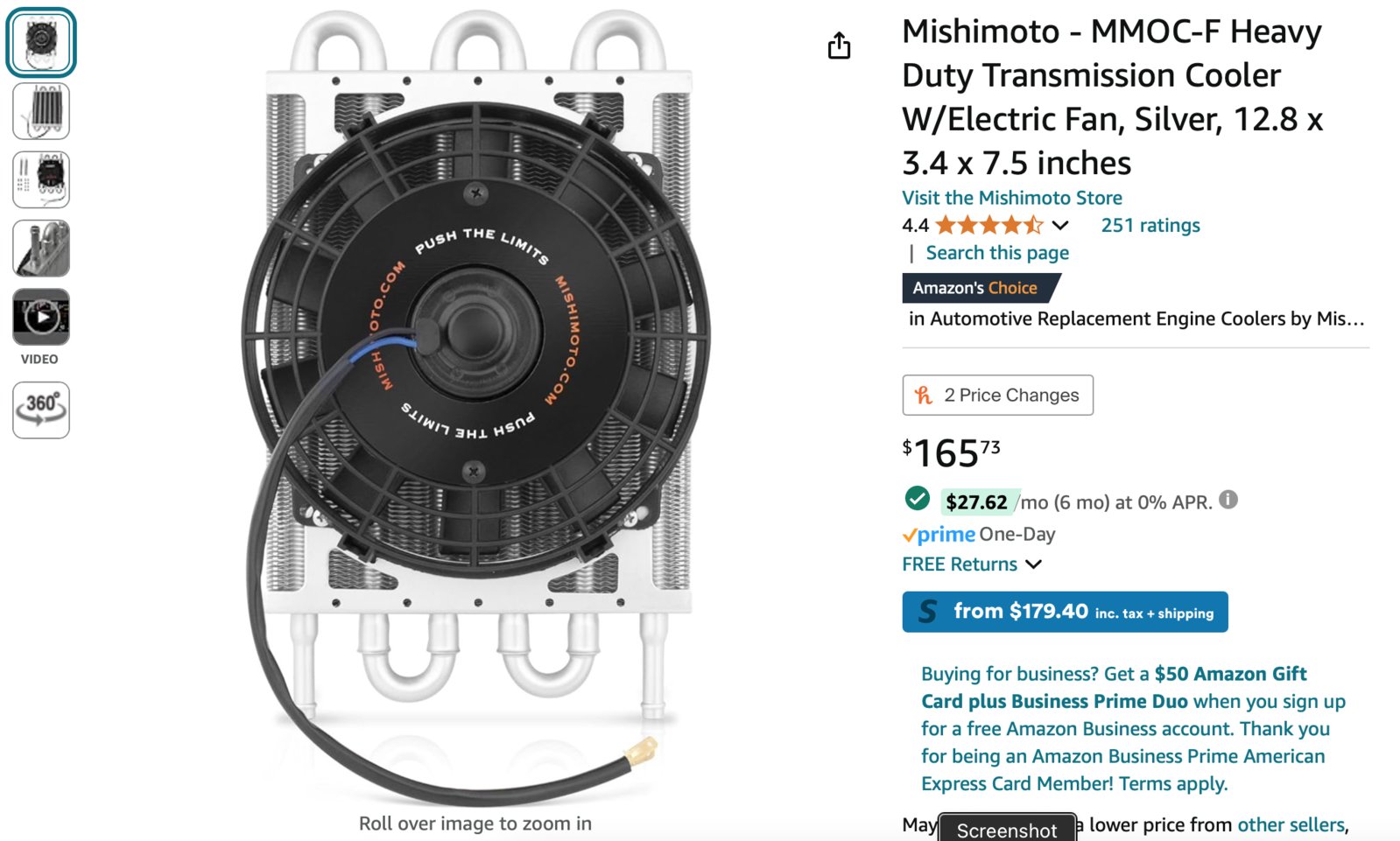

    The Mishimoto with a fan. Linky --https://amzn.to/3xOQcmA
    Mine is zip tied too.
    I'm running the one in the link for my tans cooler. Been working great, I could really tell up in the mountains. When I installed the one for the trans I ran a double line lead so the power is already there for a second one. I'll have it done before the Virginia Trip in October. Although, having to remove the bumper again to remove the grill sounds terrible right now.
    I don't have a great pic of it installed. This one is a screenshot form one of my vids.
