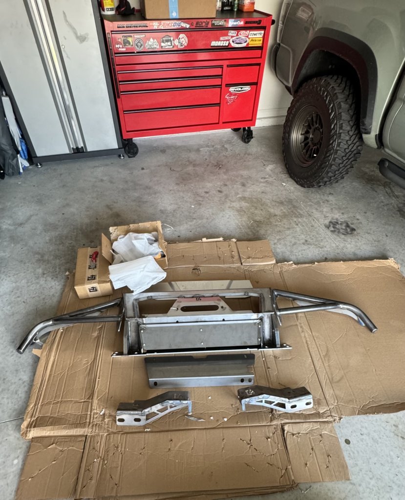

    Bumper arrived but shipping never listed the actual bumper so I didn't know I was receiving it :D Now Im just waiting on the cross member delete and skid. So Im thinking on painting with steel-it how many cans should I buy to get at least 3 good coats in everything, or any advice for painting it?
    btw, ordered frame supports and didn't read that the bumper included them so I have a set of C4 support brackets if anyone interested.

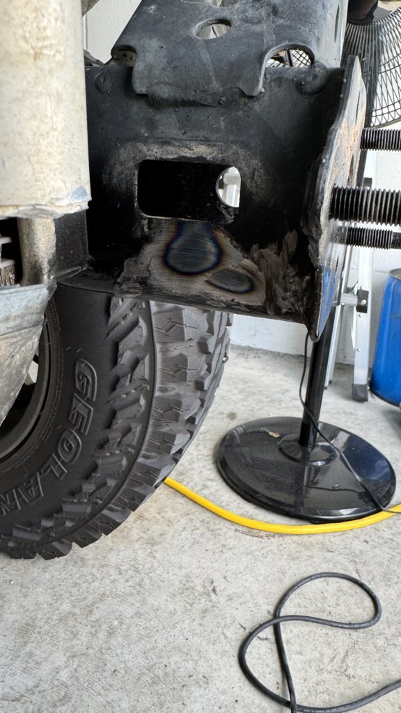

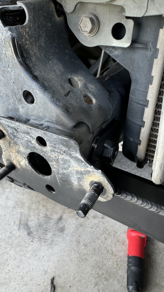

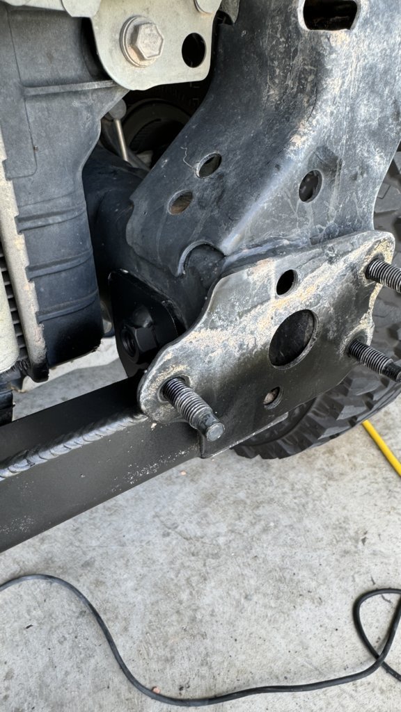

    Has anyone had issues fitting the cross member? I cut the oem cross member and grind flush to frame rail as instructed. When I try to fit the cross member it wont fit in between the frame rails.
  12. Sep 21, 2024 at 7:52 AM
    #332
    JeancoLunarTaco
    JeancoLunarTaco Well-Known Member
    May 6, 2022
    #396602
    64
    FL
    22' Tacoma TRD-OR
    - Eibach Stage 2 Suspension (Front/Rear) 2.75" Lift - JBA UCA - SSW Dakar 17x9 -25 Wheels - Rays 57DR-X 17x8.5 et0 - Yokohama Geolandar 285/75 R17 Tires - CMC / Pinch Weld Mod - Prinsu Rack - Caliraised Light Bar - BajaDesign Fogs, Spots, Chase lights - Auxbeam 8Gang Switch Panel - C4 RR Front Bumper / CrossMember Delete - C4 HC Skid Plate - Badlands Apex Winch - Rock Sliders - R4T LCA Skid - OTT Tune (Spicy/Race) - Carven Custom Turndown Muffler - ECGS Needle Bearing - OEM / TRD-Pro / V2 Pro Grills - Custom Clear Tail Lights
    It wont fit no matter what, Im already cutting into the frame rail. Was it supposed to be that tight to fit?
    Update:
    After hours of scratching my head, I went and bought a hydraulic body frame repair kit from HF and pushed frame rails until cross member fitted with washers and everything lined up. So anyone with tight issues go straight to buy/use a frame kit.
    Also, Badlands winch wont fit unless the whole center bar (plastic grill support and metal brace) are cut.

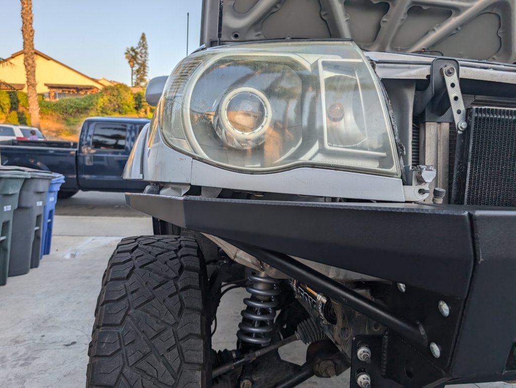

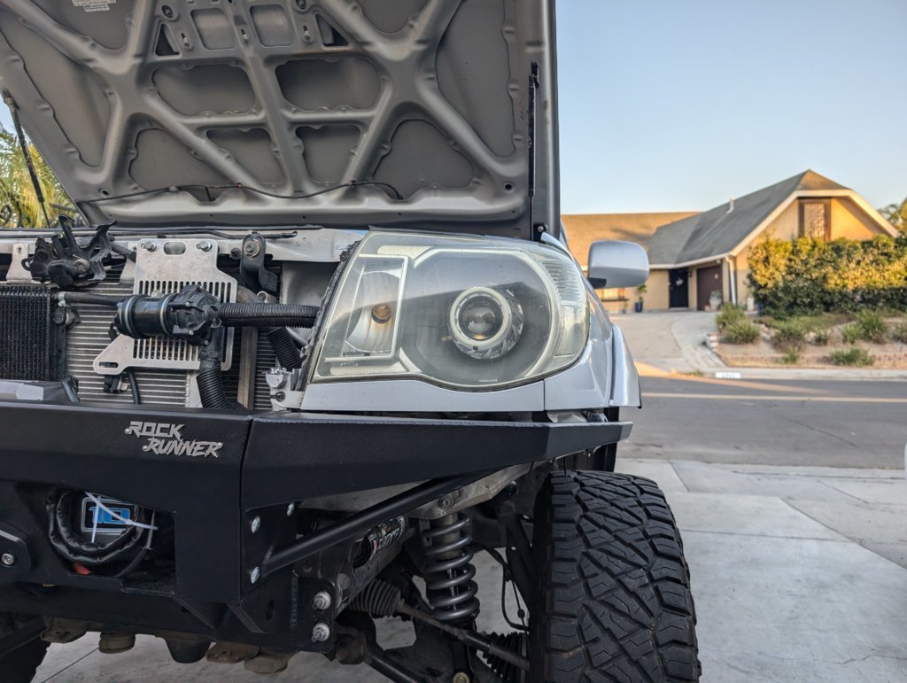

    Lol what a pain in the ass. They really didn't proof the 2nd gen model a lot of things got overlooked.
    Also look at those gaps! What in the QC??!

    TacoTuesday603 I welded it helded
    May 3, 2021
    #364592
    3,364
    Jack
    New Hampshire
    2011 OR DCFB
    Fox and Locked suspension 63's Skinny 33's
    Sad to say it that part of the body angles up slightly its not the bumper being assembled wrong, I built this and measured multiple times and wondered why that gap didnt look right.
    My solution for the next ones is to bring the main tube in front of that body line to hide it.
    FishingInSand[QUOTED] likes this.

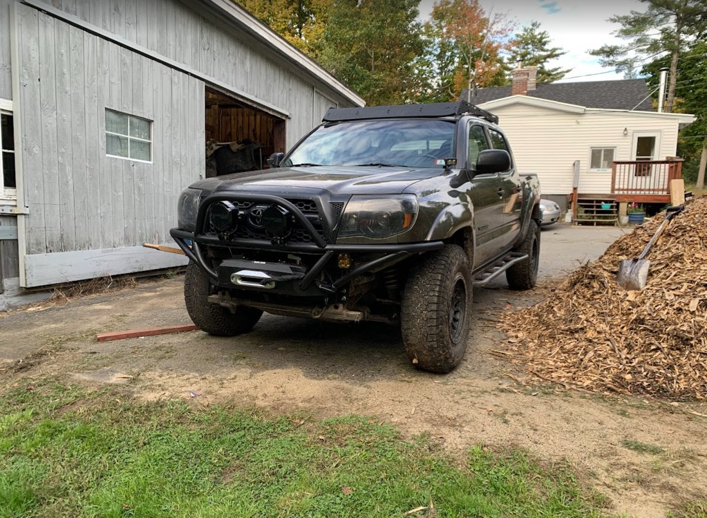

  17. Oct 1, 2024 at 11:08 AM
    #337
    FishingInSand
    FishingInSand Well-Known Member
    Nov 28, 2016
    #203531
    1,094
    Corey
    Temecula
    06 now with 4x4
    Some stuff here and there
    The bumper on their website is pretty darn level straight across
  18. Oct 1, 2024 at 11:11 AM
    #338
    TacoTuesday603
    May 3, 2021
    #364592
    3,364
    Jack
    New Hampshire
    2011 OR DCFB
    Is it though? Yours does seem to be worse than mine or this one though. Not sure why

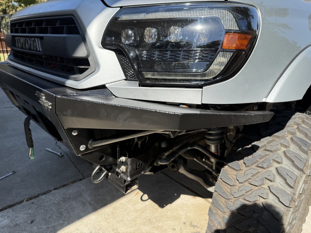

  19. Oct 1, 2024 at 7:49 PM
    #339
    JeancoLunarTaco
    May 6, 2022
    #396602
    64
    FL
    22' Tacoma TRD-OR
    Update:
    Installed the bumper/cross delete and its fucking awesome! Also managed to fit the Badlands winch with no mayor cutting and without relocating the control box.
    My bumper cuts were a bit crappy but I think its not that bad :anonymous: Anyhow, the work and sweat was totally worth it. Will be editing and posting a brief install video in YT :thumbsup:
