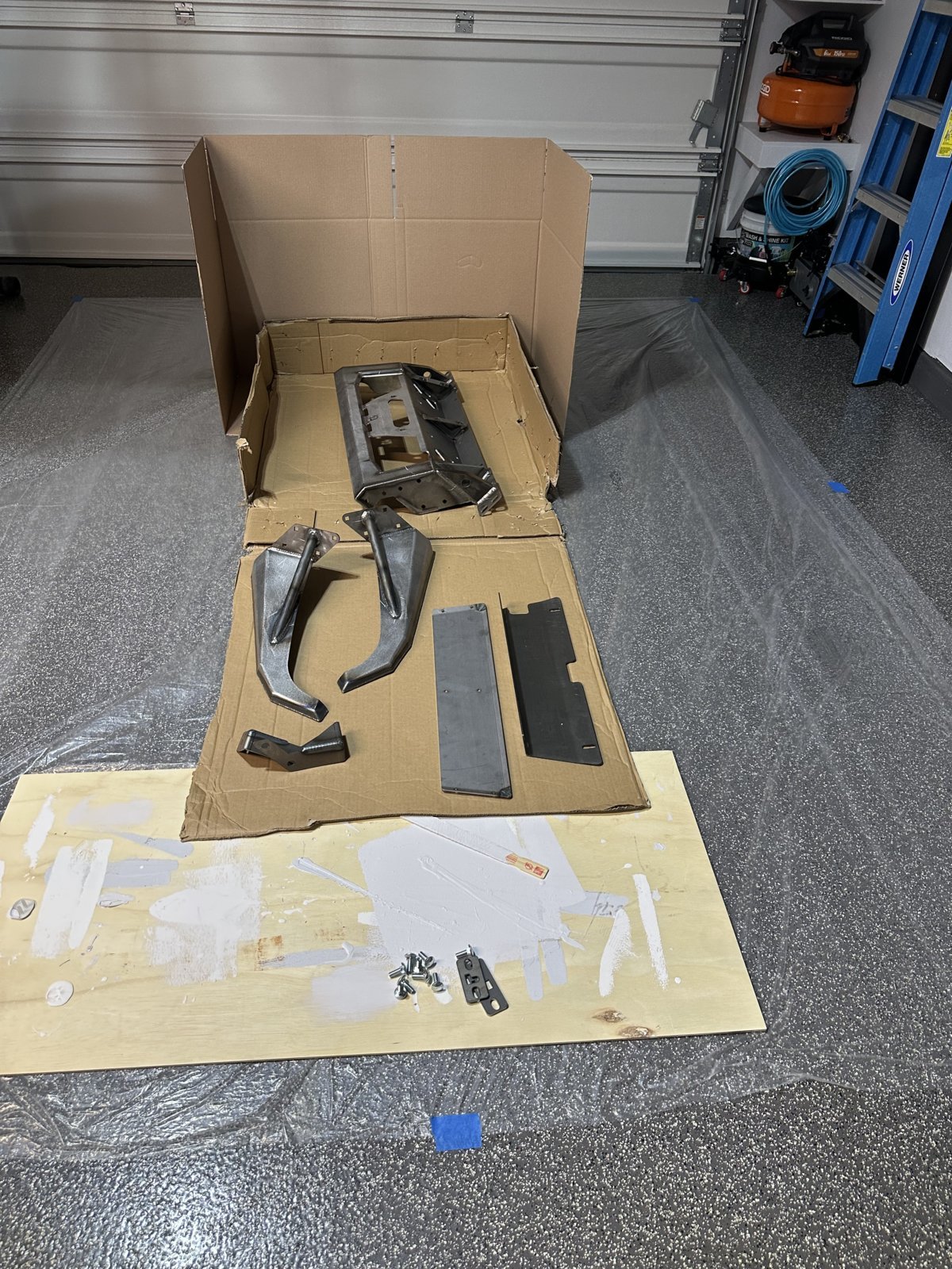

    Got the paint booth ready :anonymous:

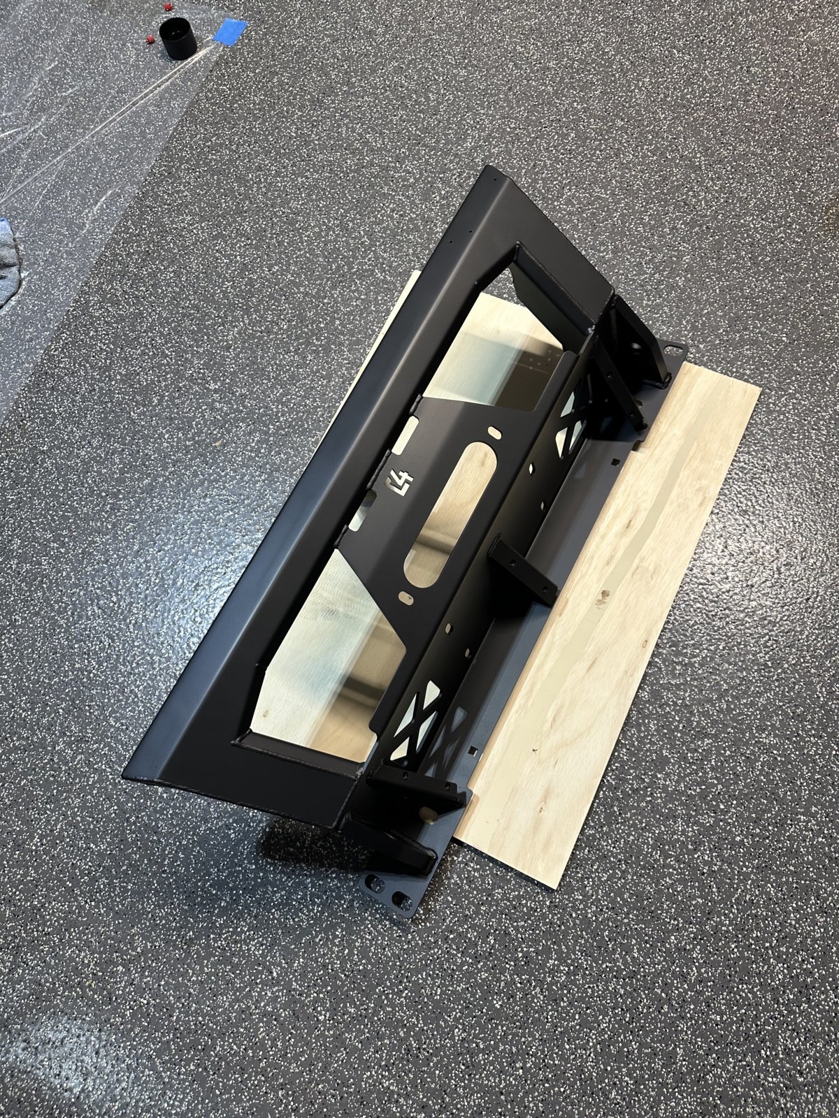

    This is the third bumper I paint it with
    You won’t regret it
    Btw. Count your hardware once you get it. I’m x1 wing carriage bolt short

    Prep is not bad, I do brake cleaner to clean parts right out of the box, scouring pad, another coat of brake cleaner to clean dust, heat gun to get the parts warm (if it was summer just a sun bath lol) then paint.
    Two cans but only took one & half

    Can’t beat that finish for < $100 :D

    Looks great! Way better than I would have expected from a rattle can. Was going to powder coat, but I think I'll be doing all my new armor like this.

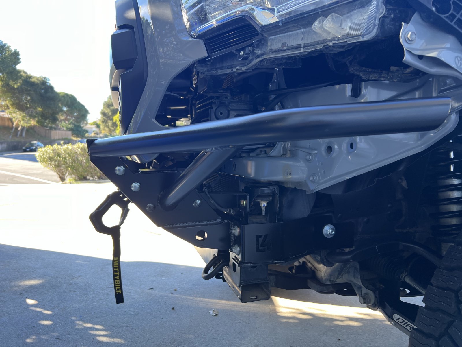

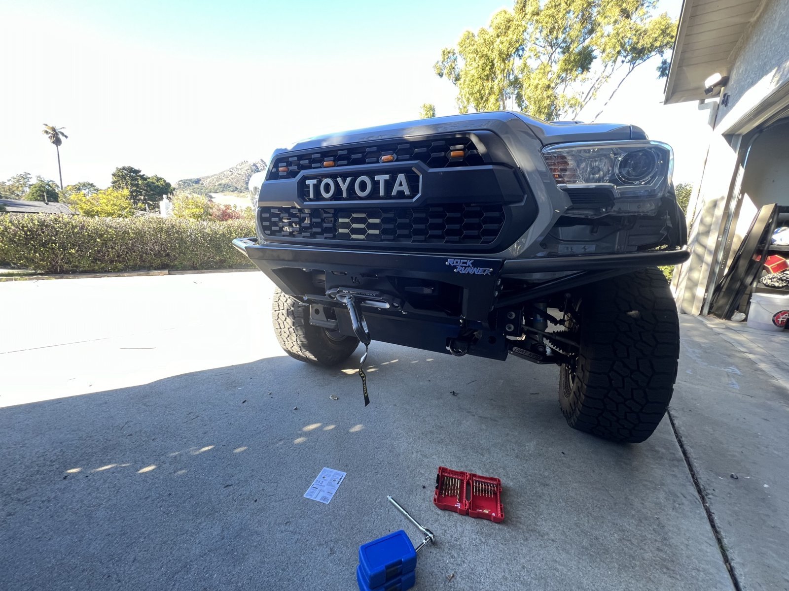

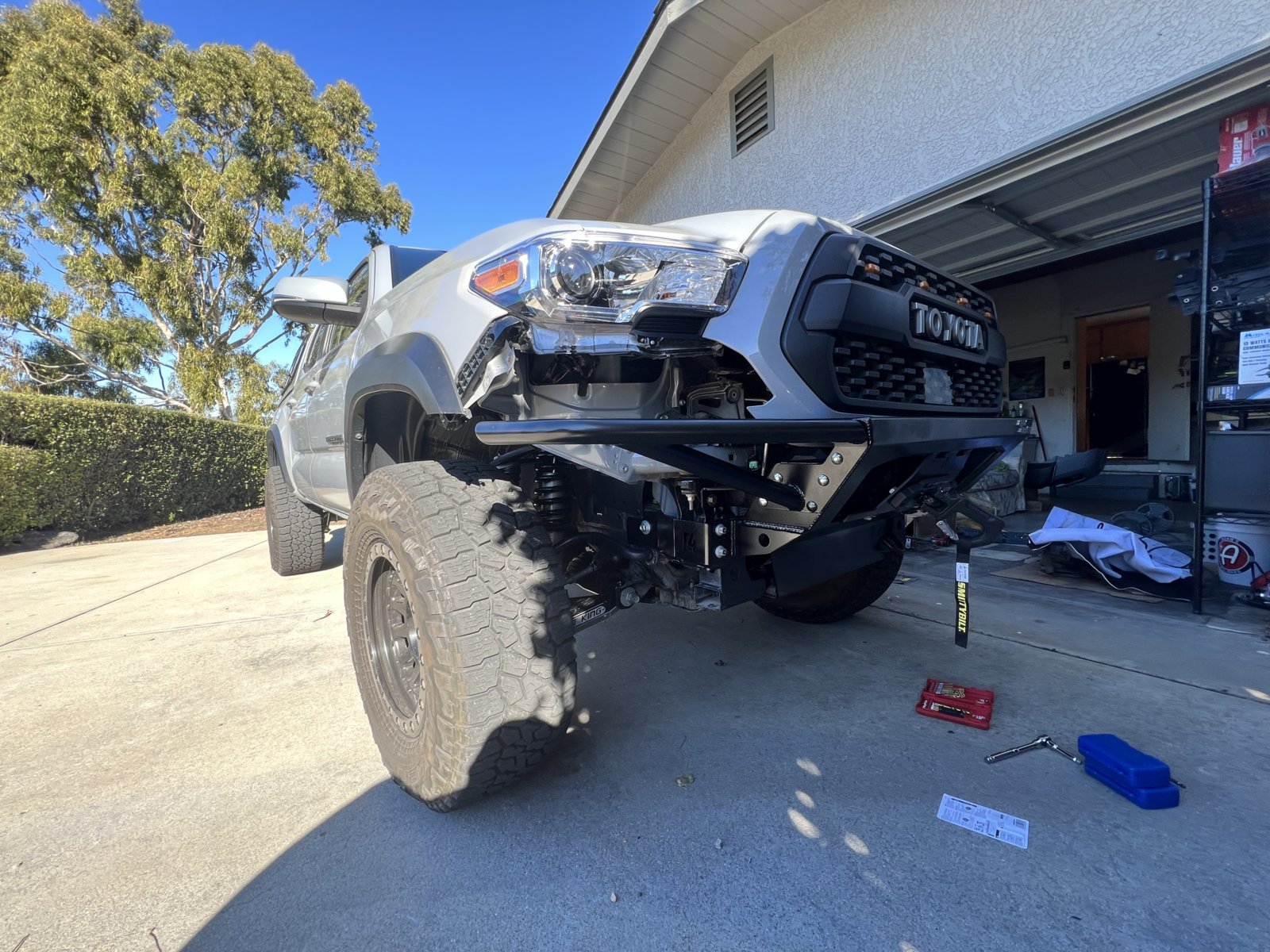

    Have had it on for a few days now but need to make some adjustments since it’s settled into place fully. Gotta push the winch back a little and move the driver side up so that it’s level.
