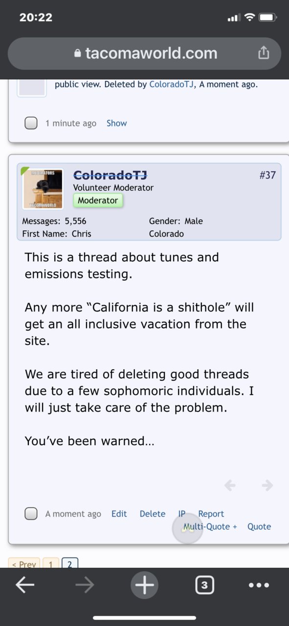

    This is a thread about tunes and emissions testing.
    Any more “California is a shithole” will get an all inclusive vacation from the site.
    We are tired of deleting good threads due to a few sophomoric individuals. I will just take care of the problem.
    You’ve been warned…
