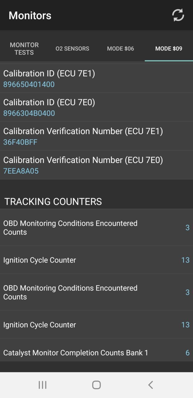

    I did flash and CVN for ECU changed.
    TCU CVN remainded the same

    KDMax pro 9.0
    What was the cvn number before you flashed ( stock ) I wonder
