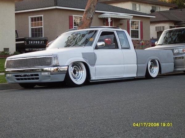

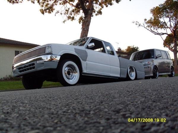

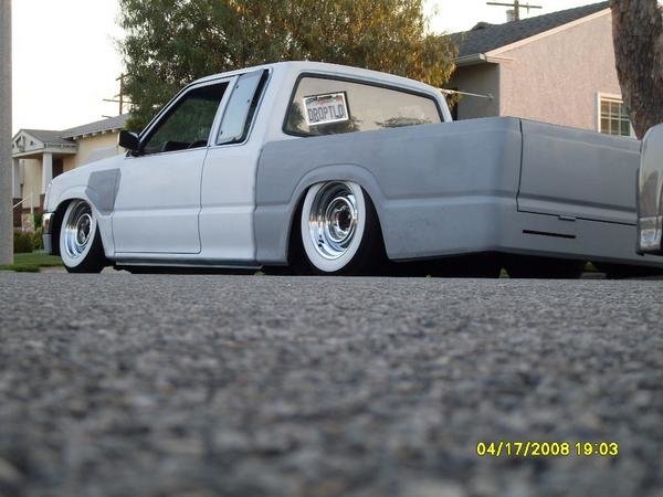

    I had a 1987 Mazda B2000 on hydro's. The door handles, cowl, and gas cap door where shaved. I relocated the filler neck and cap inside the bed and never had an issue with it. Now, this was almost 15 years ago, so things may have changed. You can't see it in the photo but the gas cap was mounted in the left corner of the bed, by the cab.

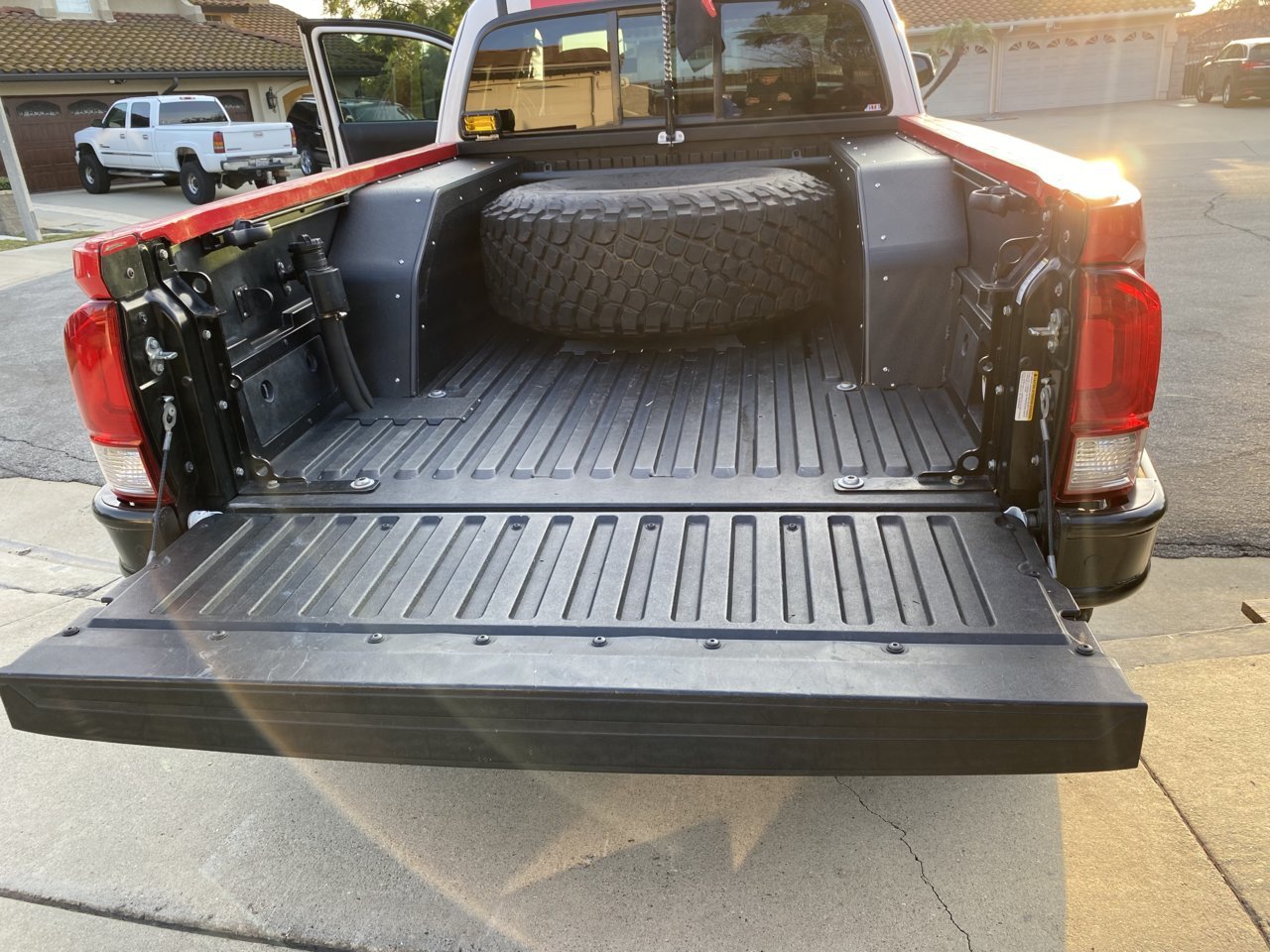

    No but you will need to retain stock gas cap and all stock filler neck. See how mine is inside the bed now. It’s plumed exactly like stock I’m not breaking any laws it’s all there…. 6FE3645D-D6EB-41A0-8368-F195809AC1C1.jpg

    wow that setup is so clean! thank you for the info
