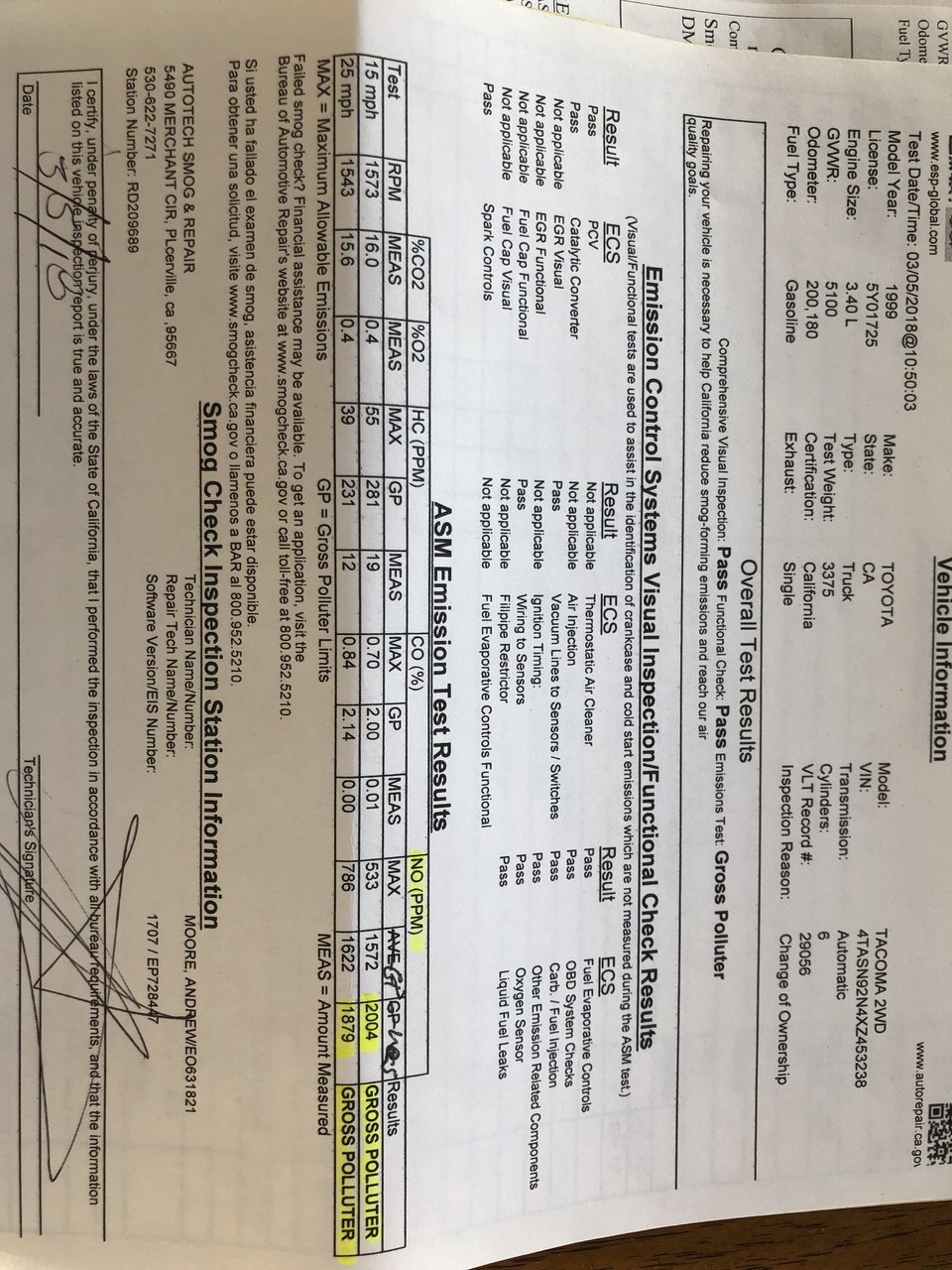

    Hello and thanks in advance for any help. I just bought a 99 tacoma PreRunner trd with a v6. Truck just turned over 200k and I just tried to smog it today and it came back as a gross polluter.I am confused as the truck just passed four months prior to this test. My question is what could have happened in such a short amount of time for it to become a gross polluter. When I got it I ran sea foam through the induction system because I noticed on the last test the hc only passed by one point and I wanted to be sure it would pass again. I don’t know what the conditions were when the first test was done but it seems the sea foam did help with hydro carbon but I am wondering if it may have clogged up my cat? Any input on my situation would be greatly appreciated.

    I know little about smog testing. I do know seafoam shouldn’t effect the results. Tens of thousands of people in Ca. use it all the time with no smog problems. Hopefully someone who works with smog testing will chime in. I think one of those 2 results is incorrect. I’d take it back to the first place and show them both results and have them retest. If it did suddenly change to a gross polluter then my best guess would be that there is some catastrophic failure of the catalytic converter. Talk to a mechanic and see if he can shed any light on this. I’m anxious to hear what others say.

    I showed the smog tech the previous results and he was suprised as well but didn’t have much to say. He ran some pos Geo tracker before mine so I hope he didn’t mix them up some how. I just didn’t think a cat would suddenly fail like that. If it did I probably have other problems on my hands.

    I had this issue (not on a Taco). It was a bad cat and a vacuum leak.
    I'm sure on a taco you'd throw a code with a vacuum leak...
    So I second a bad cat.

    Would it not throw a code from having a bad cat? I noticed the 02 was in front of the cat so maybe the truck doesn’t regulate the cat being that it’s an older model? Also would the cat go from good to terrible in that short of time?

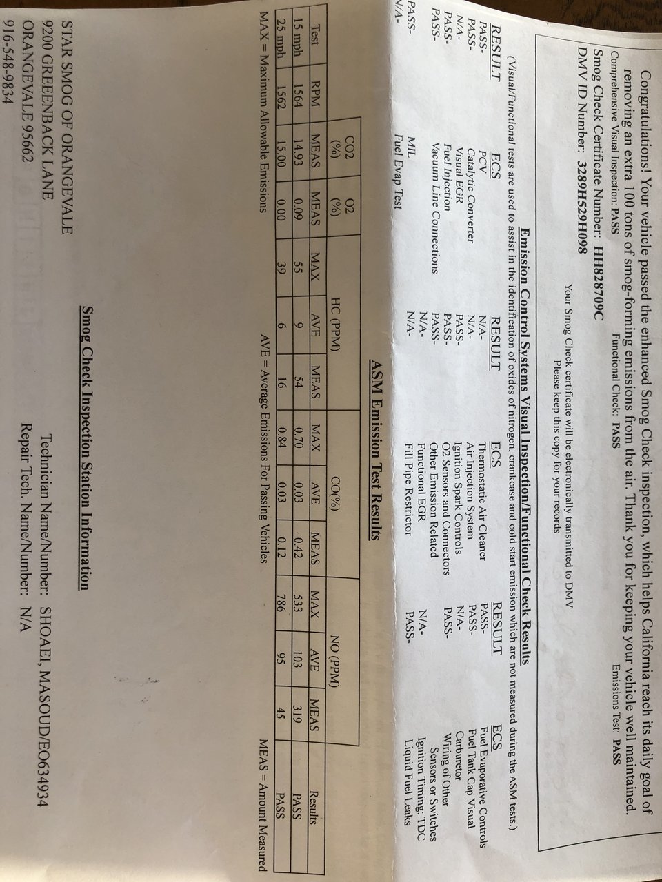

    So on my second try I ended up passing and with pretty low emissions. I ended up replacing the upstream 02, fuel filter, air filter, pcv valve, changed the oil, and ran sea foam through the tank. I’m sure the biggest culprit was the 02 but I’m sure the other things could have helped slightly. ThAnks to everyone who chimed in and helped.
