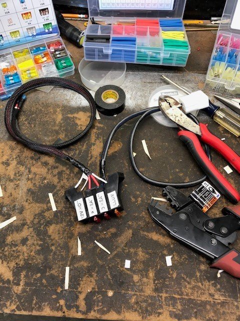

    Another option is to grab power from the trailer brake controller plug if you don't plan to add one. I got a pigtail meant to hook up the controller and hooked it to a mini fuse panel to power my heated seats.
