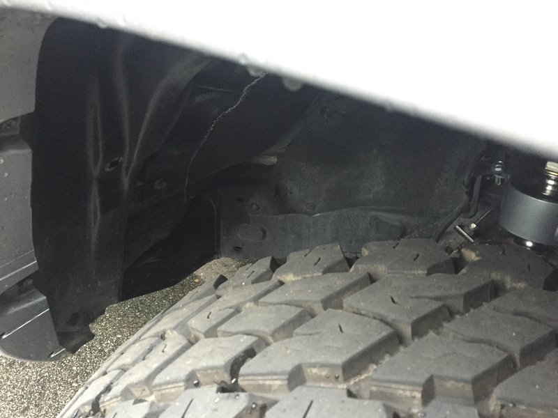

    I recently cut the cab mounts on my 2014.
    My brother welds for a living so i asked him if he had time to throw some plates on there and he hooked me up. I asked him to throw some wet rags or something up in there because i had always heard of the bushings catching fire if your weren't careful.
    Long story short ive been noticing some creaking going over bumps in the front end area. Was trying to think of when it started happening and disregarded cmc for obvious reasons but had realization that since it started nearly the same time that possibly the bushings had been heated up too much. I was working when it was being done and im pretty sure he disregarded my dumb neuroticism about the wet rags.
    Anybody experienced this or heard of bushings squeaking after cmc by chance?
    Or like the 10 other squeaks, clunks and noises from steering rack and other areas is this just another tacoma noise I should try to forget about. Ty
