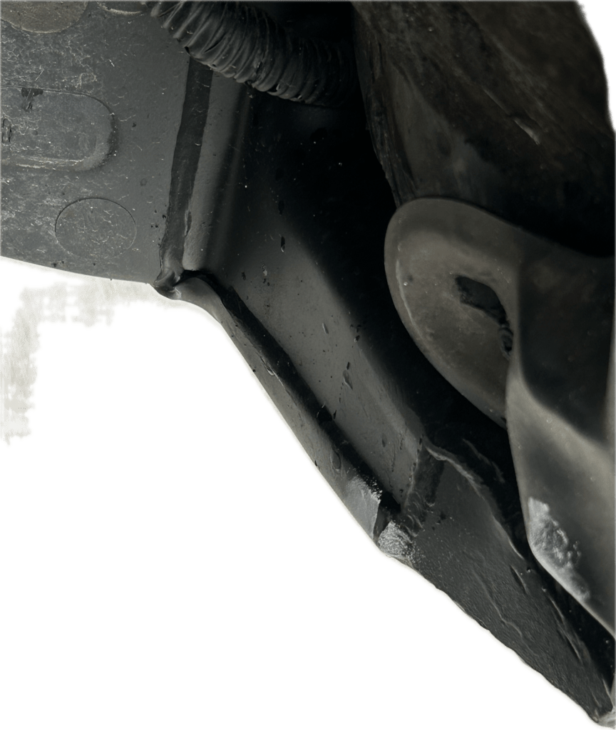

    I still rub a little with this cab mount chop (chalk tested) you see it towards the edge of the chopped part. Is this normal? At least for this much of a chop? lol
    It happens on full lock.

    What caster are you running?
  3. Feb 5, 2025 at 10:50 AM

    Not sure of the exact number but it is positive caster due to my aftermarket ball joint UCAs. 285/70r17 0 offset

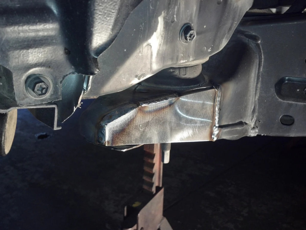

    It's honestly not enough of a cab mount chop, that's the issue. Not my picture, but typically guys go 3.5in out from the frame, it looks like your chop is half the length of a normal one (and how much I cut).

    The chalk test indicates that I only rub on full lock in reverse. I will probably keep it like this til I get more funds to do another bigger chop. lol if I go off roading it would only be on fire roads which will be in moderate to a lil bit of high speed runs (no sharp/full lock turns)

    That's pretty typical for when you'd rub, it simulates an off-road articulation as much as one could on the street. it really won't hurt all that much, but it needs more chop to not rub, that's all

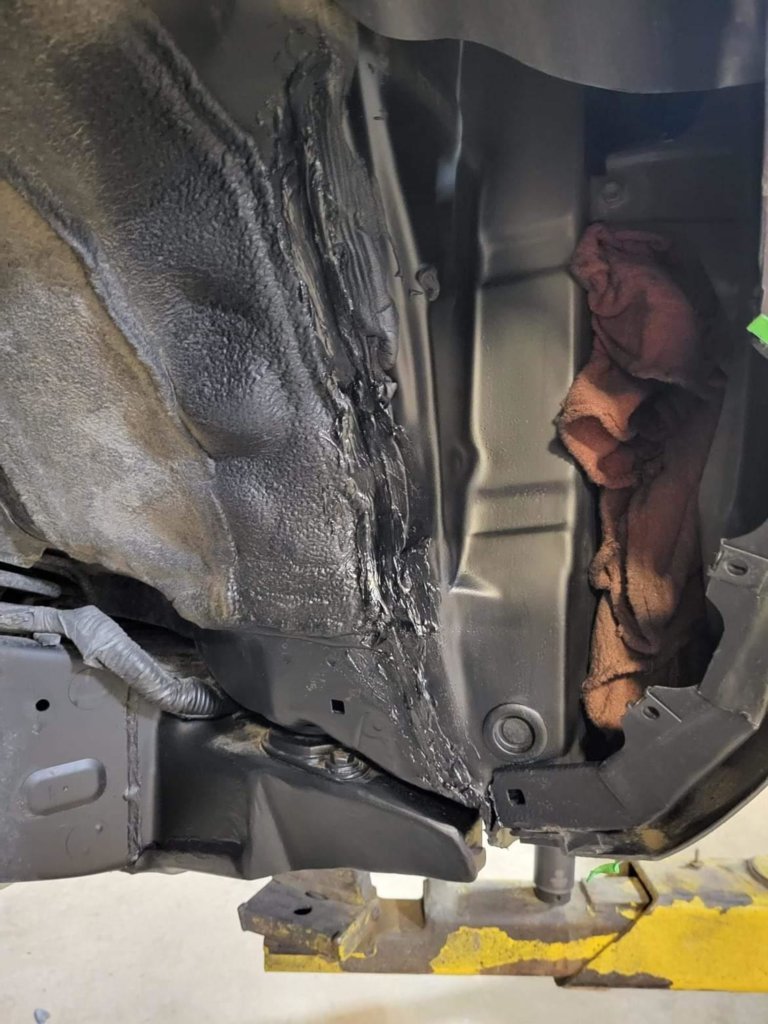

    That has to be one of thr most mild cmc's iv ever seen. It's not cut back far enough at all.
    This was clearenced for more tire and offset but that's what i would expect out of anyone offering a chop. Make some real space. Hope you didn't pay much for that.
    As others have stated get a high caster alignment. It's possible to clear that set up most of the time without a chop.

    Bro! They treated my cab mount as if it was a plastic trim. They pretty much nibbled on it. It clears but I doubt it would clear an aggressive angle/articulation. I’ll probably stick with the cmc but more aggressive cut.

    Update: I did another chalk test attempt and I noticed that the marking on my first attempt was a water drip mark. lol I don’t rub at all but it’s pretty close for comfort. I will chop some more in the future tho. Thanks for all the feedback guys! I might end up going for the relocate kit once my truck is paid off and go 35’s.

    You have a very mild CMC, trimming farther in toward the frame(with a longer cap plate, ours are 6" for example) and farther back toward the firewall/body mount bushing will be enough to clear 33s easily and even 35's. I've even fit 37s with firewall tubbing and a more aggressive CMC, no cab mount relocation kit needed. In fact, the cab mount is an integral safety item designed into the frame to prevent tire intrusion into the floor of the cab, a full cab mount relocation defeats that design so thats something to keep in mind.
