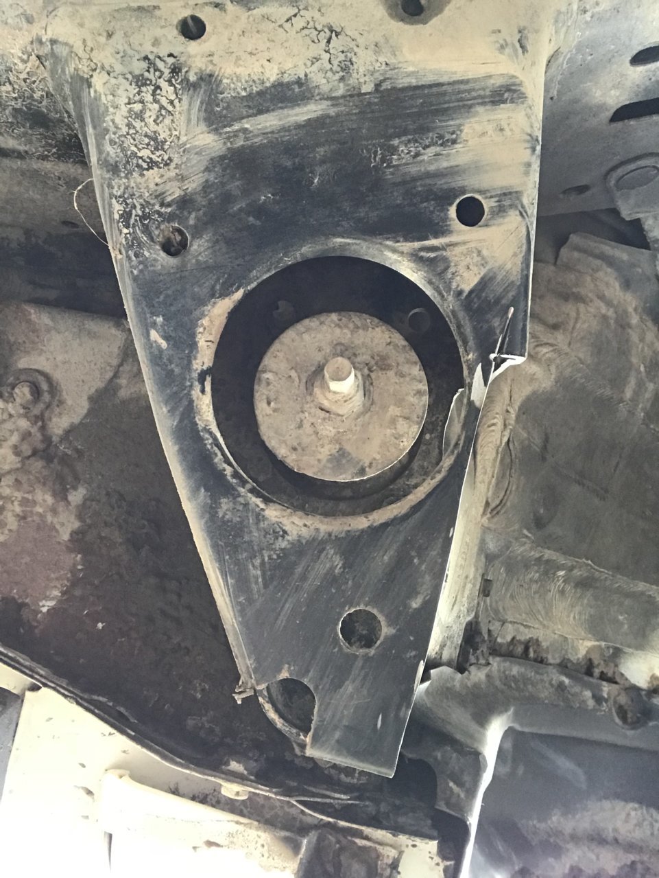

    When you cut for a cmc, you cut at an angle. At the outer edge where the most is taken off, it’s only maybe 1.5” at most and tapers inward from there.
    I think any negative effect would be negligible at best.

    The 3rd Gen cab mount is larger then the 2nd gen as well and guys have been chopping 2nd gens for over a decade.

    While I somewhat agree, if you look at the front edge of that big hole for the resilient mount, there isn’t really that much meat there to resist front-to-back deflection. Looks like it would tear apart. For sure the cab-mount has been weakened by the change, but by how much? Who knows?
