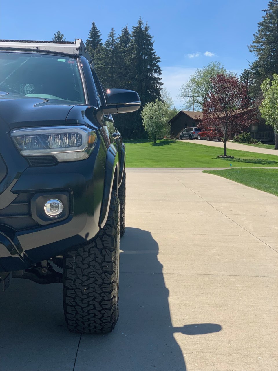

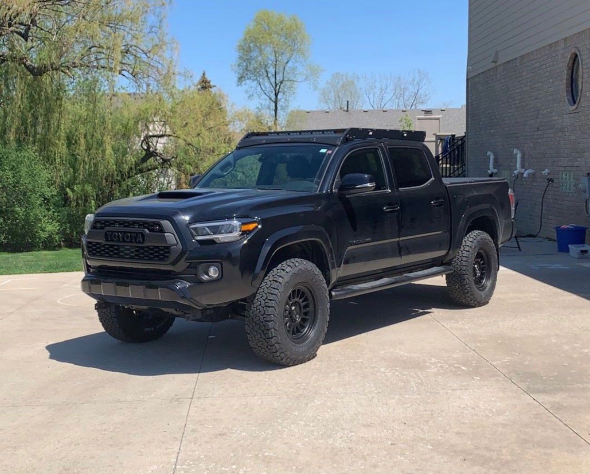

    Well, here I am. 285/70/17 with 0 offset...

  14. May 13, 2022 at 12:51 PM
    Out2gtcha
    Out2gtcha Well-Known Member
    Aug 24, 2021
    #375171
    1,192
    Brian
    Omaha, NE
    2020 Quicksand Off Road DCLB 4x4
    Is that the 3" lift you mentioned?

  15. May 13, 2022 at 12:53 PM
    Hockey71
    Hockey71 [OP] Well-Known Member
    Nov 27, 2021
    #383173
    97
    Jacob
    Hockeytown, Detroit, Michigan
    2021 TRD Sport
    Yes, Icon stage 3 adjusted to about 3 inches.

  17. May 13, 2022 at 12:54 PM
    #17
    JayRolla
    JayRolla Well-Known Member
    Mar 30, 2017
    #214833
    2,887
    Jason
    Colorado Springs
    Wife's 2012 DCSB Tacoma Sr5
    Trd stickers for 10whp 32s on MK6 17s
    You won't need it if you run SPC UCAs. Set the SPC ball joint too G setting. Max the LCAs completely pushing tires all the way forward. Then correct the camber eyeballing it as much as possible with the SPC camber adjustment and TQ ball joint to 220ftlbs. Then have an alignment shop fine tune. Will have multiple inches of clearance at the cab mount.

  20. May 13, 2022 at 12:57 PM
    #20
    Hockey71
    Nov 27, 2021
    #383173
    97
    Jacob
    2021 TRD Sport
    surprisingly my installer said he had to cut some plastic in the front wheel well, which I did not think was necessary with the lift, but I guess it was minimal cutting for a bit of rub.
