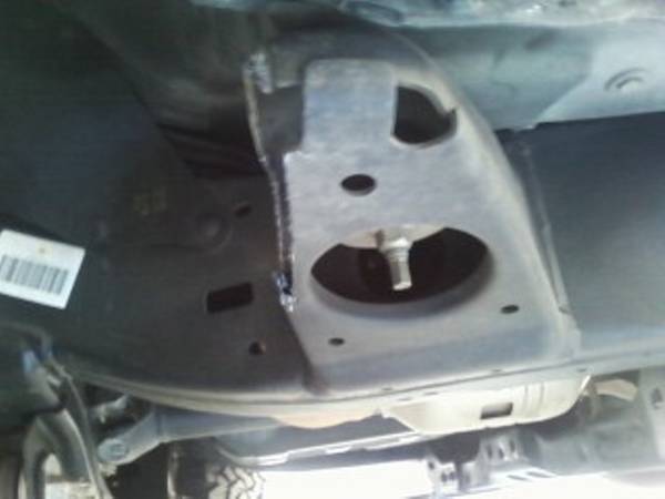

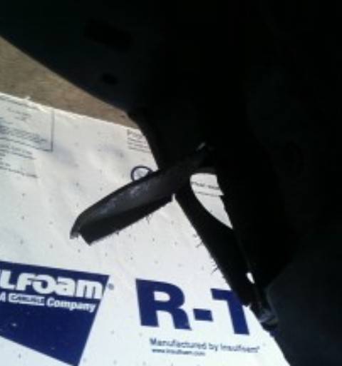

    Here are a few crappy phone pics of my progress that might help others. . i didnt cut it all the way back to the frame since the wheel only rubbed in the spot closer to the outside edge.
    First used a cut off wheel cuz i couldnt find the plasma at work for a while , then cut the top with the plasma and folded it back and off.
    View from bottom: i haven't welded the plate on it yet i was ready for dinner so i left that for another day :D
