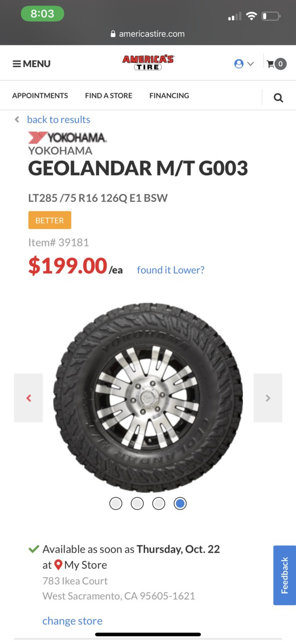

    Will the cab mount chop accommodate a set of 285-75-R16s? Anyone have an opinion on these tires?

    I think the answer to your first question is yes. And the answer to your second is no. I think you can fit a 33 in the spare area with some slight modification.
    Also, I like that you're on the phone and looking at tires :rofl:
    "Yeah, yeah, that's fine, oh look, 285 geolanders"
