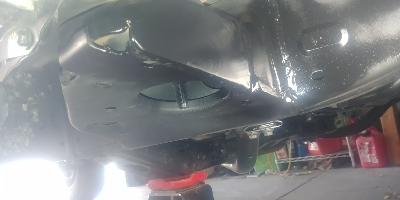

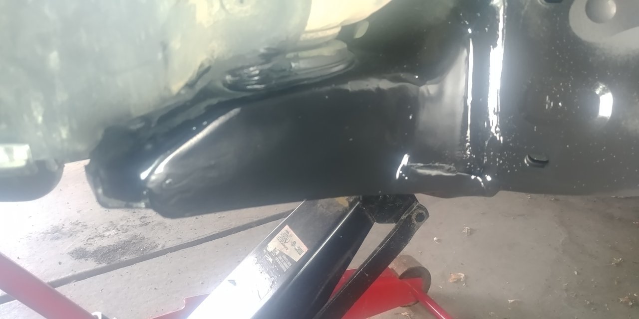

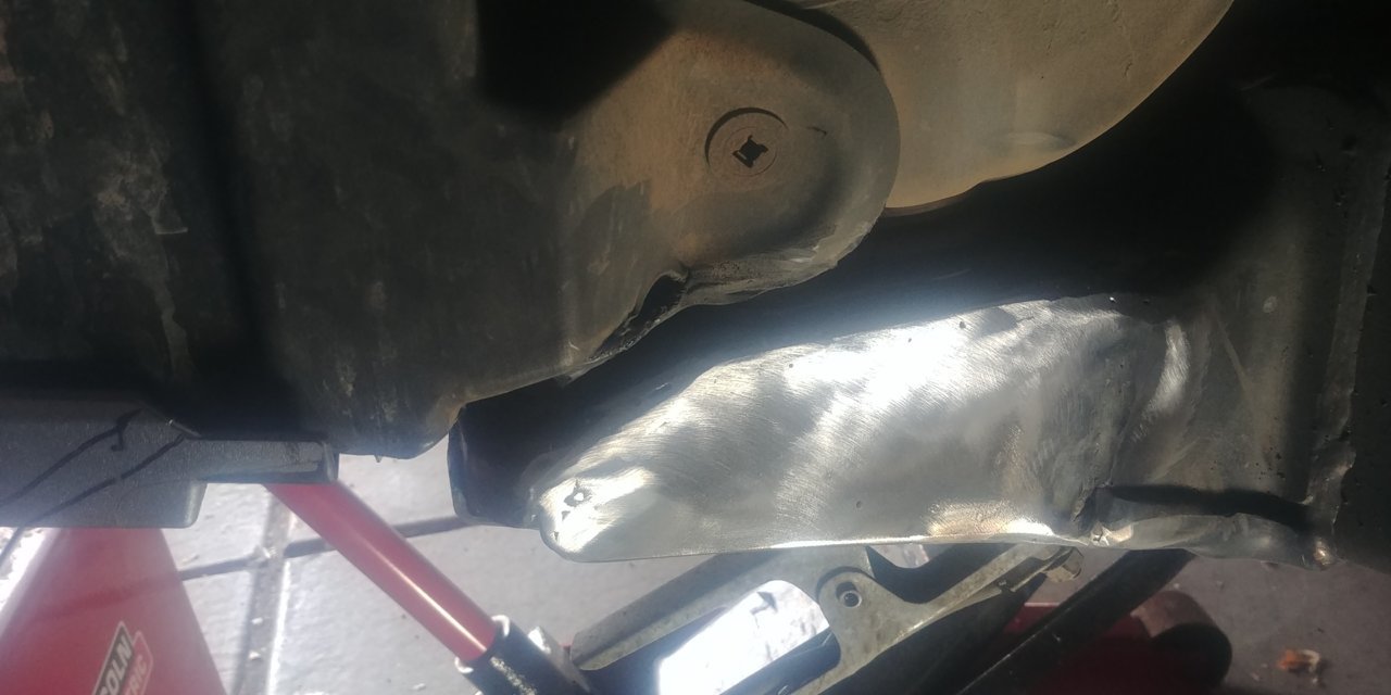

    So I just did a cmc to my 2016 Tacoma , and it turned out pretty good. I think I only removed about a half inch though.

    Should have went to the red line

    I probably should have. That is a lot of chopping.

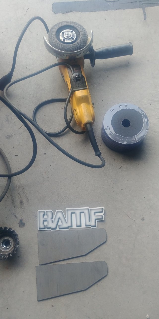

    That’s where I chop them to. I make my own plates though

    Well I am only running 265 70 17. I didn't need a whole lot chopped. The money I would have spent for the metal and then the time to cut the plates. ( no plasma cutter) just made sense to buy them.

    :thumbsup: It was either buy leaf springs and lift the truck higher or spend 30 bucks and chop it. I like where my truck sits and didn't want to lift it any higher.

    I was rubbing on sharp turns when my shocks compressed slightly. Yes I do have my camber back at 2.5 , I didn't want to spend 80 bucks to have them move it up to 3.5 or something and they still rubbed.

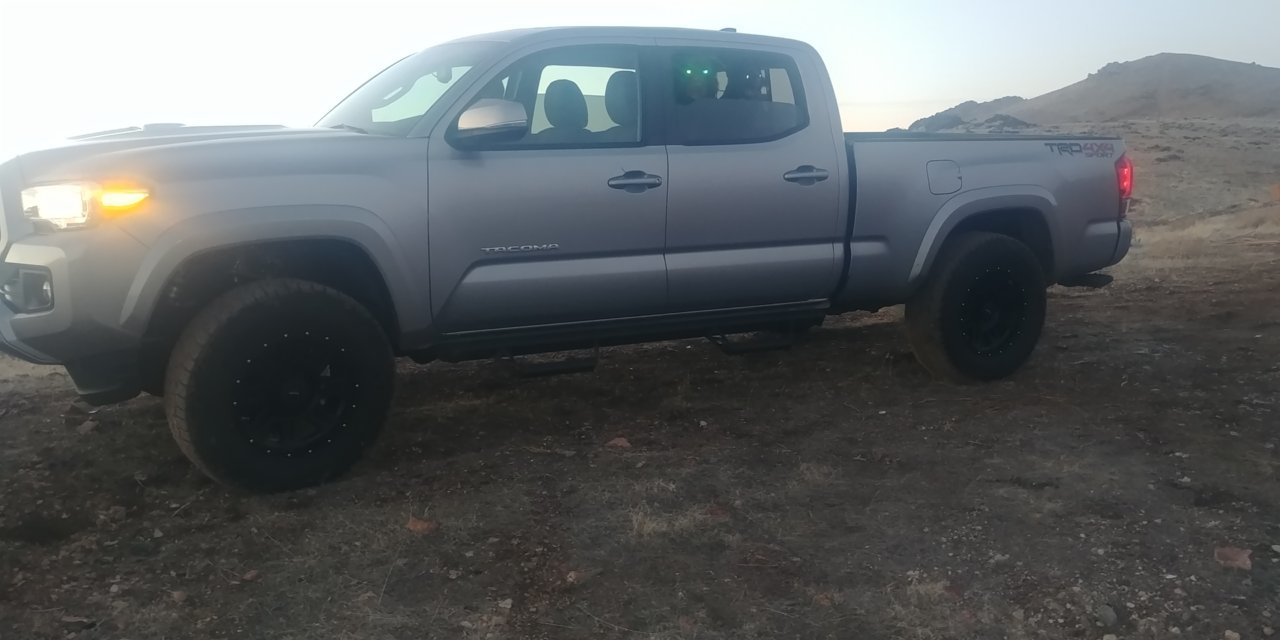

    I have Pro comp 05 series rims. 4.5 backspacing 0 offset. Running Falken Wildpeak AT tires. I have Icon 2.5 front coilovers with about a 2 inch lift. Also have Icon UCA's. Just took it off road and absolutely no rubbing.

    I don't know what to tell you guys, but I was rubbing. Got tired of hearing it when I back out of my driveway or turning into parking lots. So I went with the CMC.

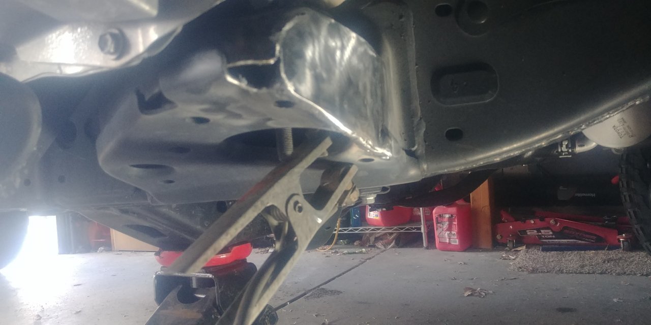

    no worries man, its all good. the chop looks clean, so you should be ok now. ride on.
