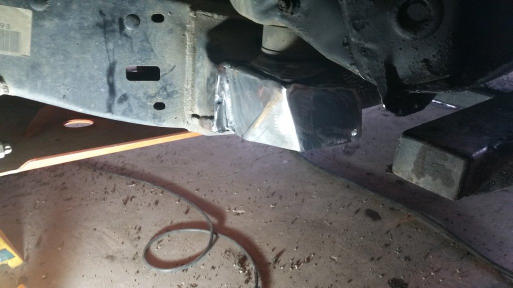

    Heres my CMC. I got the plates from Relentless fab for $18, cut out the shape of the plate and then weld in the plate.

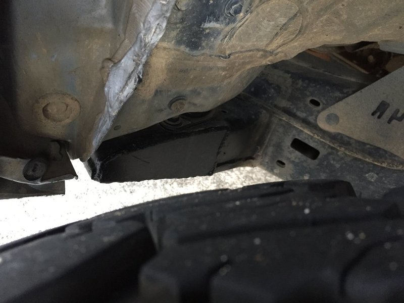

    Another example, with pinch weld pounded flat under fender liner. Fender & Flare also cut up on lower section.

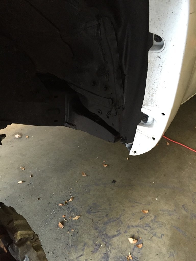

    Cab mount chop time!
    And done! Thanks @Speed Freek for the quality work!

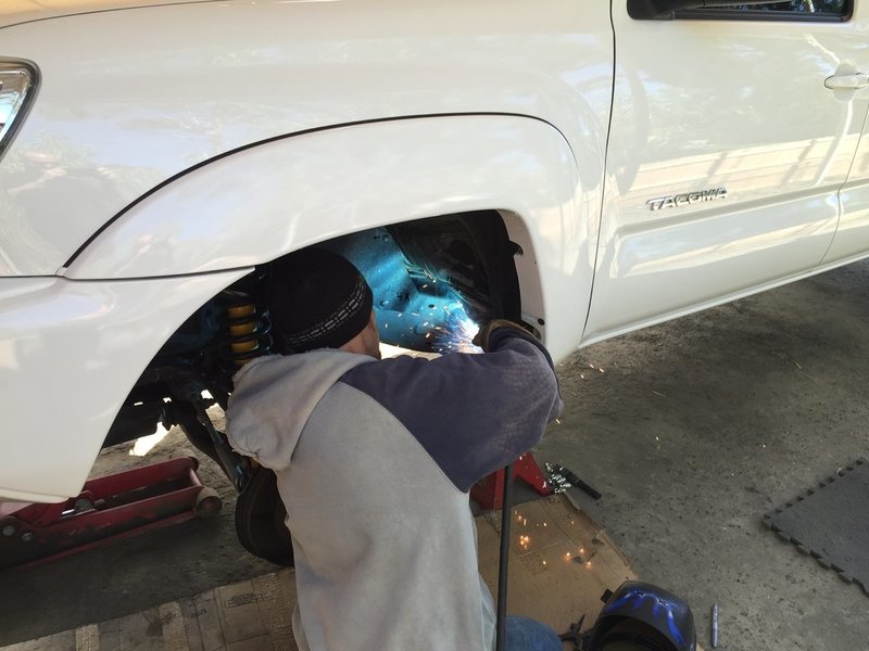

    I hope that I took enough off, haha.

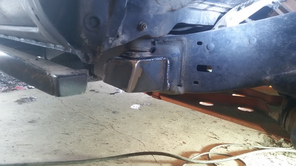

    Had some cab mount chopping done today as well
