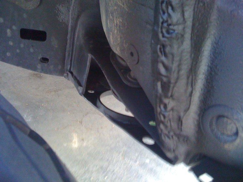

    Cut my cab mounts today. I think it turned out pretty good.

    You might want to cut a little more at the ends , round off the edges. When I get a chance I will try to get pics.

    I was thinkin about taking more off but I only wanted to take as much off as necessary. When I take it offroad I'll find out if I need to take more off. I also didn't want to compromise the integrety by taking off too much.

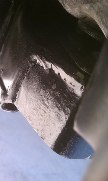

    This is cab body mount chop and plate job that Demello did for me this past Friday.

    Definitley looks pretty. I was going to cut more towards the outside portion but in looked to be a pain in the ass and didn't look necessary. If I ever rub there, I'll just take the grinder to it again.
    It looks like they removed the bottom portion of the cab mount on yours, but can't really tell from the pic.
