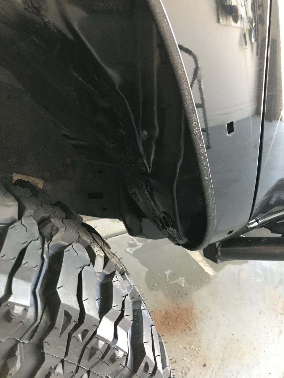

    I recently switched to 35’s. Here is what my wheel wells look like. I have 4.4* & 3.4* positive castor up front, -25 offset wheels and 315/75/16 MT’s which are larger than many other “315’s”.
    I only kiss my already aggressively trimmed CMC when my tire is at full lock and it’s not a bad rub but it is definitely a rub nonetheless. Despite all of the hammering/trimming I have done, the only thing that would eliminate rubbing would be a cab mount relocation.
    I don’t think any “NEAR TRUE 35” would NOT rub without a Cab mount relocation. I don’t see it possible. Maybe if you have some KO2s or other tame all terrain & JUST the right offset of wheel you MIGHT be ok, but I truly believe every single 35” tire would rub at some degree, a non relocated cab mount. I don’t mean on road, i mean in any scenario. At stuff, full lock, etc.
