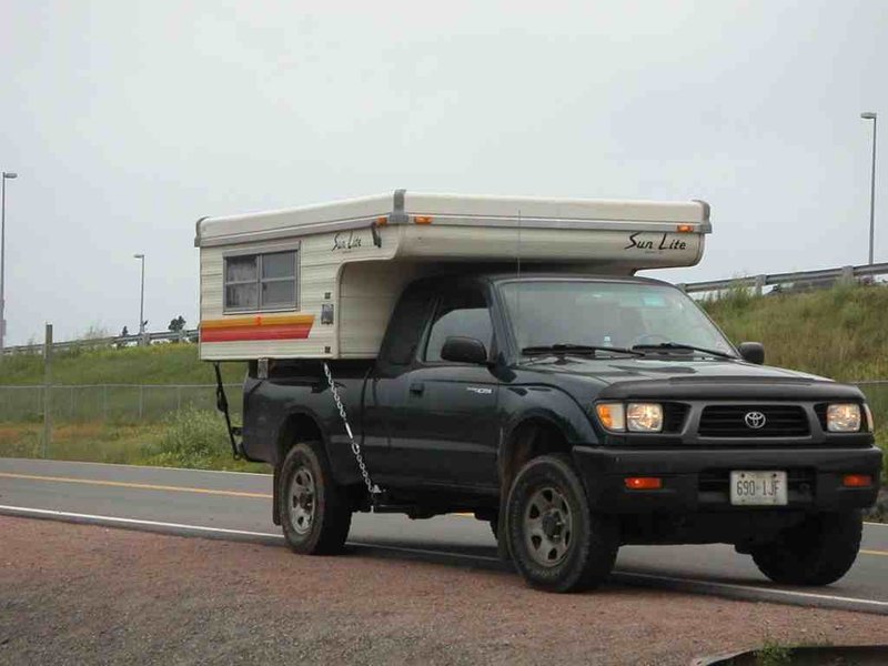

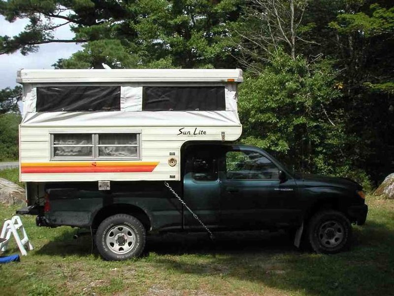

    Here's a couple of pics of mine in my first Taco.
    You will definently need airbags, but they are cheap and easy to install.
    In order for my truck to sit level I had to have the bags at 100 psi (max pressure).
    I liked having the slide in as it was great for quick stops, however I hated the fact that you have very little spot to put things once you stop. All your gear (BBQ's, bikes, boards etc.) has to be pulled out and put somewhere were it will hopefully not get stolen or wet.
    I much prefer having the truck bed and cap to store and lock things and a seperate trailer to sleep in.
    Since you already have this, and it was a great deal, you could always do the opposite and pull a utility trailer.
    Anyways, just my experience.
    ImageUploadedByTapatalk1361766147.041206.jpgImageUploadedByTapatalk1361766171.219555.jpg
