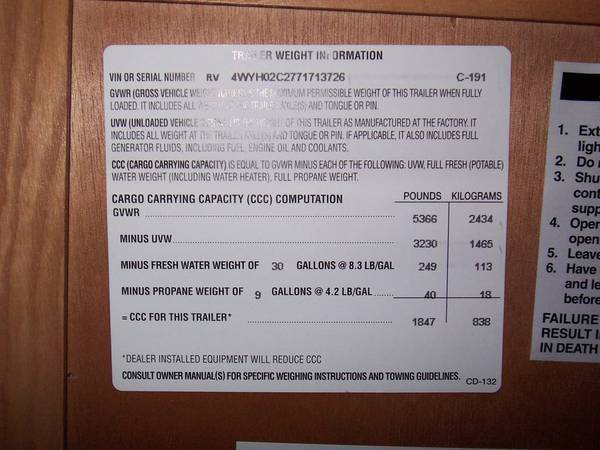

    Had this label inside one of my trailers. The brochure had listed dry weight at 2950 but that didn't include the added options which brought the weight to dry weight 3230. Options where things like heater, microwave, AC. So anything in the brochure that's listed as an option won't be included in the "dry weight" from the brochure.
