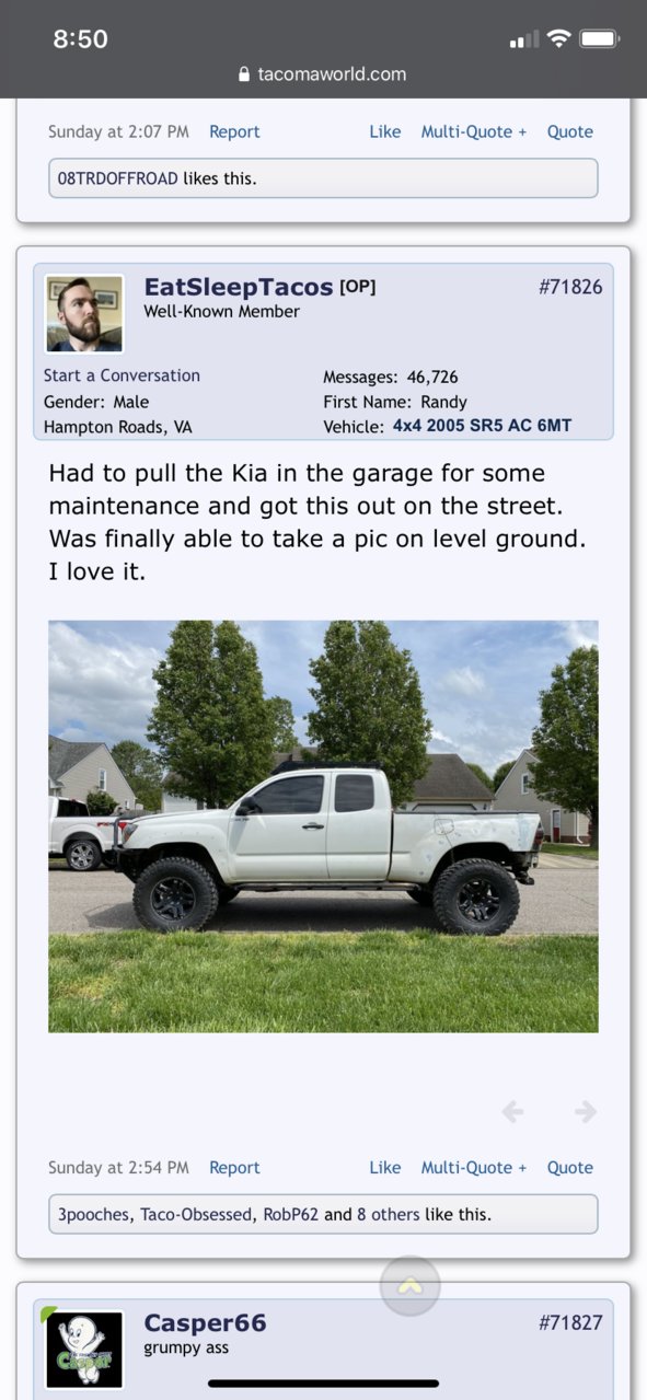

    look at what @EatSleepTacos did... still the longer wheelbase, but 14" shorter overall and better exit angle.
    edit: i see you have the dclb... hmm

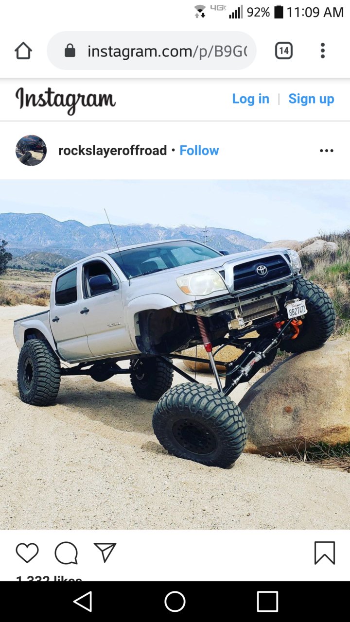

    What it will be when done. longer wheelbase isn't the end of the world but shorter would be a bit more maneuverable in the woods, obviously
