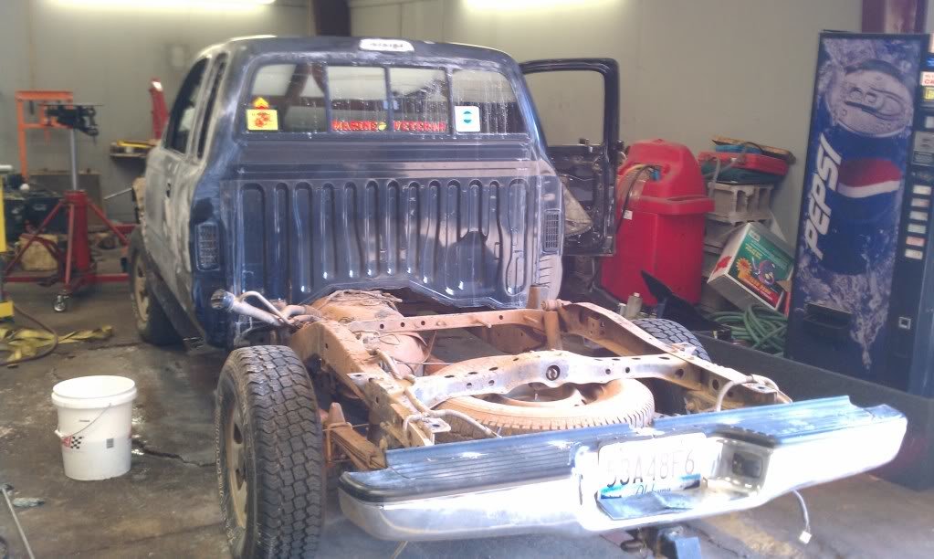

    found this pic

    It looks like the 1st-gens have one on each side. I just checked mine, and I have those. Never noticed it.
    Not sure if all years have them.

    It's a cheap-ass check valve of sorts. You're going to hear outside noise. What made you notice it all of a sudden? I never paid attention to it until I removed the rear storage bins to do the Molle Panel install. Then I packed the void with packaging foam to help quiet it.
