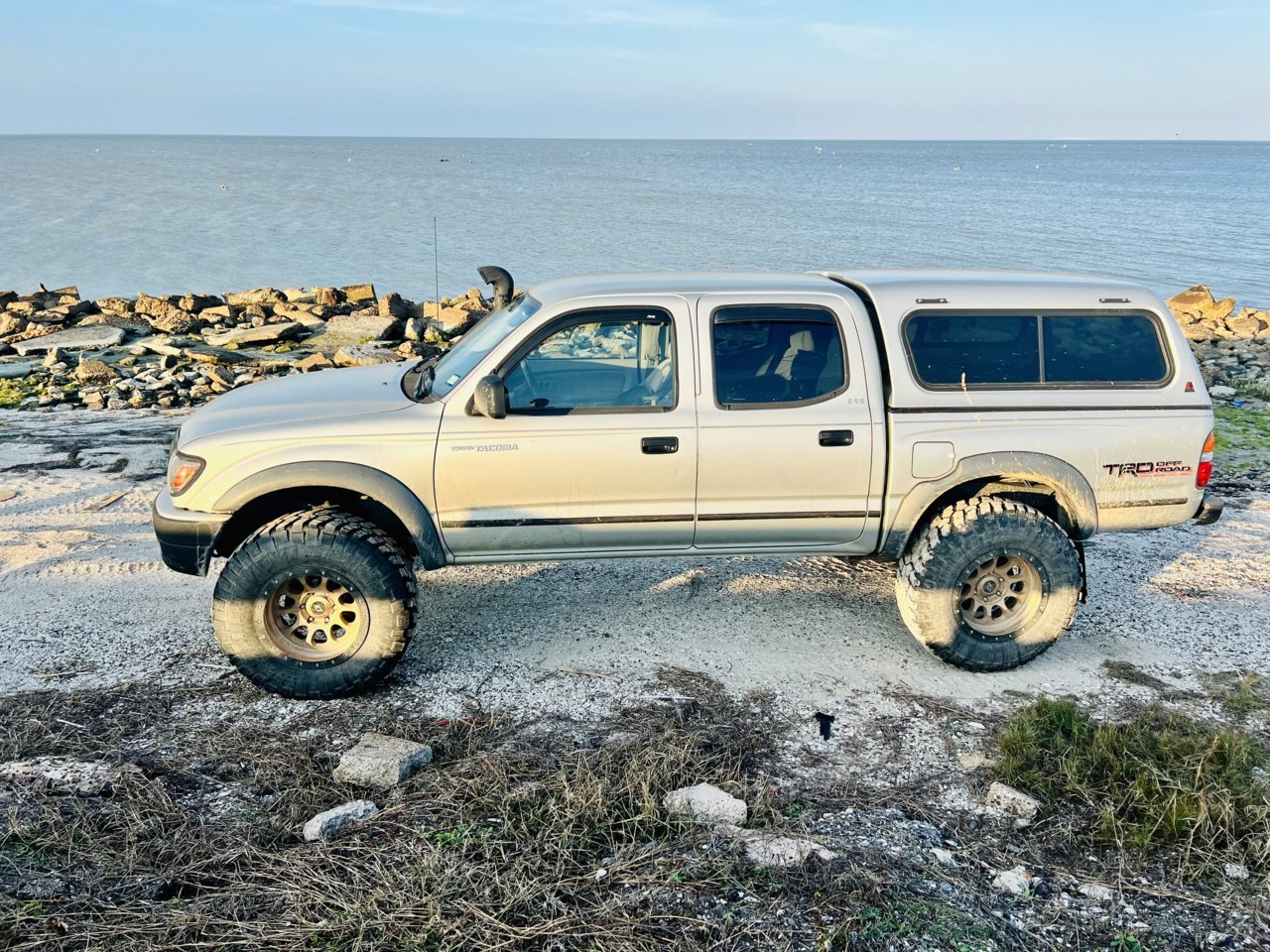

    Chasing down some vibe issues in the cab .. shakes vigorously 40-70mph. Heres what ive done to help correct this issue but its still there..
    Mods: billstein 5100's
    285/75/17
    17x9-38
    Maintenance to correct vibes:
    Lower ball joins, outter tie rods, inner tie rods, steering rack, alignment, new carrier bearing, carrier bearing drop kip, tire balance (twice), greased the drive shaft,
    What else should i do? Looking to replace my transmission mount and the rear axel shims. What shims should i try? Pretty expensive to try all the available sizes.
