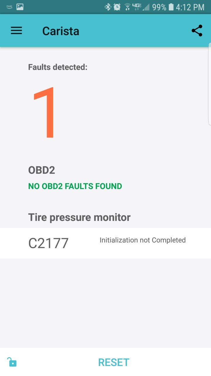

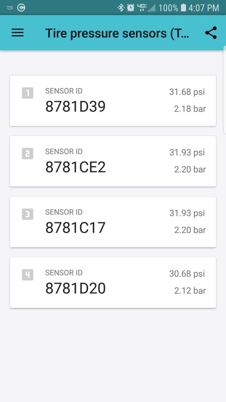

    Sensors seem to be reporting normally. C2177 code though for the TPMS system. Appointment is on Tuesday at the dealer.

    It's good that you have a current copy of the sensor IDs, just in case.
    I'm sure you searched, but the attached file seems relevant?

    If you have the tool, delete and reprogram them from your ecu. Else get a shop too.

    That is a screenshot out of Carista. It allows you to do that now. I think the problem is on the receiving / processing side?
