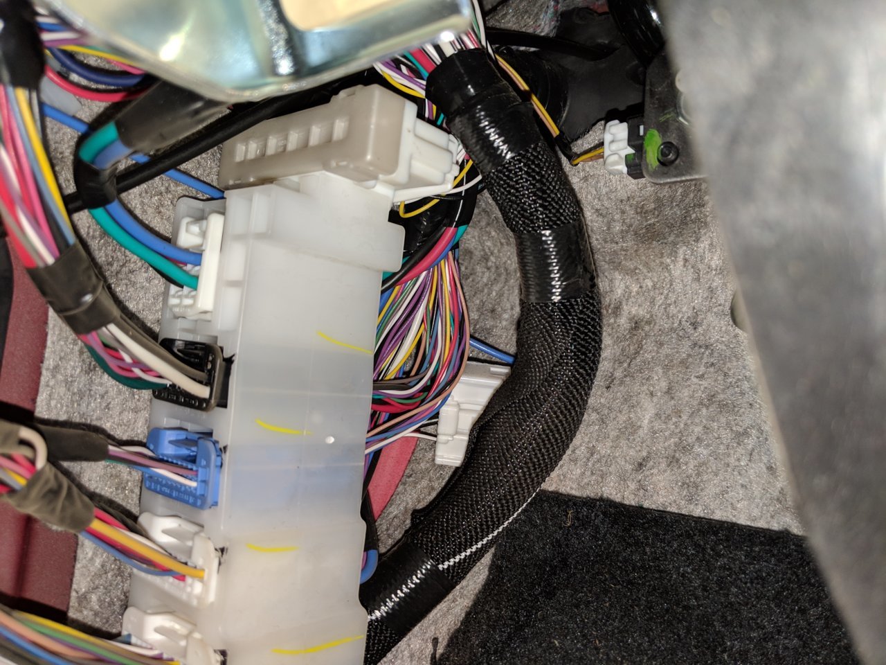

    The new receiver didn't fix it, so they started looking at the plugs up front. The lower connectors were wet, which is probably causing the issue. I sealed it all up with silicone when I ran the wire through.
    Any idea how/where the cowling drains?

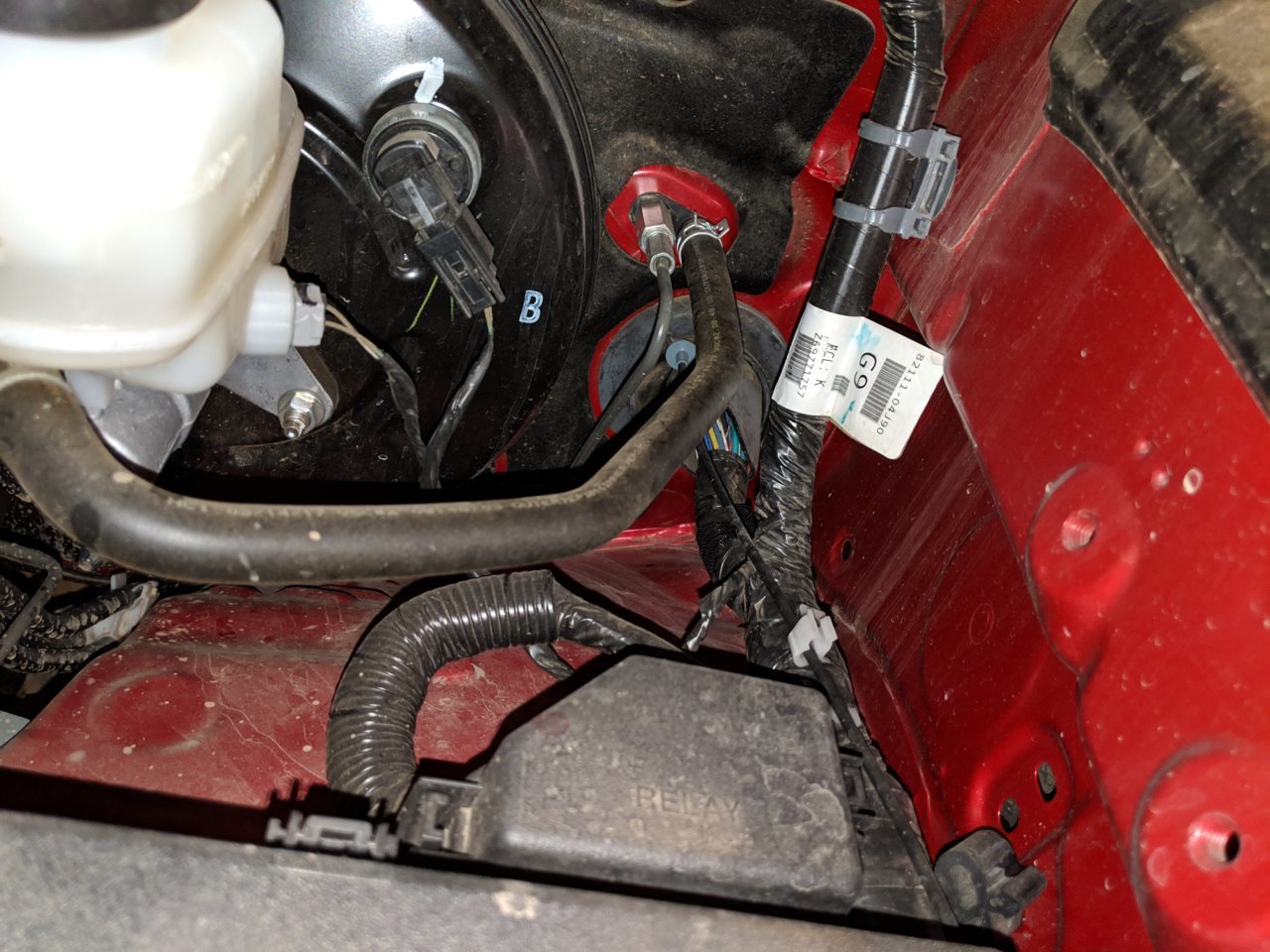

    FYI, since you don't have yours to look at, this is the left side area of mine where I tapped an unused connection for non-key power.
    I can see where moisture could whick upwards to bad locations.

    It's the lowest connector on that stack. I'm most concerned about how the water is getting in and what it looks like under the cowling. And if the grommet is exposed inside the cowling area.

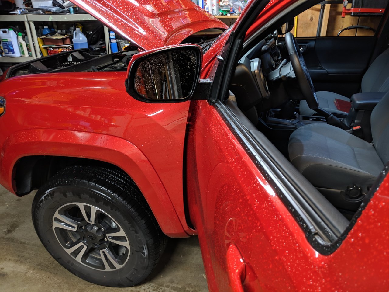

    Here's the thing, the Taco is soaked from todays frog choker:
    But, that grommet is dry as a bone:
    I got home only an hour ago.
    If i were to approach it as a first step, I would request proof that there is a hole in the grommet. There's is really no more damage that could be done in the area from a test.

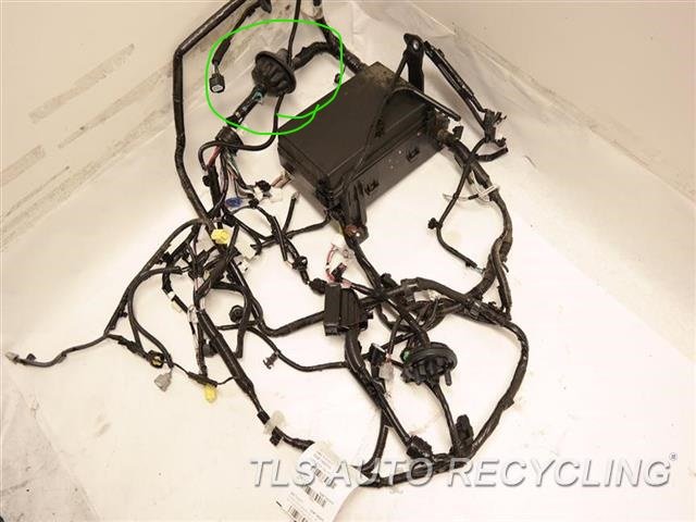

    I can't find anything in the SM about body drains (other than the sun roof) or the wire routing through the FW.
    There are a lot of harness pics on google. I just searched 'tacoma engine main harness' and had to pick through pics of the left and right harnesses.
    I believe your ECU loom looks different than mine on the right side, but I think the left side (accessories) looks the same. There are some decent pics of that:
    https://www.tlsautorecycling.com/search/2013/toyota/tacoma/349186.html
    https://www.tlsautorecycling.com/search/2012/toyota/tacoma/266461.html
    What I can't tell is what seals the grommet. It looks like there might be a plastic retainer in some pics? I really wonder if the grommet might have been misinstalled to start with?

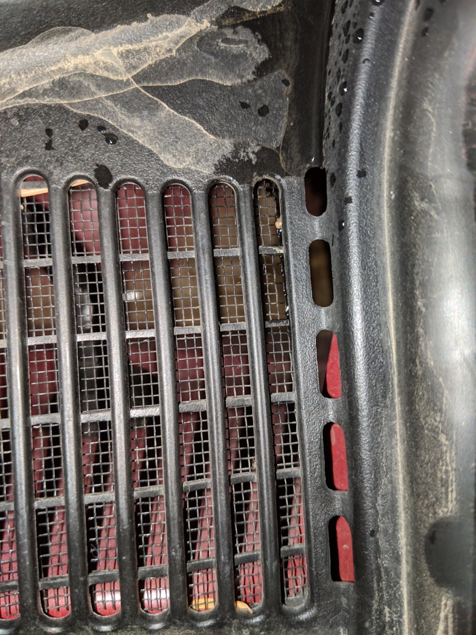

    I just can't figure out how water going into the cowl would supposedly come out through that grommet inside the cab. It just has to be coming in another way.

    I'm 100% positive it isn't possible for water from the cowling to get through this grommet from looking at this image.
