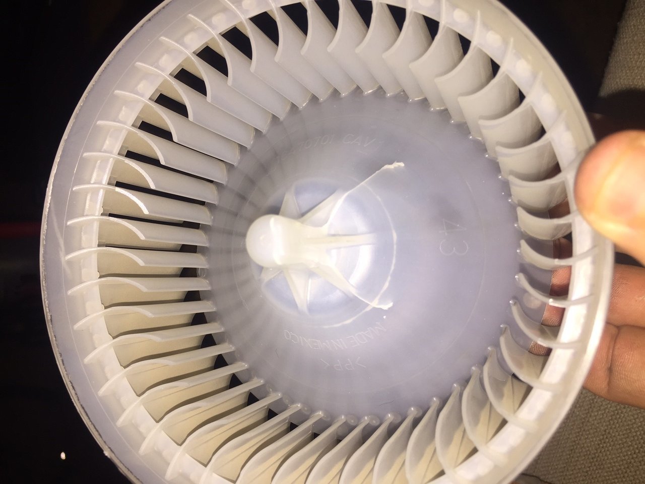

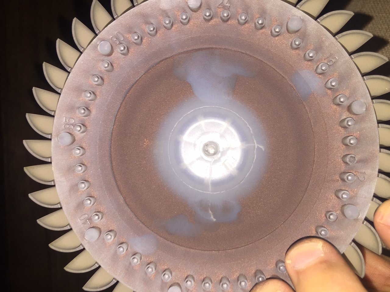

    Went to go turn on the truck yesterday and heard a horrible noise coming from behind the glove box. Went ahead and pulled out the blower and noticed that it had cracked and the inside was completely stripped. Was curious if anyone else had experienced this on the 16-17 models. I don't even want to bother calling the dealership since I'm technically out of the warranty period and figured I would just replace it myself.

    It seems to be a pretty common issue

    Out of warranty? Isn't the warranty 3yr 36,000mi? Call the dealer and check but I think you need to be under warranty for a TSB? I'd just source parts (CamelBack Toyota?) and DIY it.

    From what my dealer told me when mine did this, you have to replace the whole blower motor assembly, not just the squirrel cage. Mine was covered under the factory warranty (3yr/36k) so it was free. Otherwise their parts department quoted me $150. I'm sure you could shop around and find it cheaper.

    Common problem with the 3rd gens. Good luck finding an OEM replacement!

    Yup, the full assembly. Mine was replaced as soon as I heard something. My wife thought I was hearing things.

    Mine was running at max for most of the summer with 110+ degree days. But the fact that they're press fitting a plastic squirrel cage onto a metal shaft seems like the main culprit to me. Too much stress and thermal cycling for the plastic to take.
