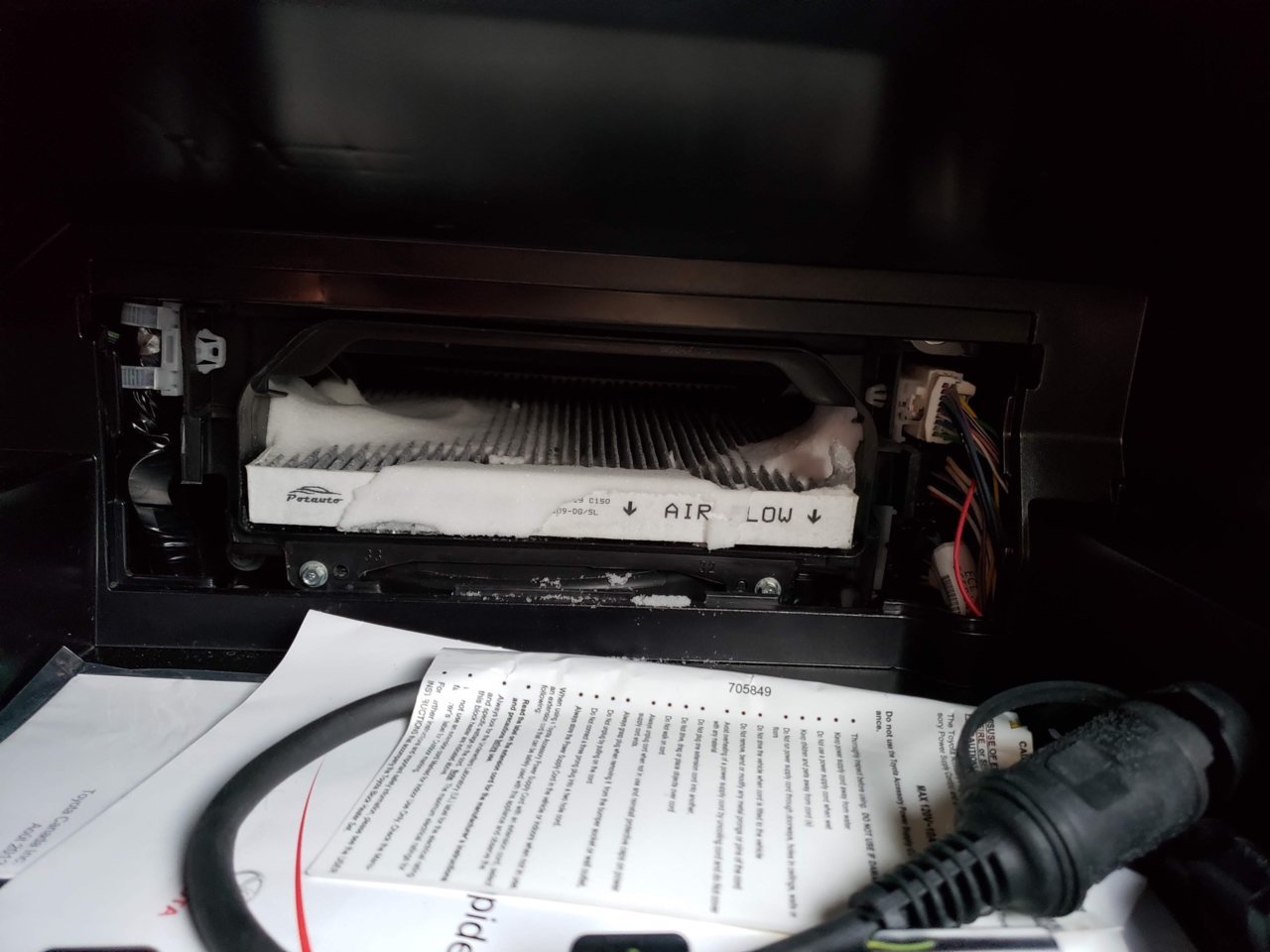

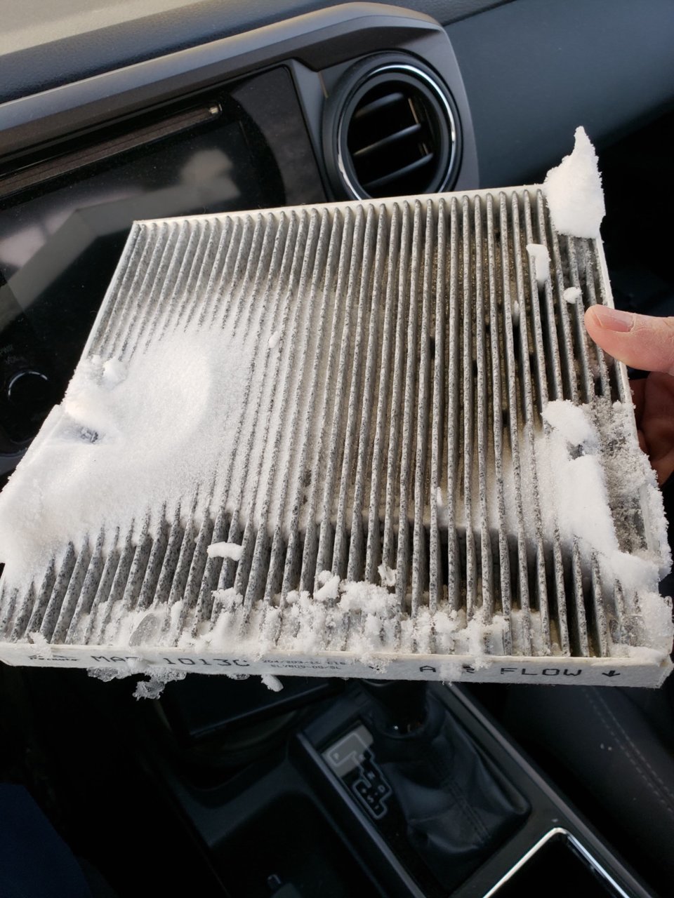

    41FA2C65-3B31-4C45-B29B-D500A666AAA1.jpg A7DCDA8B-A47A-4A8A-88DA-F5A9A7C73D53.jpg Anyone get this much snow on the cabin air filter like this? I was driving and suddenly windows and windshield all fogged up. Opened the cabin air filter and saw this. Now everytime there's snow outside there will be snow in the filter. I have appointment next week see what the dealer say. Can someone at snowy areas also check their cabin filters also?

    I've had leaves and dirt/dust on my cabin air filter, but never snow...were you driving through a snowstorm with light powder? Damn, that's crazy...

    I swept the snow off the truck pretty well. There were some stuck between the wipers and the hood. Somehow these residual snow got sucked inside.

    Was your truck buried (covered, not literally buried) in snow? That's the only way I can see snow actually finding it's way in that deep...jesus

    These pictures were taken last week, there were about 1" of snow on the windshield. And today about 2" of snow and there was much more snow in the filter but I didn't take the shot. I brushed the snow off before driving though. Now I carry an extra filter to swap it out until the dealer checks it out next week.

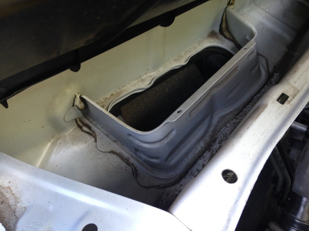

    The intake for that is inside the engine bay. At the back on top of the firewall is a cowling that's vented on the driver's side but covers the entire width. It comes off pretty easily. Rats, mice, younameit can find their way inside and get into the duct leading to the filter/fan box which is on the passenger side. That duct is wide open, no screen, louvers, nothing. You can take a kitchen hood filter and make something to help prefilter the larger debris and by overhanging the duct reduce or eliminate the snow as well.

    Same way leaves and dust do, engine bay> cowling vent> intake duct> filter. Anything airborne and some that crawl can find its way, that's why there's a filter. Fine dry snow acts just like dust.

    This is what's under the cowling. 2964E37F-721B-4916-A586-E4814841C654_zps_8131c6abf9163bbc78934b0038168a29b00a2c04.jpg
    What you're looking at in the duct is the door that closes when you switch to recirc. When it's open the very next thing is the filter. Nothing was wrong other than your filter needs changing and nothing is broken. Keep it on recirc and the snow won't get in there, it will stay outside the duct until it melts and drains out the fenders in front of the doors.
