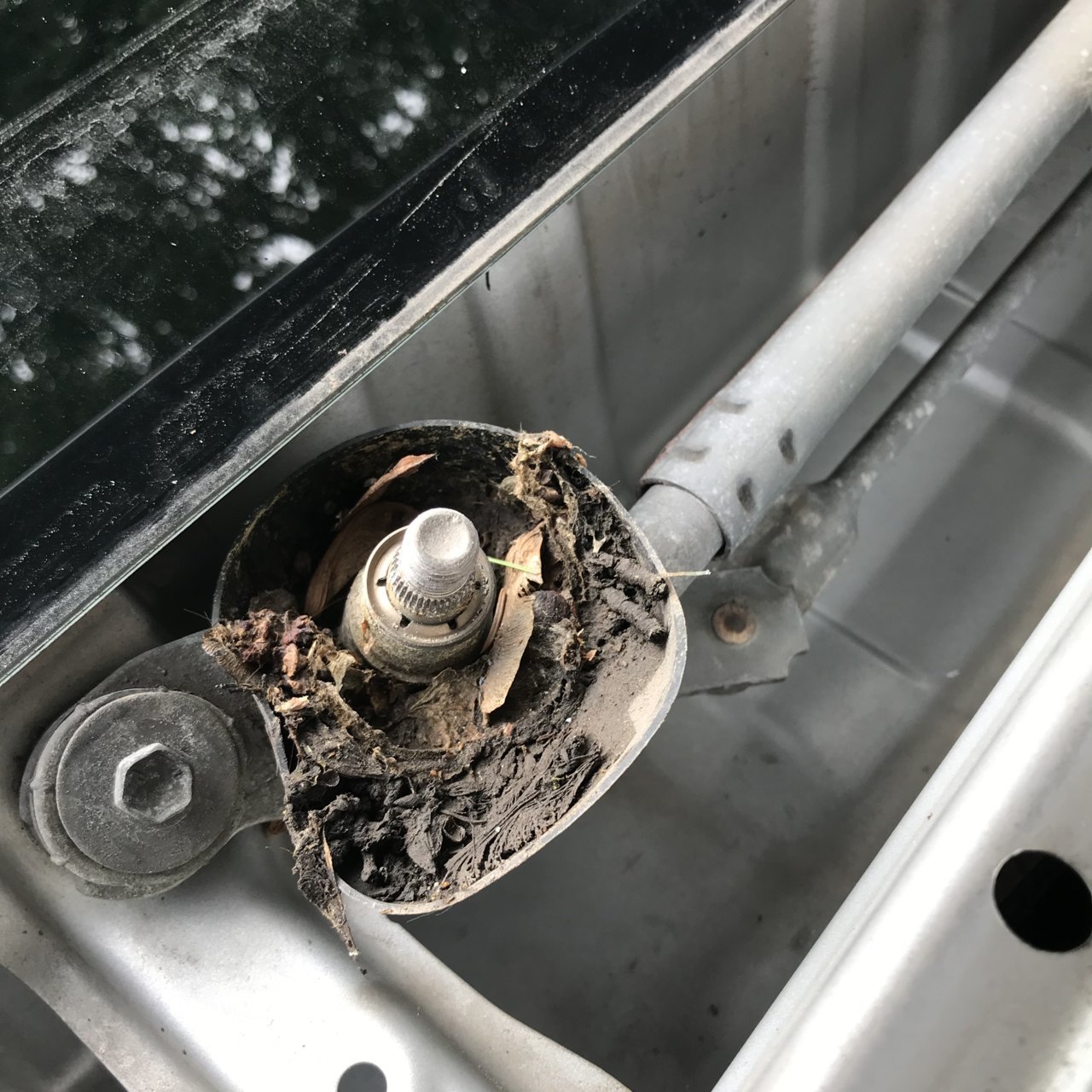

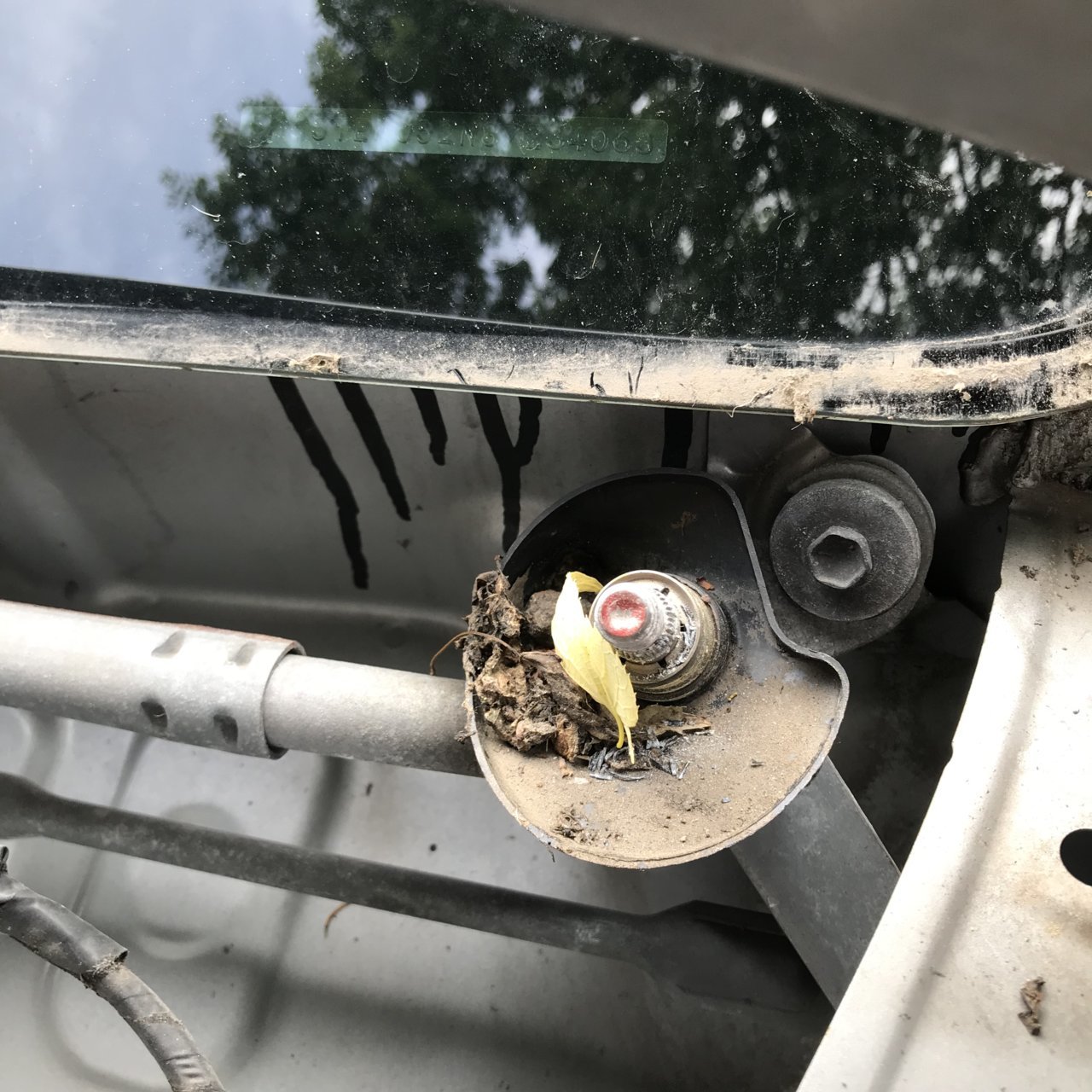

    L J
    L J [OP] Well-Known Member
    Mar 16, 2010
    #33339
    859
    Illinois
    07 4X4 SR5 TRD Sport DCLB
    Pulled the cowl and took it all apart to clean it. This is what was under there.
    And the other side.
    Those two plastic cups were full of junk and there is a drain at the back of each that needed to be cleared out.

    L J
    Mar 16, 2010
    #33339
    859
    Illinois
    I used the dirt line under my wipers to realign them.

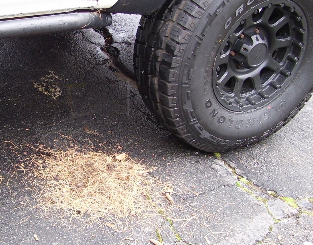

    JL8Jeff
    JL8Jeff Well-Known Member
    Feb 6, 2018
    #243662
    982
    Jeff
    Ewing, NJ
    2013 Tacoma reg cab
    OME 885/nitros, SPC UCA, 305/65/17, AAL
    This is the pile of pine needles I pulled out from the passenger front fender in front of the door. You really need to keep an eye on that area like mentioned.
