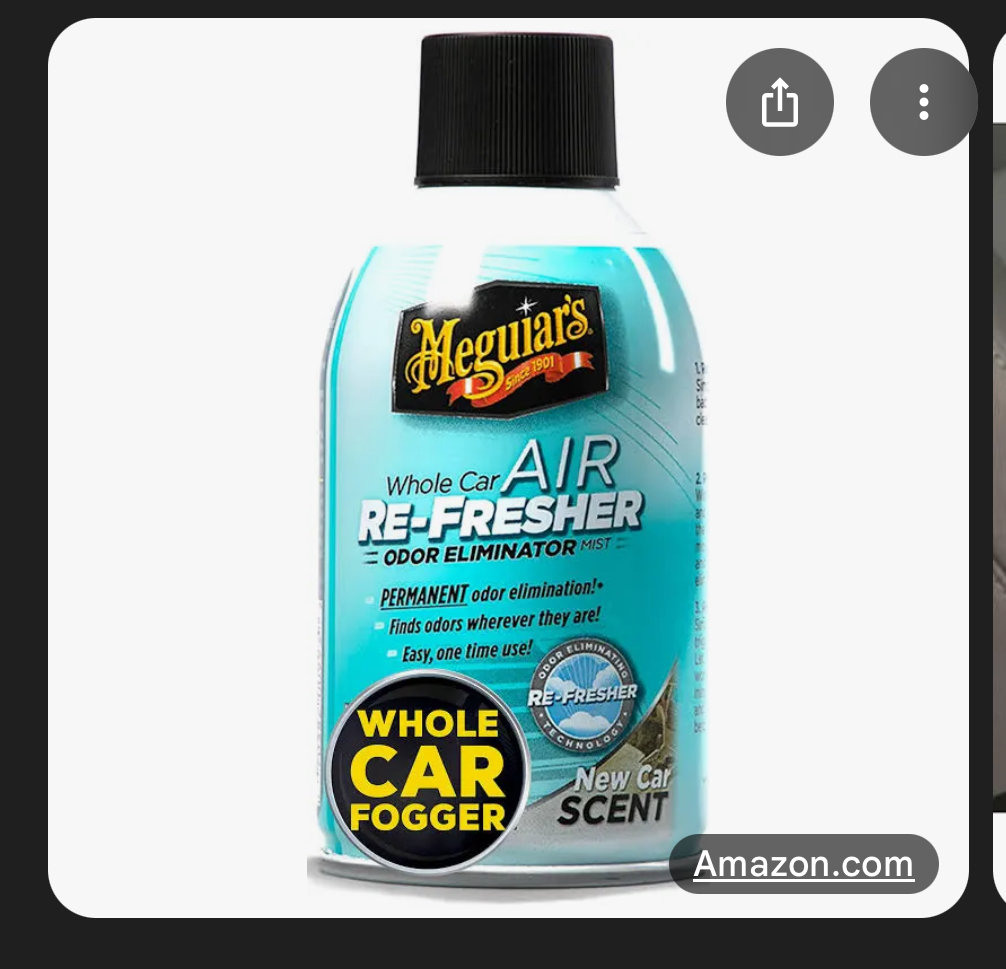

    I replaced my CAF and with it came a mouse nest :-/ It still smells of mouse piss. 2 questions; What is the routing of air to the suction side of the CAF, and is there a spray of some kind that will neutralize the smell? I got the nest out, but wonder if there is somewhere upstream that they could have another nest? TIA Cheers, Dave

    I used this in my f250 that had been sitting in a feild for years with the windows down I think it killed everything. I also had a rat crap in my cabin air filter on my Tacoma as well I caught it fast so the stench didn’t linger for too long. This stuff really works I opened it and left it for a few days.

    I use these in my engine bay the rats don’t like it so they won’t enter the engine bay and tear up stuff.
