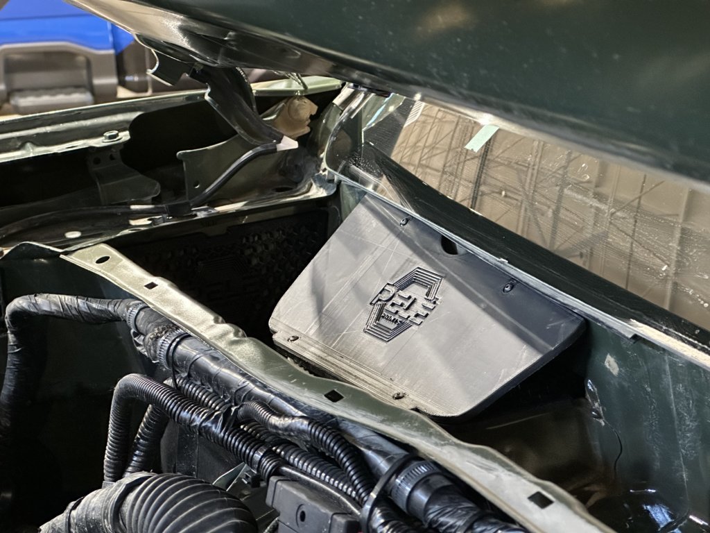

    Hello! My HVAC screen and cover fits the 3rd gen. Let me know if you are interested in purchasing it. Feel free to message me or email me at peleprints3d@gmail.com

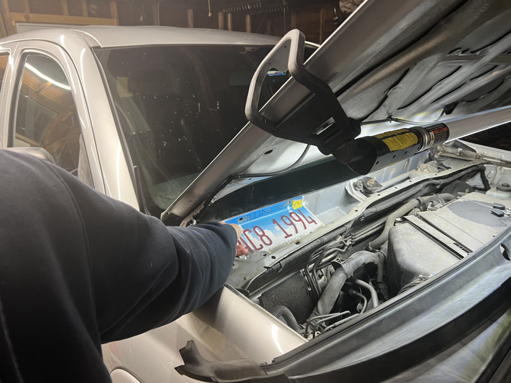

    It is crazy that these tacomas have this issue. I put together a video on how to fix this issue with an old license plate and replacing the blower motor, resistor, and their harnesses if you were getting water in as well. Hope it helps some of you with this problem!

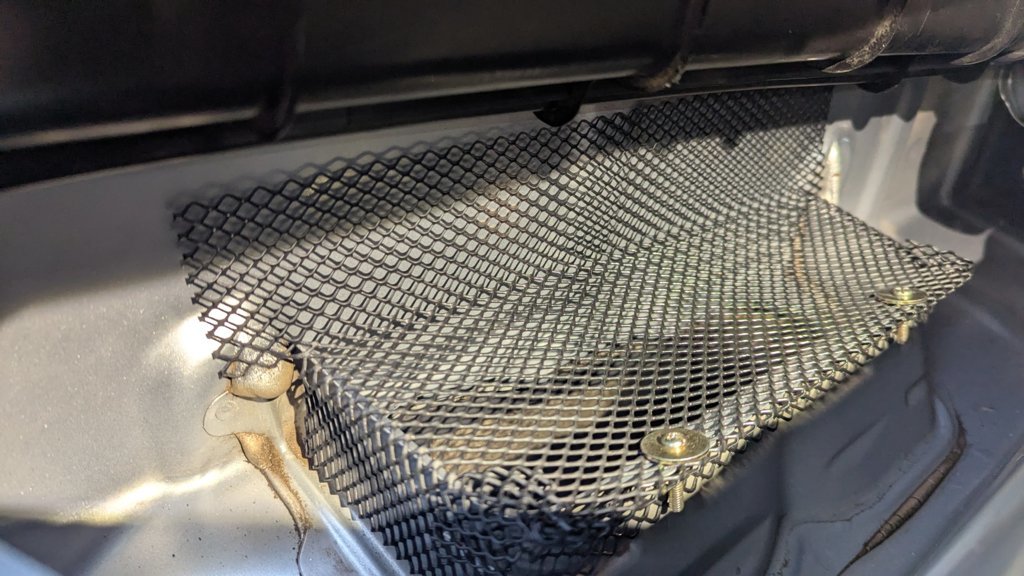

    Thank you for the write up.

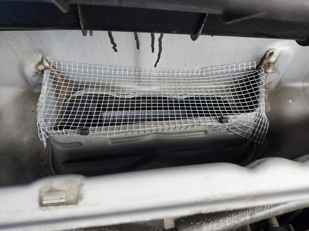

    Just did mine today after digging live pinkies out of the cabin filter. Lowe's had the metal gutter guard section on clearance for $1.47. Made one for my wife's CRV too. Tomorrow I will guard the engine intake... Much appreciated!
    ACEkraut likes this.
  7. Mar 31, 2025 at 2:41 PM
    #107
    skiergd011013
    skiergd011013 Well-Known Member
    Sep 13, 2014
    #138178
    2,648
    2010 TRD Offroad 4x4 AC SSM

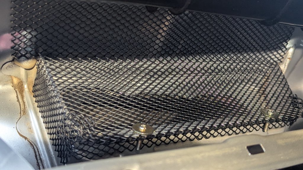

    Finally did this after finding acorns and leaves ontop of my filter. Not as pretty as some of yours ive seen on here, but this hardware mesh will do. I also dropped my blower fan to look inside it, but it was clean. Installed a new carbon air filter. Both my left and right fasten pins were missing on the big plastic cover, so i put on some plastic push pins of my own that fit perfect. My neighbor came over and looked at what i was doing, and then he immediately pulled apart his third gen to look at his air intake, and he said there was already a cover on his. Did they provide a cover of gen 3? I didnt go over to look, hopefully he was checking the right spot....20250331_130536.jpg
