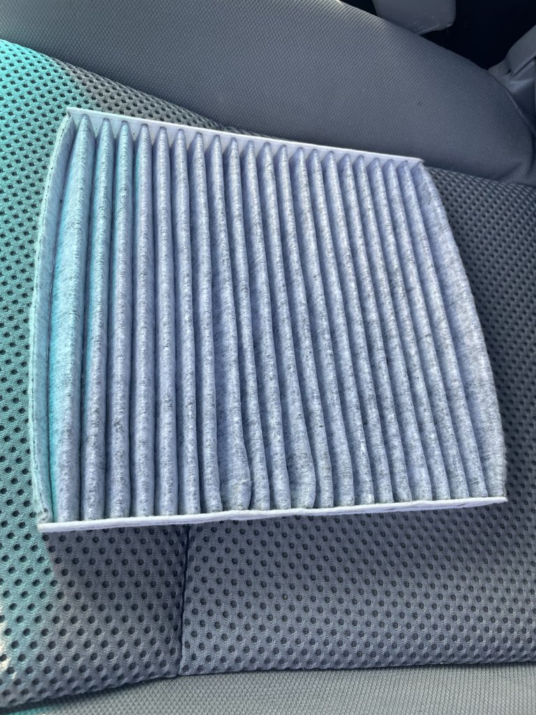

    As if the orientation of the “Air Flow” isn’t a hard enough not to crack. I realized today that my blower was not putting out very good air on max. I recently changed the blower motor and put in an extra fancy filter with the carbon layer. I was getting virtually no air out of the front vents. It sounded like most of the air was being restricted up near the dash.
    I pulled the filter out and it’s blowing like crazy now. I even tried flipping it to see if it would make a difference nope. I feel like the cheap low quality replacement flows better probably because it’s not as thick.
    Has anyone else ever experienced low flow with one of these carbon enhanced filters? I’m not kidding when I say the difference is incredible running without or with a cheapie.
    Does the factory filter allow for more airflow? Because this aftermarket unit really seems to restricted it.
    I’m mostly just sharing this in case anyone does a search on why they’re not getting good air volume.

    Airflow isn't known to be great on these to begin with but yea the thicker the filter media the less air is gona flow through it.
    I have a K&N washable cabin filter in mine abd it flows pretty good when it's clean.

    I noticed the issue on my truck. Two different Toyota part numbers come up for cabin filters on their parts website: one is the normal/standard factory filter and another for a carbon impregnated one. The latter is noticeably more restrictive. I removed it and installed the factory one it comes with. Here's a list that might be helpful. (Not sure why the part number(s) for the two Toyota filters link/point to an Amazon listing.)
    Cabin Air Filters (2nd gen)
    Toyota OEM Factory 87139YZZ09
    Toyota ("micronAir") Cabin Air Filter 8850801010
    MANN FP-1919
    Denso 453-6058
    FRAM Fresh Breeze CF10374
    FRAM True Air CV10374
    WIX 24871 / 24871XP

    The carbon filters need to be changed much more often, like yearly, from what I've read. I believe that they clog quickly and the carbon does it's job by neutralizing stuff and wearing out after about that time too. I think a new filter of either kind will help the airflow problem.

    I know what you mean. I had a customer complain about airflow right after I used one of those carbon filters and I've avoided them ever since

    I had no idea this was a thing. I just figured they would flow the same. Definitely didn’t expect to see such a difference in negative flow after installing the carbon filter. Time to grab a couple of basic filters and can the carbon one.
