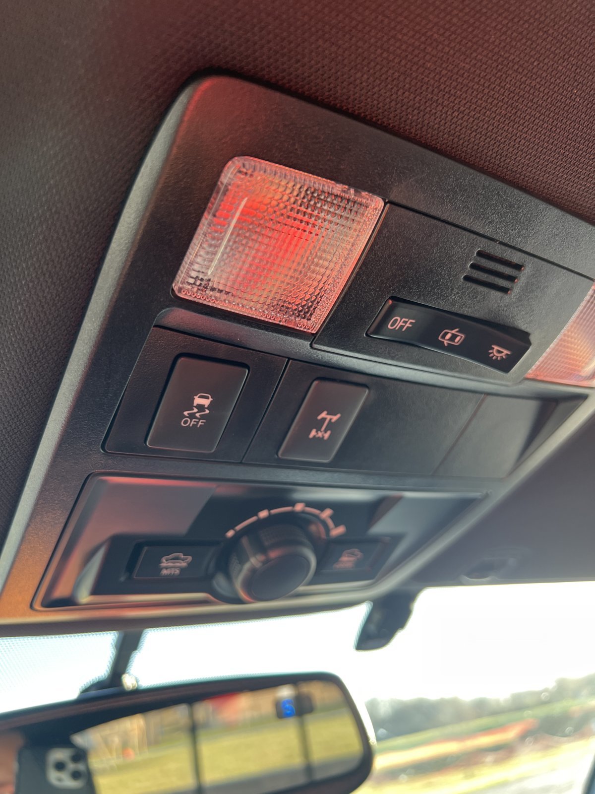

    My cabin lights, traction control, rear differential and even crawl setting not working. Any ideas.
    And if i take it into dealership should i have my OTT tune wiped before i do? Anything helps

    My guess ... a fault in the wiring bundle to that console, such as an incorrect ground wire. Why would the OTT be the proximal cause if the OTT was done long before now?

    In the photo the cabin light switch appears turned off.

    any recent mods? best case scenario you may have blown a fuse. I'd check all my fuses before going to the dealer

    Maybe. Rarely is life so accommodating as to have sparking wires. Usually I just find a loose ground wire after fiddling with the harness. :annoyed:

    No recent mods. I dont think its a fuse because that would be multiple fuse's that correspond with everything on that ceiling panel. Whats your take on if I should get my OTT tune wiped before i take it to dealership?

    Pull down the console from the headliner and see if the wire harness is still connected.

    Just give it a good yank? I dont wanna break anything lmao!

    Sure enough it wasn't connected. Thank you!!!
