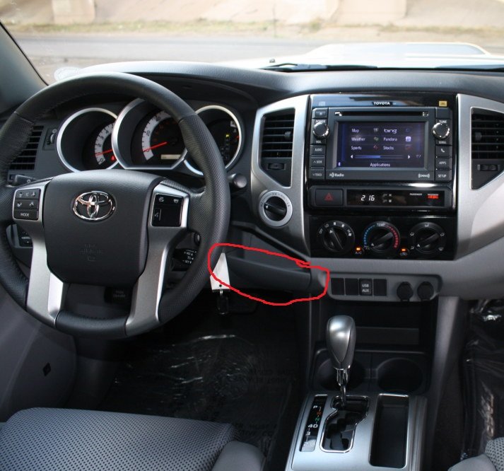

    I share your concern OP. I have just noticed in the past couple of weeks a noise coming from the back seat. Its very inconsistent. My first thought was some of the things that I have in the rear compartments, but have dismissed that after taking a few of the things out that it could have been and still hear the rattle. It sounds like a few birds in there fluttering around.I am still in the process of investigating what it could be.

    I have a 2012 with about 19,000 miles, and I have a rattle in the center of my dash. It started before i ever even took it off road. Want to have the dealer fix it, but worried it will prolly just get worse after they put it back on:eek:

    I've wheeled and jumped my 2011 (shhh dont tell the dealer), no rattles yet at 25k miles knock on wood. I do get the door rattle from the stereo which I was going to dynamat. Tightening the door screws helped a bit but they were on there pretty good already.
    If you can find the spot where it rattles, some dynamat or thin foam tape might not hurt...

    I totally agree with you on this. Like I have said I feel like im nit picking but c'mon a 30k+ vehicle could have rattles and squeaks at 10k miles..
    Ya its not like a rattle, its more like you are hearing like plastic rubbing and shifting haha. If I hold the corner down it goes away. I am thinking about taking the piece of and installing some dynamat or a piece of foam to see what that does.
    I did have the dealer look at it for my 10k service. And they did remove and install the center plastic and for a day or 2 it was perfect and I was happy :)
    :) That's what I am going to try this weekend.
    I appreciate all the feedback guys, I thought i was just being a baby haha

    I dropped off my truck at the dealership this morning to fix my rattle and squeaks. Took the tech on a test drive to ensure that I didn't get the typical "we could not duplicate the problem, sir" and he seemed to know exactly what to do, and even said that he had run into the same issues with other 2012's... Anyhow, I'll let you know how it all turns out..

    In circumstances like this, ride alongs are the only way to ensure that the tech hears the same things that you do.. I am very hopeful that they fix the issues, because for me, they are rather annoying.. For what I paid for this truck, and Toyota's reputation for quality, I wouldn't expect these issues after only a year.. Heck, my 05 had 120,000 miles on it, and never had any of the rattles that I have in my 12

    Hey guys, I have a suggestion that might help those with rattles that seem to come from the center dash. Take some 3/8" or 1/2" backer board (from hardware store - it is basically a foam dowel) and shove it down between the top of your dash and your windsheild. I just got my 2011 with 25K miles and last week it started to creak around what I thought was the radio area. My 2003 Tundra did the same thing after a while. Today I remebered finding this solution TundraSolutions forum some time ago and it works great. I just did it today on my Tacoma and it took care of 90% of the creaking.
    Hope this helps.

    If yours is anything like mine, this part of the dash will squeak and rattle as it flexes against the main part of the dash, sounds like its coming from the center. Try grabbing it and pushing it as you hear the noise and see if it stops.

    Just got my truck back from the dealer, and all of the noises seem to have been resolved.. The rear seat was by far the worst, and the fix consisted of a few things; lubed the latch, and put some clear tape looking stuff around the latch receiver.. Drove it on a few rough roads on the way home, and everything was quite as can be... As an added bonus, the tech even turned of my extremely annoying seat belt chime!! woot!.. But yes, I will still be wearing my seat belt regardless..
