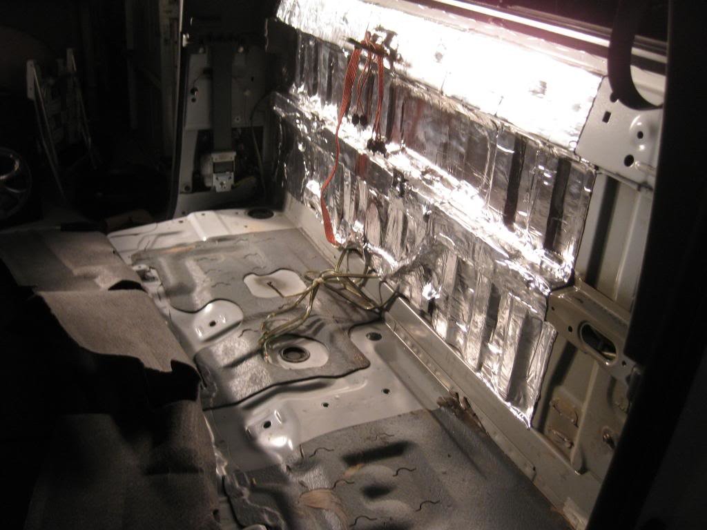

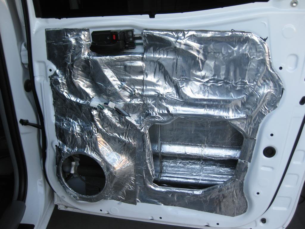

    I've been bitching about this to the dealer since the day I got my truck. I've had it in 5 times for the same squeak. Never once did they make it better, only worse buy adjusting the striker in too much. I've tried EVERYTHING to fix this. To prove it to them, I finally ripped the rubber trim off my Mom's 05 and put it on mine, no squeak.. Then put mine back on, squeak. They still said 'its the door striker" as being the problem.
    Needless to say, I didn't buy that crap and raised hell with Toyota Corp.
    Due to this they are flying a Toyota tech from their HQ to look at this issue since I won't give up on it. I take my truck in Tuesday. I've subbed this form and I'll post what the say.
    I do highly suggest using Raamat or some sound deadening material to reduce the rattles. I used insolite from Raamaudio to wrap around all my cables, and followed his directions to the 'T'. My truck is very, very quiet now other than that damn squeak and the head rest rattles. Other than that, no rattles at all. It's a lot of work, took about 20-25hrs to finish the truck but worth it if you like a quiet truck.
