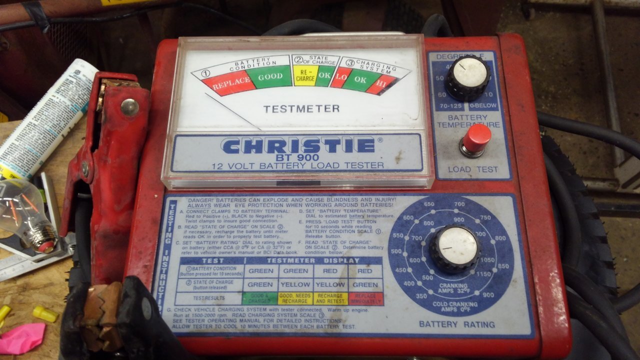

    12.44v is just over 80% of full charge (12.42v). Fully charged the battery should read over 12.7v.
    As the truck is almost new I would say something isn't quite right, batteries are the weakest link in the system so start there first with a load test - a real load tester is about the size of a old style kids lunchbox by the way.
    Notice the size of the battery clamps, this style has a carbon pile resistance inside, it pulls 300 amps from the battery when testing.
