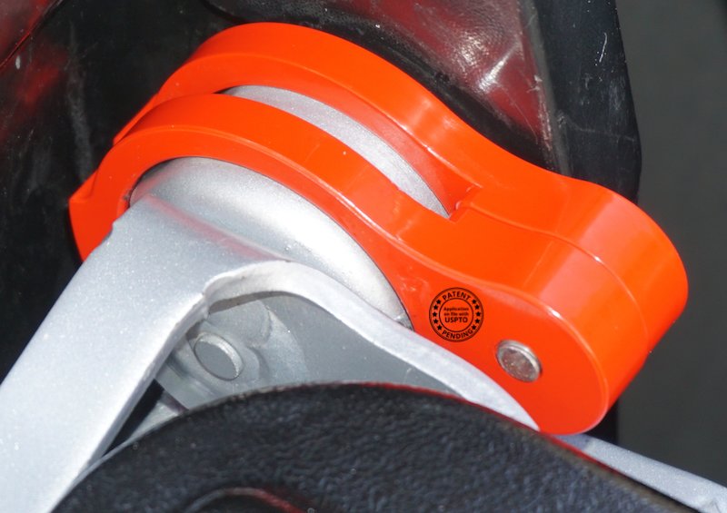

    SaBellCo's Tailgate Lock :), Cable mod

    Pop N' Lock. Cables can be cut in no time flat. They offer no security.

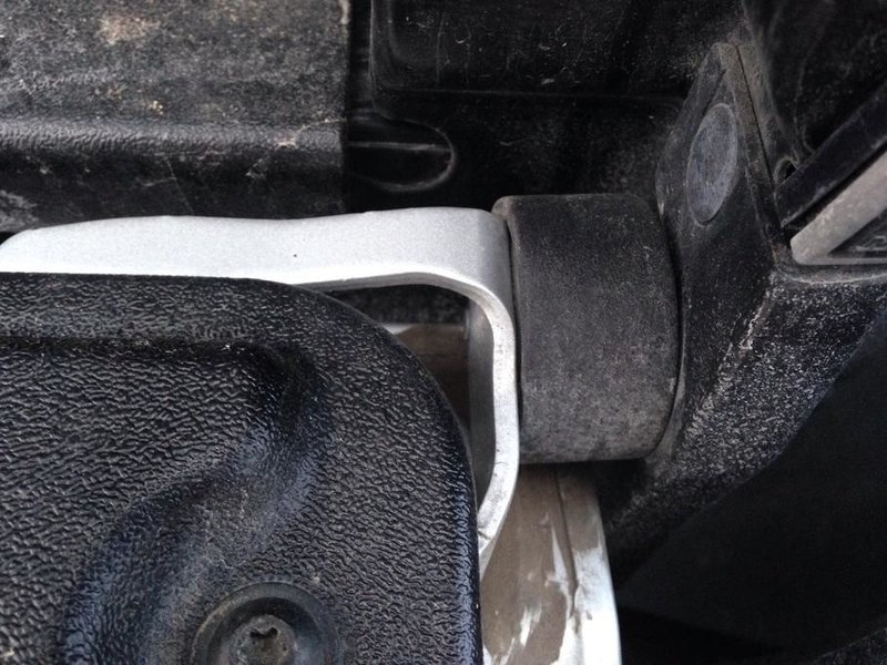

    Somewhere on here is this thread about simply fitting a short length of tubing / pipe over the tubular hinge. I relocated their picture here (thanks). Takes about 1-1/2 inch ID tube. The RH Pipe over TG hinge.jpg
    hinge is disassembled from the tailgate and the tube slides over the slot opening - engaging the joint in semi-permanent fashion.
    Then the hinge is bolted back onto the tailgate. If the thief has a nice tool collection - and lots of time - this could be defeated, but not too likely.........

    that is what I did on the clamp
