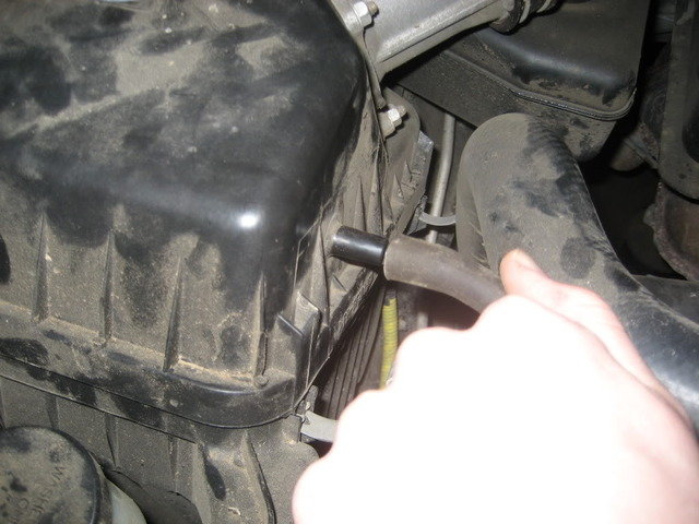

    There's some kind of line I remember going to the top of the air box on mine... I thought it could be a vac line?? Could this be it?

    I had a pic!
    It's this 'un

    Mowtaco; thanks for the pic. There is that vacuum line, and it is connected and sealed.
