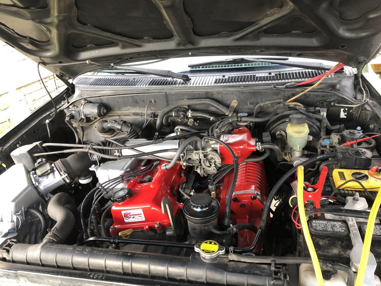

    I have the relatively rare 2RZ/3RZ Alpine Supercharger made by a small South African company. Finding the CARB decal was basically impossible so I made my own in Adobe Illustrator. I had them printed by a decal maker.
    This decal doesn’t exist. I made it myself.
