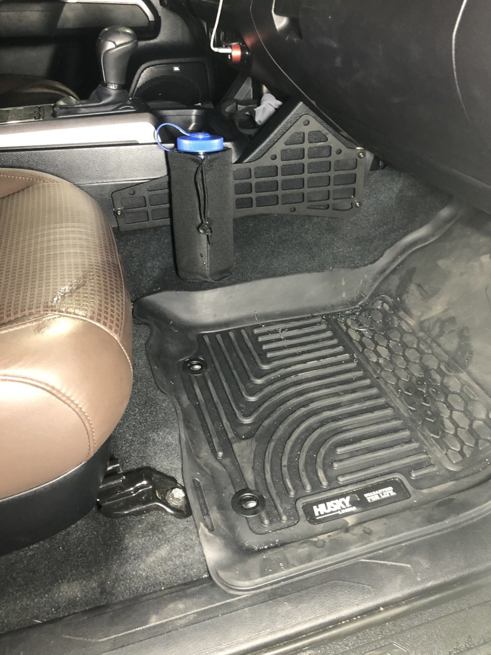

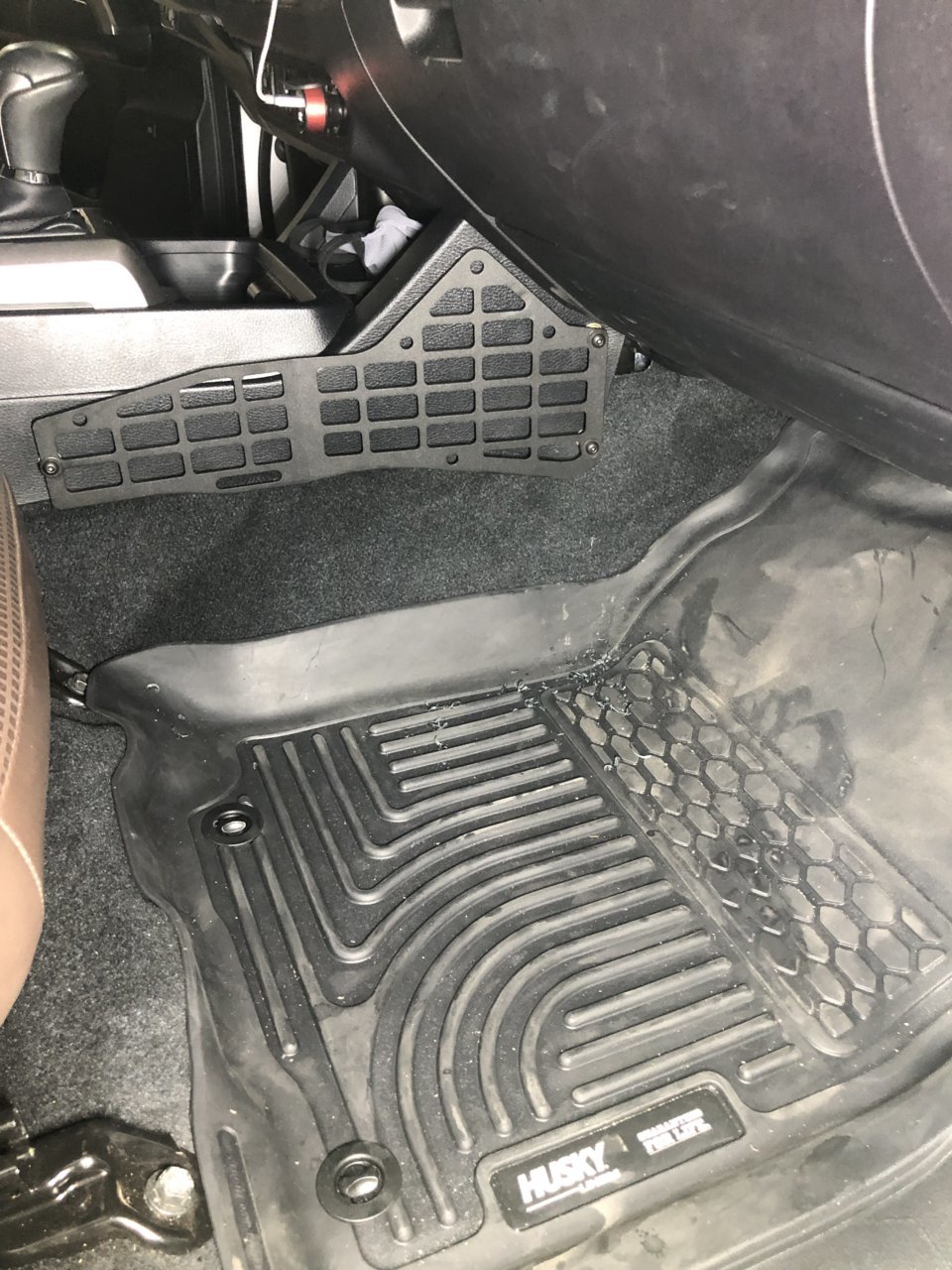

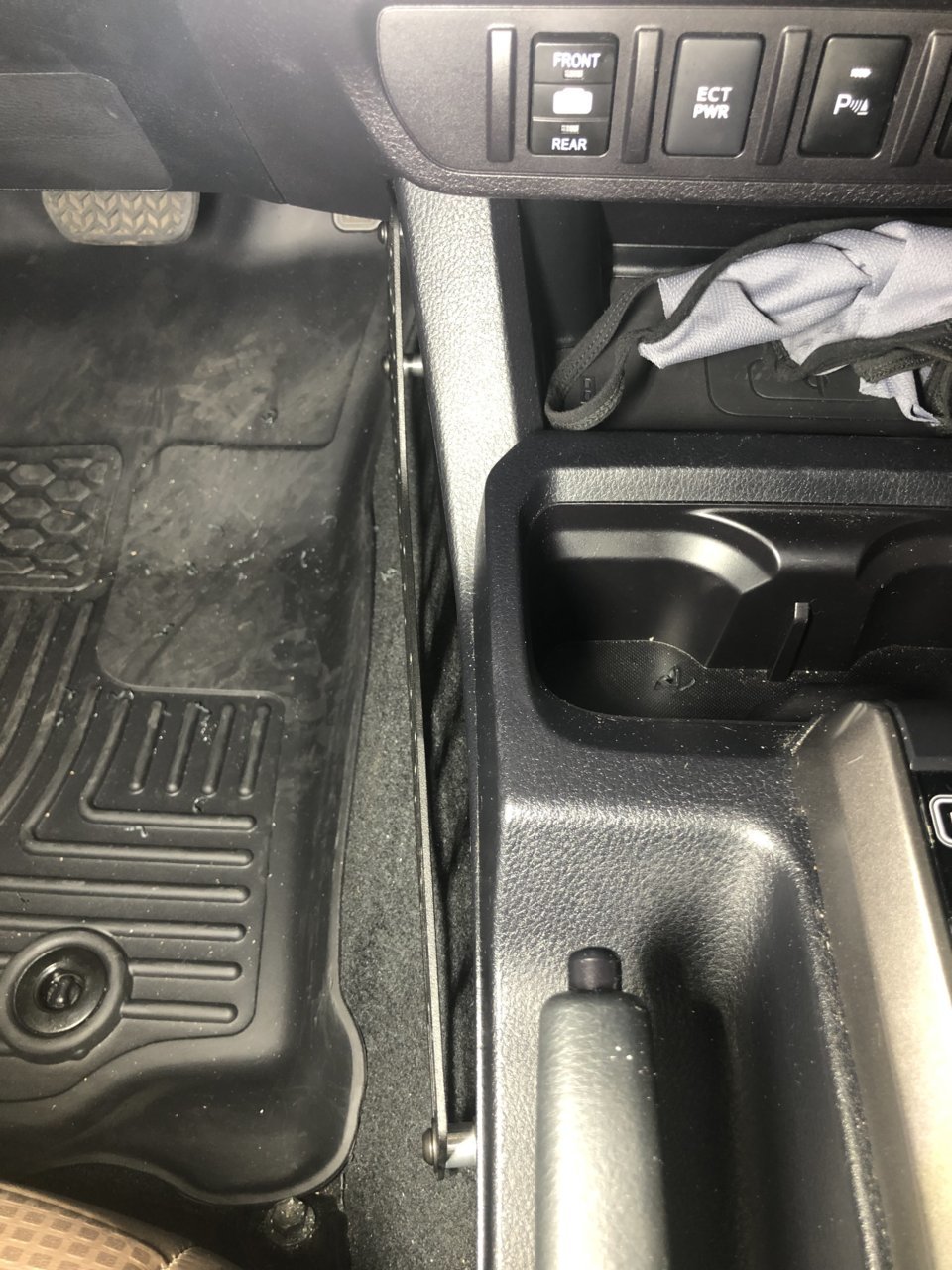

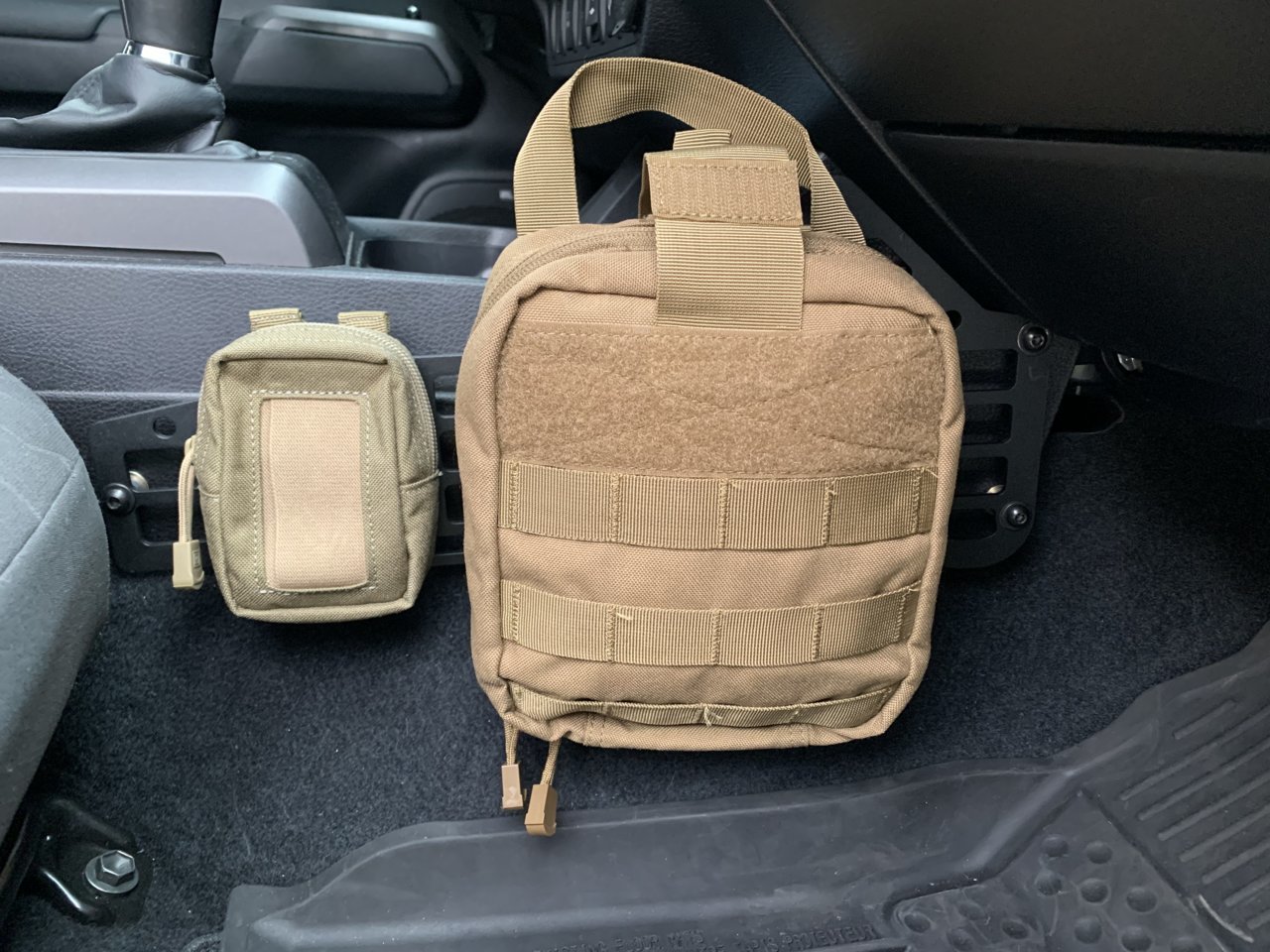

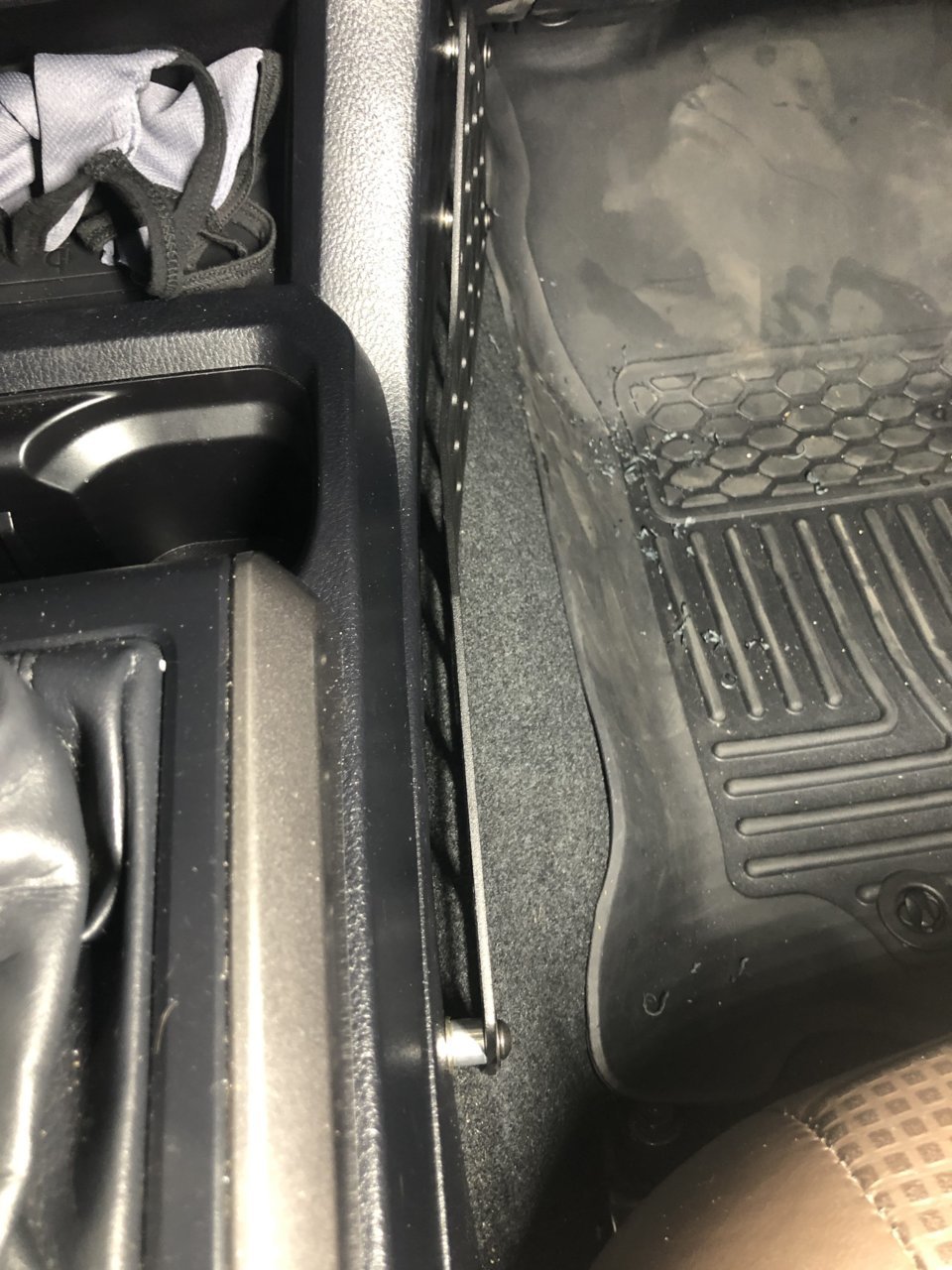

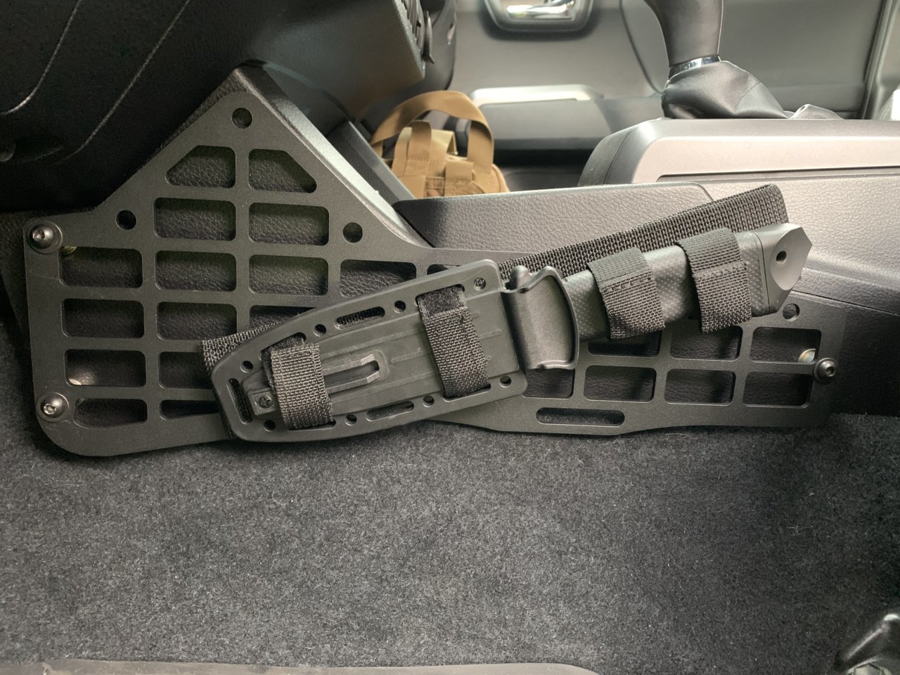

    These finally showed up today and I got right to installing them.
    The TL;DR about them is, "meh". If you need to mount something heavy in that location and it has to be MOLLE, this is your product, otherwise consider alternatives.
    Installation:
    If you have any mechanical inclination at all, you'll get these installed. It would probably be nice to include some basic instructions (plus parts list and tools needed) in the box, but again, it's pretty obvious how this goes together. I went ahead and watched the installation video but this was a mistake as the video actually includes a lot of wrong information about the tools needed. At least for my kit, I needed a 1/2 and 7/16 wrench (not a 5/8 and 7/16 as the video stated) and most importantly, while the video says to use a 7/16 drill bit, that is way to large and a 3/8 drill was more appropriate. My last issue with the installation is the location of the upper front bolt on each panel runs into some additional plastic support structure behind the plastic trim. This makes drilling difficult (and a bit scary -- "what is it back there I just drilled into!?") It seems this could have been avoided by moving the mounting hole about half an inch in any direction.
    Fit and style:
    The passenger side panel includes a bend in it that makes it fit the contours of the center console nicely. It would have been nice if the included spacers were black to match the panels, bolts, and car interior instead of raw aluminum, but that's a nit pick and can be resolved with some spray paint. The driver's side panel is for some reason lacking a bend and therefore sits somewhat oddly. You'll notice in my pictures attached the drivers side panel touches the center console at its peak, where as the passenger side panel remains nicely parallel with the center console. Construction of the panels themselves is good. They feel sturdy, but not overly hefty and fit the contours of the console (barring the above driver side issue) nicely. Paint is evenly applied and looks good.
    Function:
    These pretty much do what they say. I had no issue attaching MOLLE pouches to them, but keep in mind you are working with a very limited number of horizontal rows (as few as 2 on the ends) so some pouches may not be supported fully. That's the limits of the space to work with though. One of the selling points of these is the ability to easily unbolt and remove them to install pouches. That really is handy and much better than something more permanently attached you would have to try and fish the MOLLE straps behind while installed. I think it would be neat if the bolts supplied were thumb screws so you could remove them without a tool, but I suppose you aren't taking these on/off all the time. An even better option would be some sort of quarter turn fastener so you could quickly remove the whole panel; that would be handy if you kept a first aid kit or similar there you wanted to be able to quickly remove and take with you.
    Overall:
    The construction of the panels is good, but I don't see why the driver's panel isn't bent to fit the contours of the center console the way the passenger side is. The installation instructions left a lot to be desired, so my advice is to avoid watching the install instructions and just use your brain to figure it out yourself. Frankly, if I was to go looking for a new solution to mount just small pouches to the center console, I'd probably go with Velcro or a DIY fabric MOLLE panel. Where this product would really shine is mounting something heavier in that area: a full size Maglite, a large frame pistol, etc.

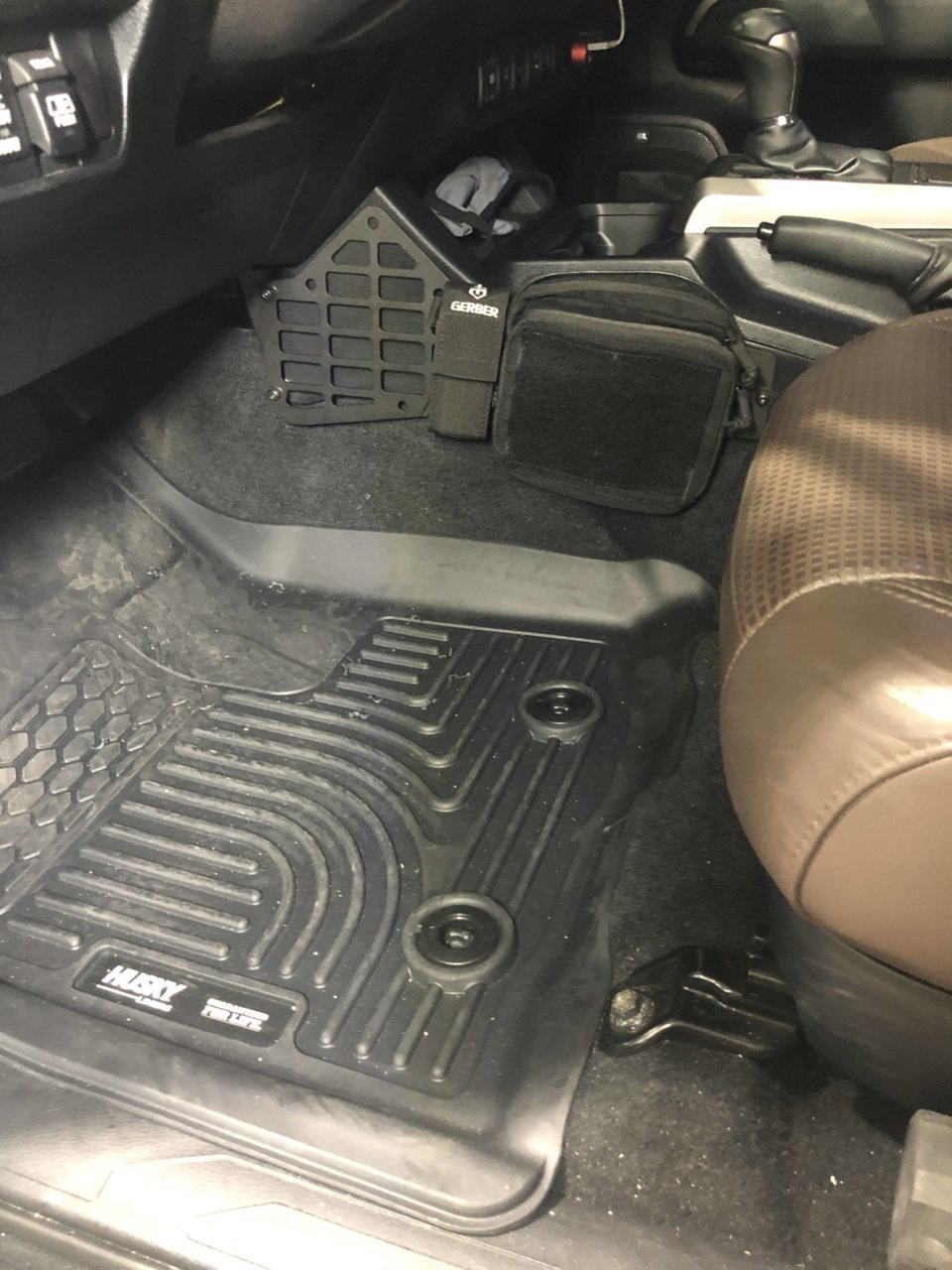

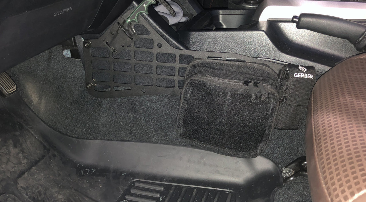

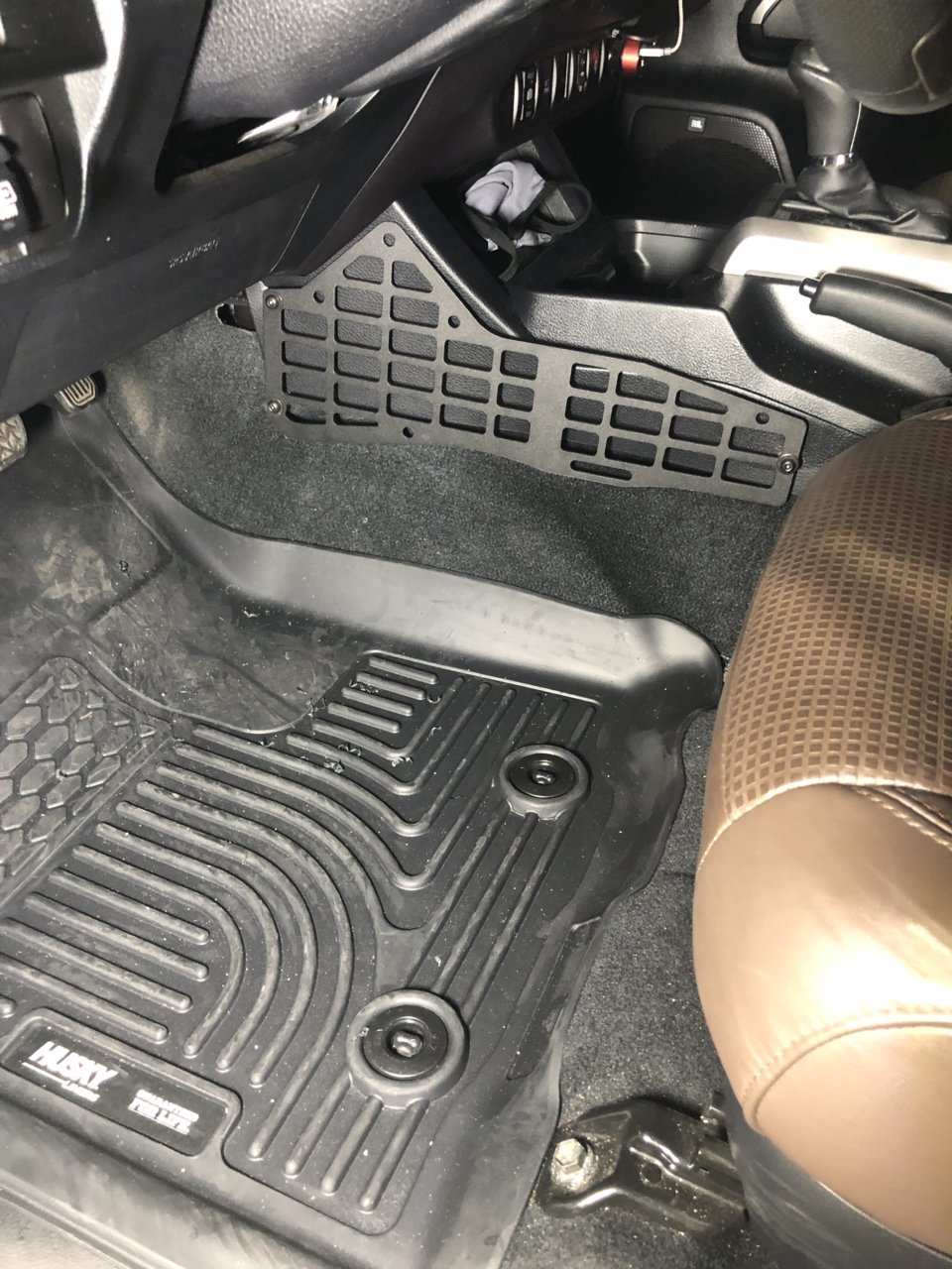

    I've been tweaking things since I installed the panels for this very reason. The panels themselves are not an issue, my leg never hits the metal. Once you start mounting things to the panels, those can get in the way. I've found I can only mount things on the rear half of the panel; anything mounted to the front half hits my leg.
    Here is where I ended up on the driver's side:

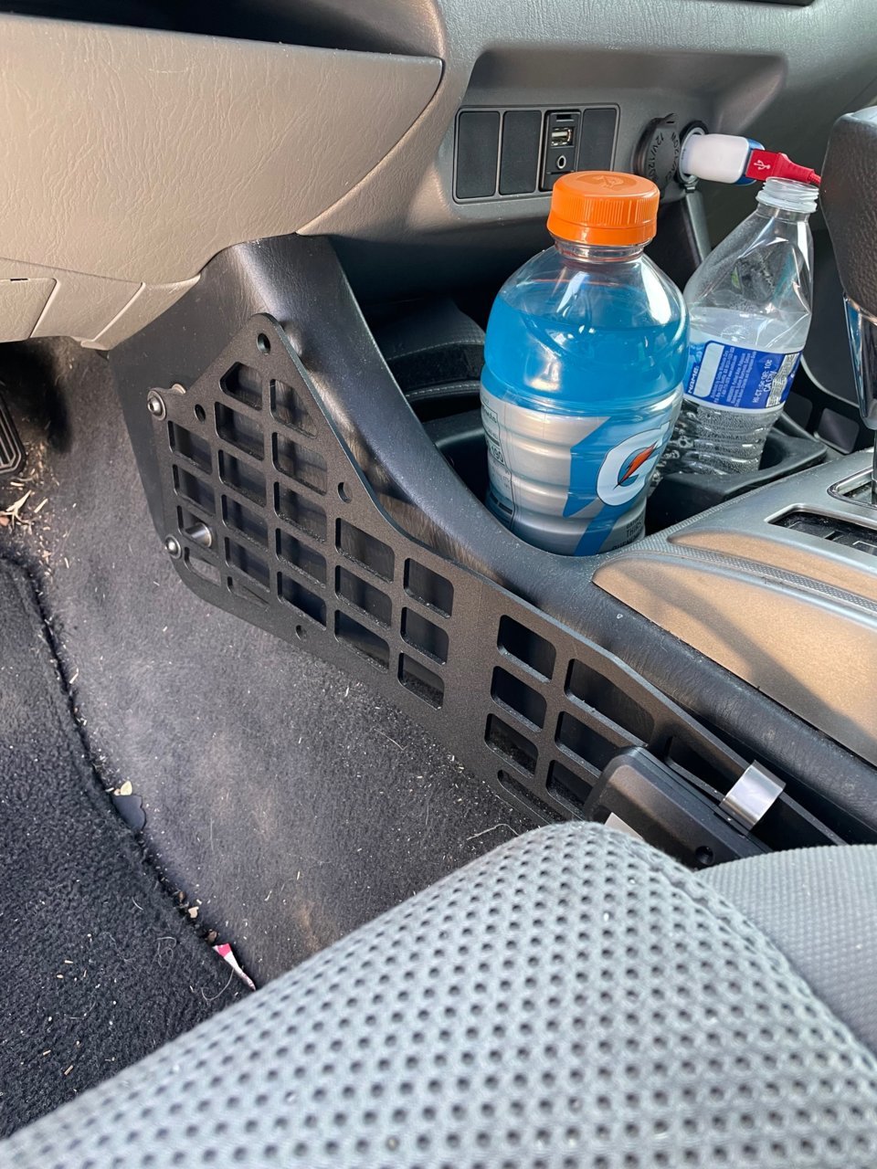

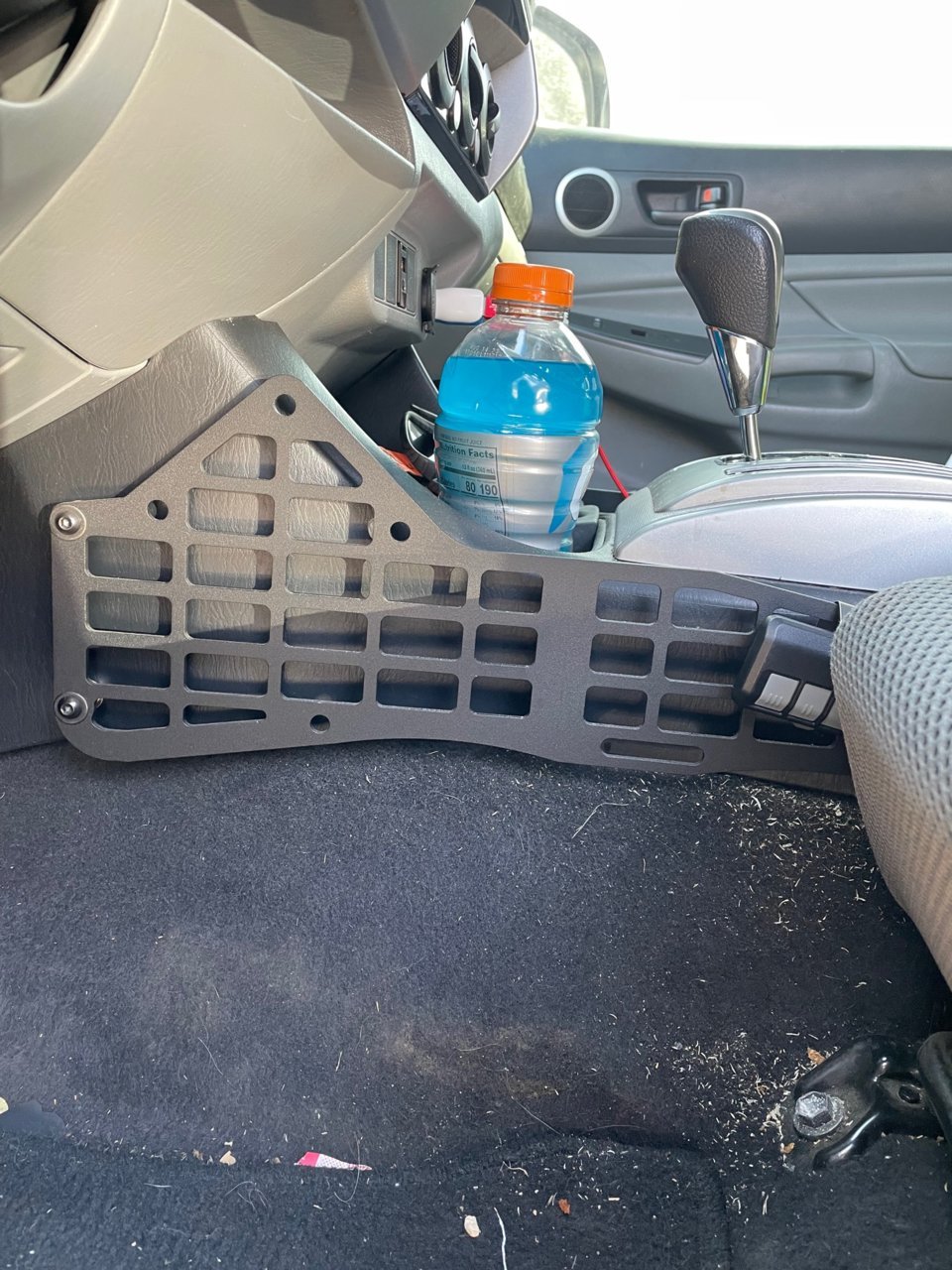

    Here are a couple of photos of the Center Molle panel on second gen! Let us know if you have any other questions.
