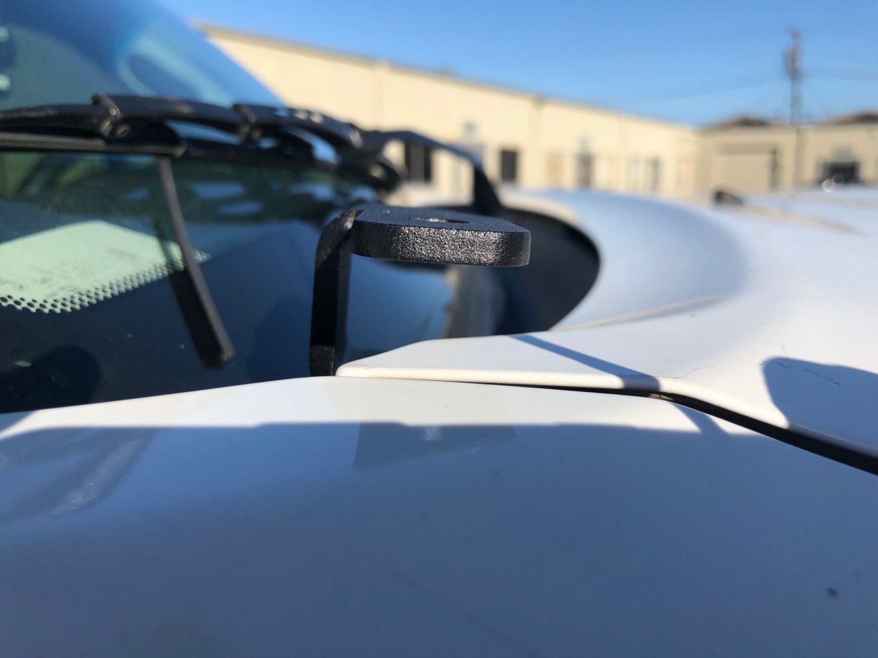

    Hello,
    What type of pictures would you like i have a ton that can give you reference

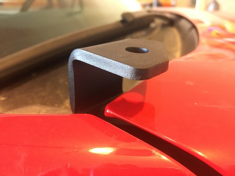

    If you have any close ups of the brackets on from different angles that would be cool but if not no worries. They were shipped and will be here this week, I’m real excited to get them on

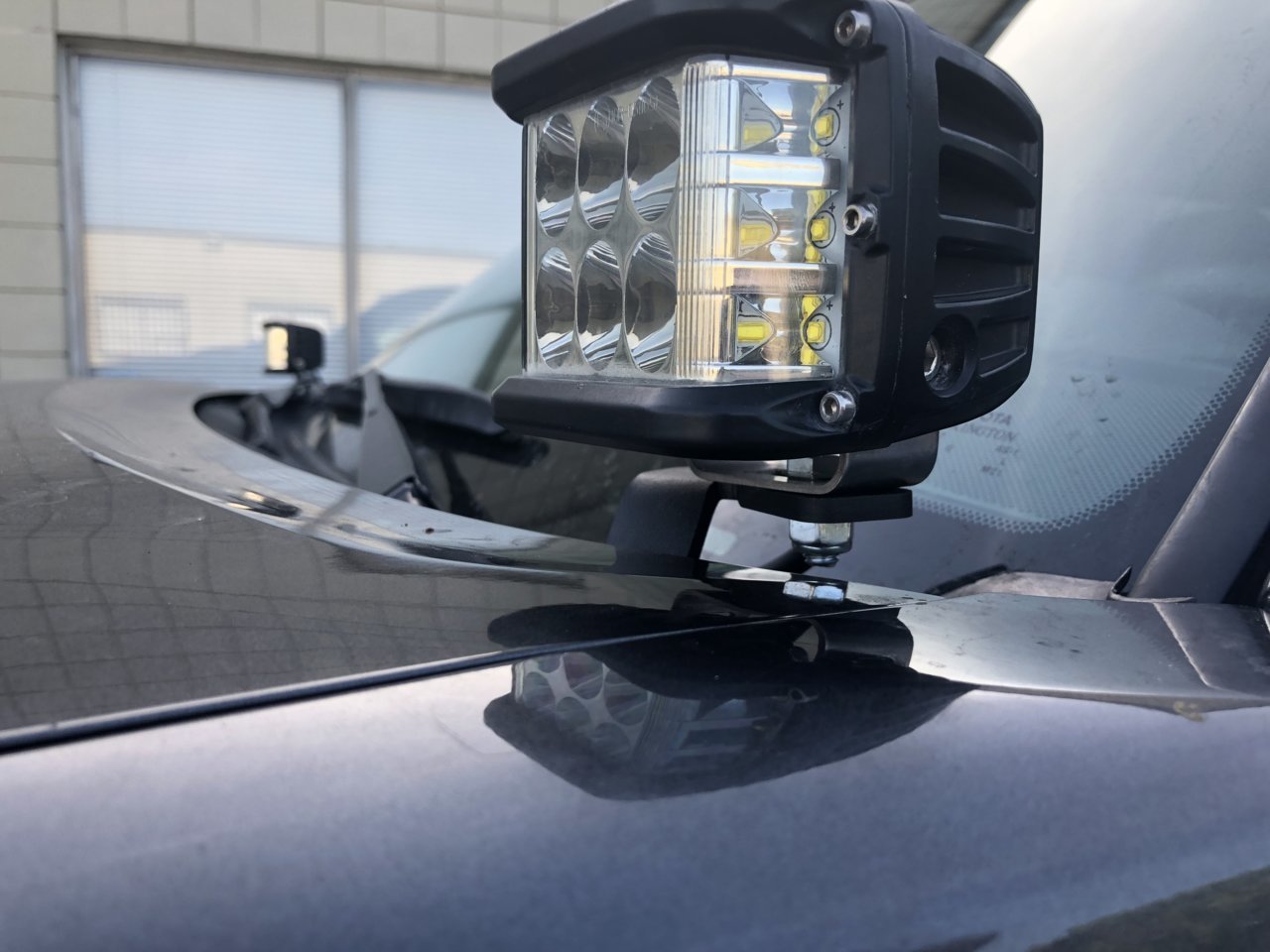

    Here you go! let us know if you have any questions!

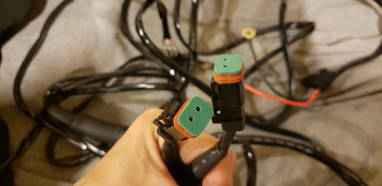

    Would you happen to know how to connect these 2 adapters? One is from a wiring kit and the other is from my ditch light

    A couple options.
    Cut connectors off both and use butt connectors/solder and heat shrink to join wires. Effective, cheap and any hardware/auto/walmart store will have the butt connectors.
    Cut connectors off harness side and use crimp on/solder on recepticle terminal that the blade will slide into. Effective, removable, cheap, any auto parts, most hardware/walmart store will have the connectors.
    Cut connectors off light wires and install correct deutch connector. I would go this route but it costs a little more and takes a little more time because you may not find deutch connectors locally. Effective, weather resistant, removable.
    Either way, soldering is better than just crimping. Any exposed connections should have marine/waterproof heat shrink.

    Cutting both off sounds like a good option. Do I really need to a solder? Can I just open the wire and mesh them together securely with a twist motion. Then heat shrink plus electrical tape, that should keep it tight in replace of soldering it rightttt?

    No, soldering is not required, but is better.
    You can just mush em together and hack job it.
    When your lights start flickering and having issues, remember to cut the wires and do it right the second time. Do it atleast half right the first time and use crimp connectors and marine heat shrink. I know from experience that wires and connections can corrode even when someone says they can drive through a lake without getting their engine wet.

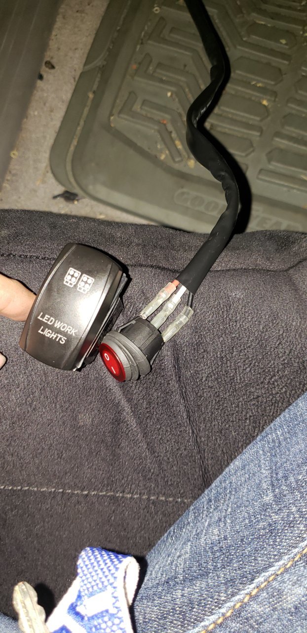

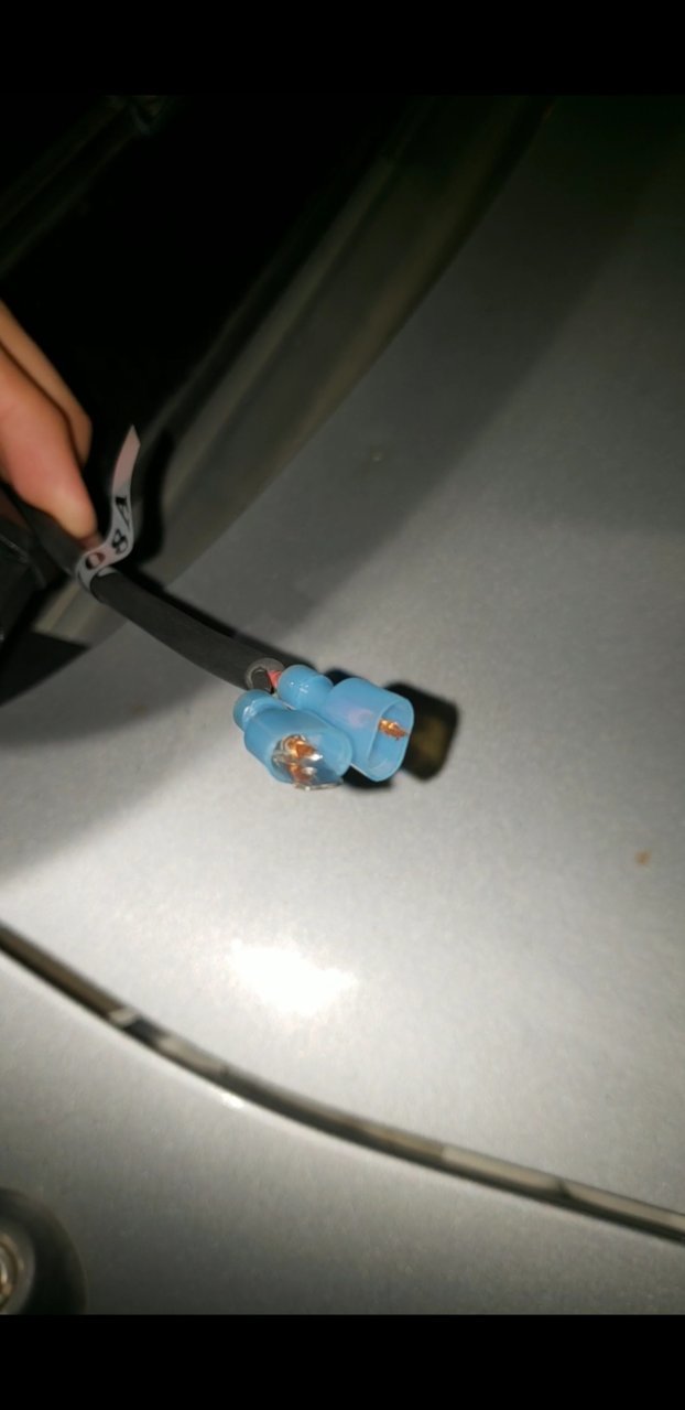

    Got my ditch lights hooked up nicely. However my Dutch harness is causing another problem.. The 3 female adapters for the switch are too small to plug onto an OEM switch. Can I just pry off the adapters on the end of the 3 wires and buy bigger ones so it fits or is there another way? 20181106_181046.jpg 20181106_181257.jpg 20181106_181401.jpg
