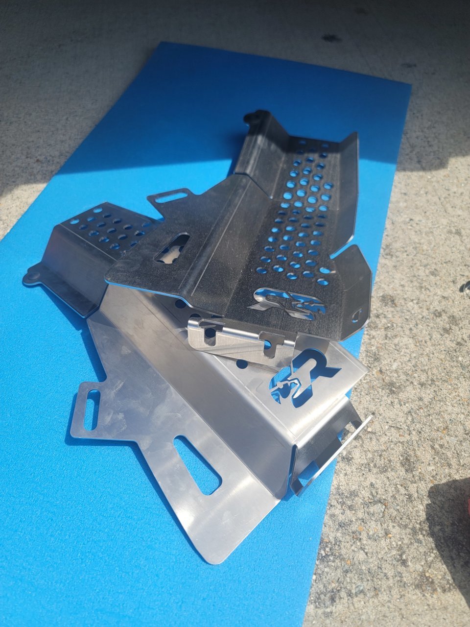

    I have a 23 offroad
    I followed the video to install it. The bolt holes just doesnt line up. The picture i circle is completely different than the one they have on the video. This is the new design of cat shield for the 16+ tacos

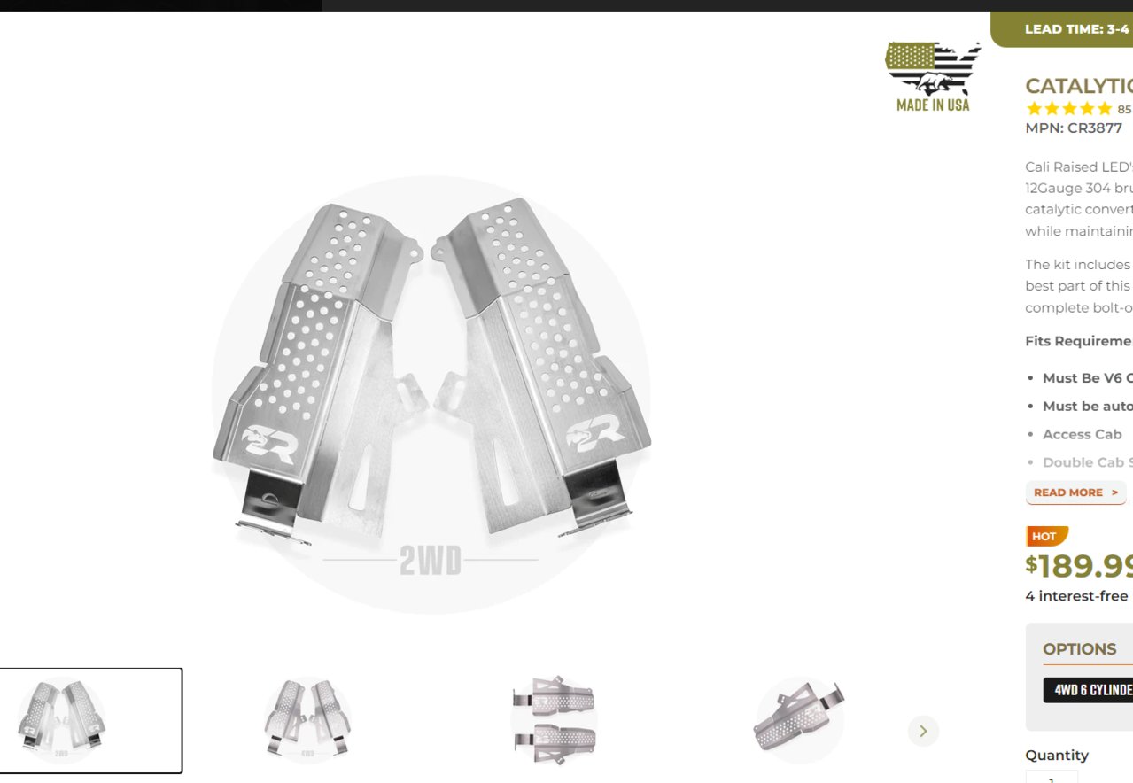

    BRO holy shit I just ran into the same issue. I got mine and I tried to put them on yesterday but the holes didn't line up and I went down the same road as you watching videos and I found what I believe to be the issue.
    They sent you and myself the 2 Wheel Drive versions instead of the 4 Wheel Drive version.
    I took the photo yesterday and I took screenshots of both versions of the shields because I was talking to another friend about the mess up.
    I went to CaliRasiedLED website just now after seeing your post again and for some reason the 2WD Cat Shield photo isn't there anymore...
    https://caliraisedled.com/products/catalytic-converter-shield-tacoma-2016-2022
    gr8-wrx and Xx_Evilvirus_xX like this.

    I've tried fitting it and holes he has circled in the original place don't like up with the ones on the frame no matter how far you try and crank it.

    I just got replacement 2nd version shields in today for my 1st revision that were making contact with the cat on the drivers side. I'm looking at my shield in hand right now and it has the exact same thing going on. The slot is at the wrong angle. I haven't gone out to try to install it yet, but this might be the case of mixed up parts shipping.

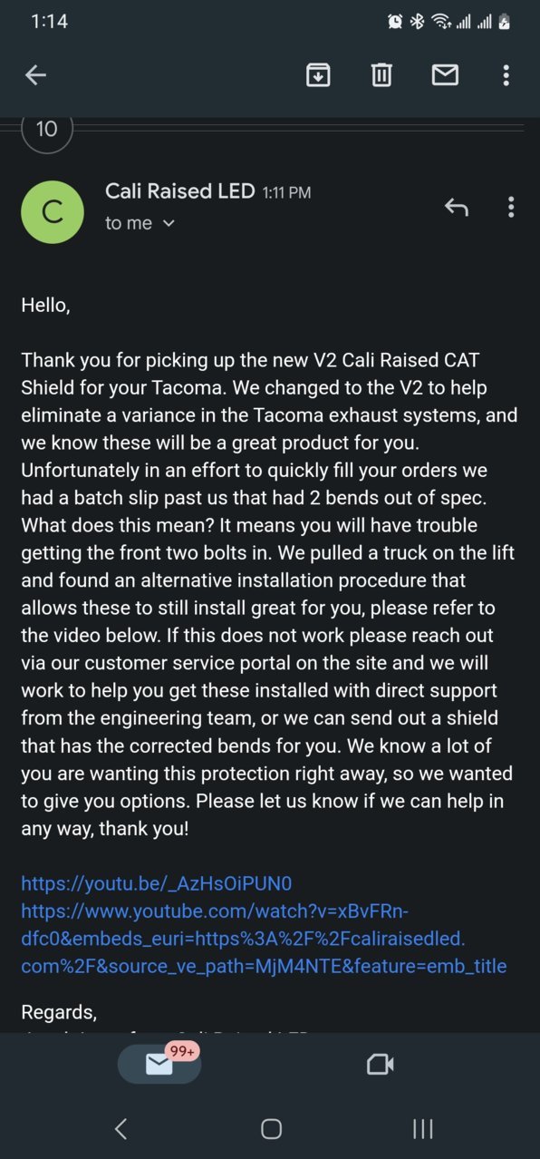

  13. Apr 3, 2023 at 10:16 AM
    ITmaD
    ITmaD Well-Known Member
    Feb 19, 2023
    #418333
    461
    Atlanta
    Update: a minute after I posted my last message I got an email from CaliRaised explaining what happened.
    Hello,
    Thank you for picking up the new V2 Cali Raised CAT Shield for your Tacoma. We changed to the V2 to help eliminate a variance in the Tacoma exhaust systems, and we know these will be a great product for you. Unfortunately in an effort to quickly fill your orders we had a batch slip past us that had 2 bends out of spec. What does this mean? It means you will have trouble getting the front two bolts in. We pulled a truck on the lift and found an alternative installation procedure that allows these to still install great for you, please refer to the video below. If this does not work please reach out via our customer service portal on the site and we will work to help you get these installed with direct support from the engineering team, or we can send out a shield that has the corrected bends for you. We know a lot of you are wanting this protection right away, so we wanted to give you options. Please let us know if we can help in any way, thank you!
    Here is the video like from the email
    https://www.youtube.com/watch?v=xBvFRn-dfc0&embeds_euri=https://caliraisedled.com/&source_ve_path=MjM4NTE&feature=emb_title
    gr8-wrx, stonebean[OP] and CenCal805 like this.

    The security bolt holes need to be slanted not flat like the picture ive provided.
  20. Apr 3, 2023 at 1:35 PM
    #20
    stonebean
    stonebean [OP] New Member
    Apr 3, 2023
    #421686
    4
    R be
    they got back to me i requested a new one being sent to me with the correct bends
