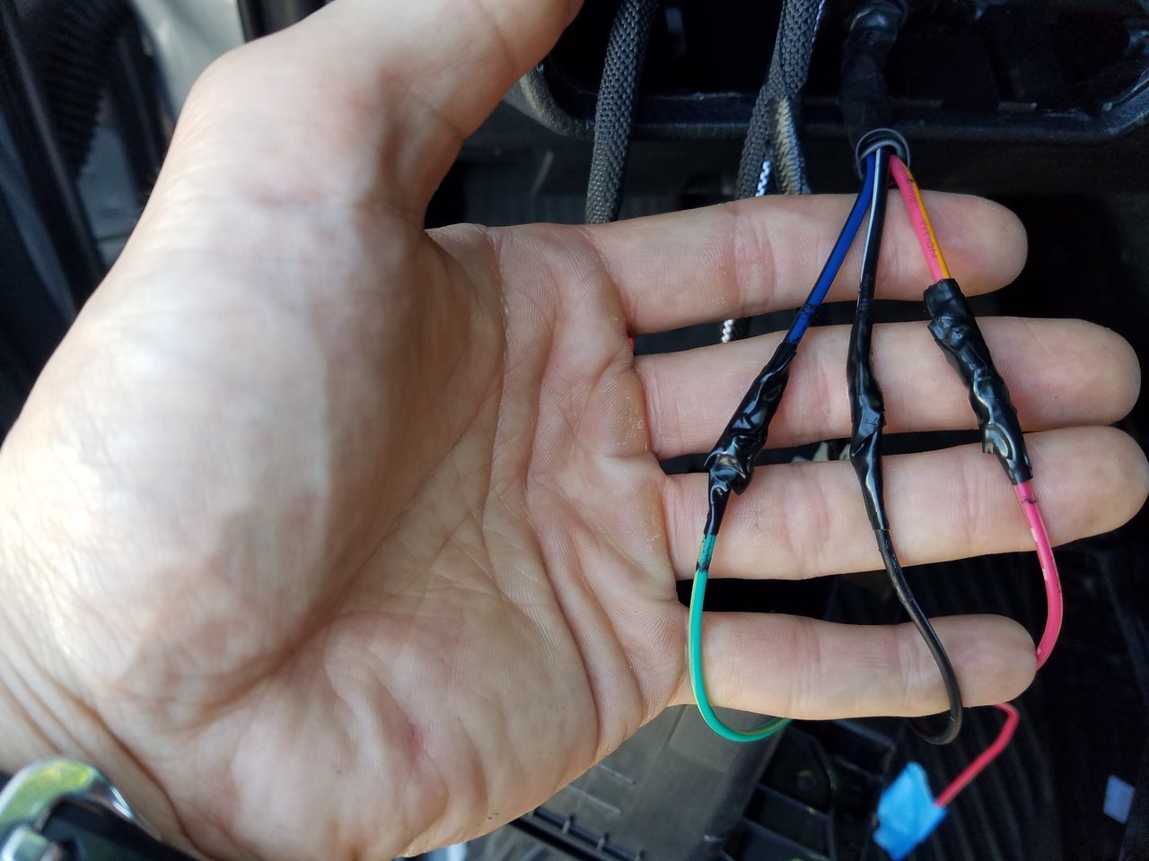

  10. Jul 23, 2017 at 10:16 PM
    trdsupreme
    trdsupreme [OP] Well-Known Member
    May 15, 2017
    #219069
    265
    2017 TRD OR DCLB Silver Sky
    So it turns out that the ditch light wiring video is not entirely accurate. When you receive the harness, the wires from the harness are not red, black and white. It's red, blue, and black.
    You will have to connect in the following manner;
    -black to black
    -red to red
    -blue to green
    Hope this helps with anyone else trying to install their ditch lights

  11. Jul 24, 2017 at 4:59 AM
    RIDERED67
    RIDERED67 Well-Known Member
    Oct 22, 2016
    #200382
    2,327
    2017 TRD OFFROAD QUICKSAND, DCLB, TECH
    Did you twist both red wires from the switch together?
    Does your switch stay lit all the time?
  12. Jul 24, 2017 at 6:01 AM
    17tacosport
    17tacosport Well-Known Member
    Jan 5, 2017
    #206658
    343
    Hasmeet
    Buffalo,NY
    2017 MGM Tacoma DCLB 4x4
    Doesn't look like he did
  13. Jul 24, 2017 at 6:20 AM
    Clearwater Bill
    Clearwater Bill Never answer an anonymous letter
    Oct 11, 2014
    #140097
    24,459
    Billy
    Largo Florida
    '13 5 lug AC w/convenience package
    A few OE parts from fancy trucks
    You might consider removing that glop of tape and using heat shrink to protect your connections.
    The tape is already in a mess, and will get worse with time and heat.
    It's cheap and easy.

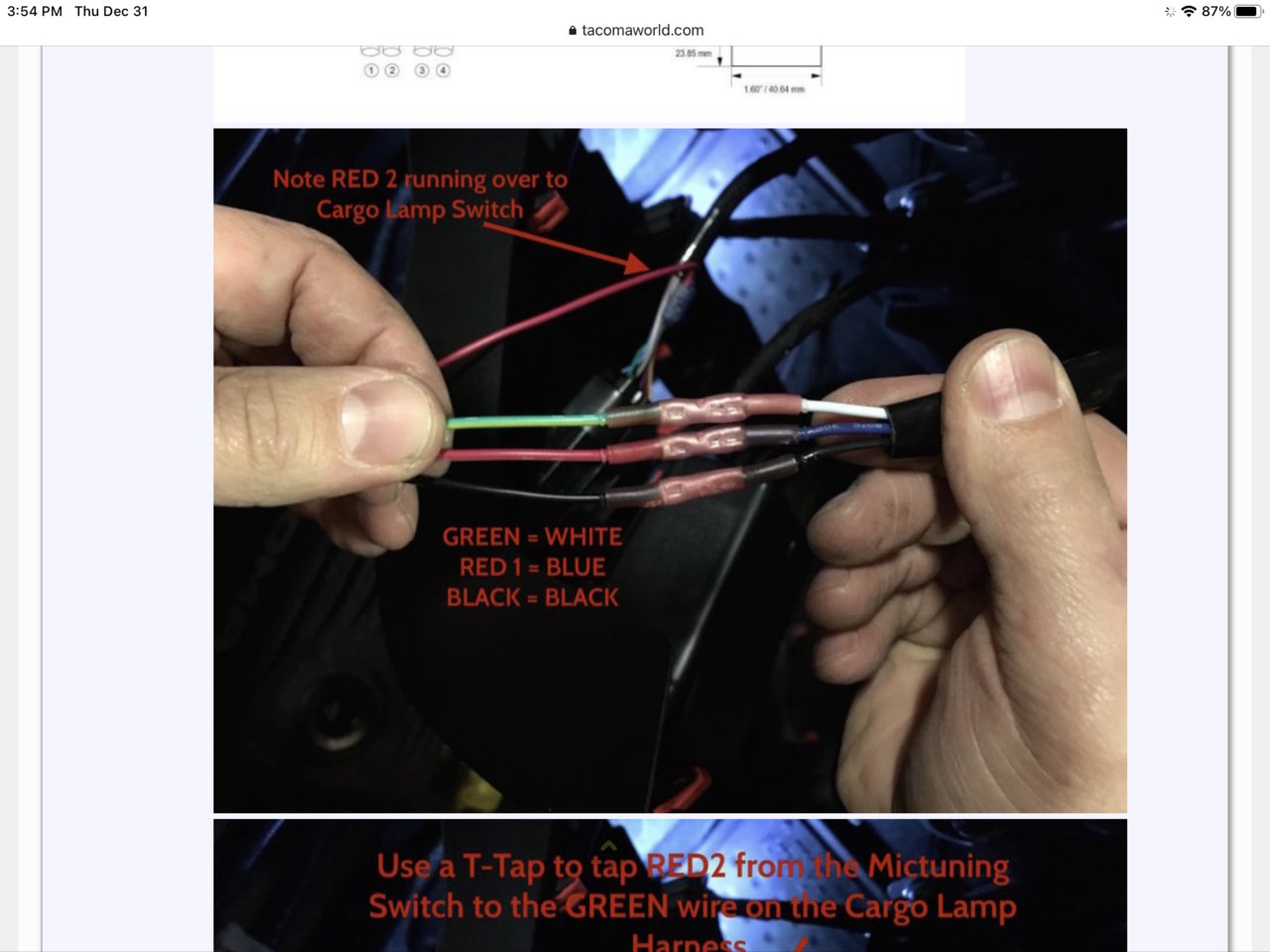

  16. Dec 31, 2020 at 2:00 PM
    #16
    Mcluvin737
    Mcluvin737 New Member
    Dec 31, 2020
    #351207
    2
    I had a similar issue with a Mictuning 4 wire switch. I went by Post number 131 here https://www.tacomaworld.com/threads...lush-for-3rd-gens.406964/page-7#post-11711409. Seems easy enough except that my light bar relay and switch has a red wire instead of blue. Easy I thought, black to black, white to green (like the picture), and red to red1 (in addition to red2 to dome light green wire). Wrong! The blue wire isn’t the same as the red wire on my switch. If you wire it that way you’ll blow the fuse in the relay. Correct answer turned out to be black to black, red to green, and white to red1. So I had the red and white wires opposite of the way they should be. Only took an hour to figure out my mistake! Lol
