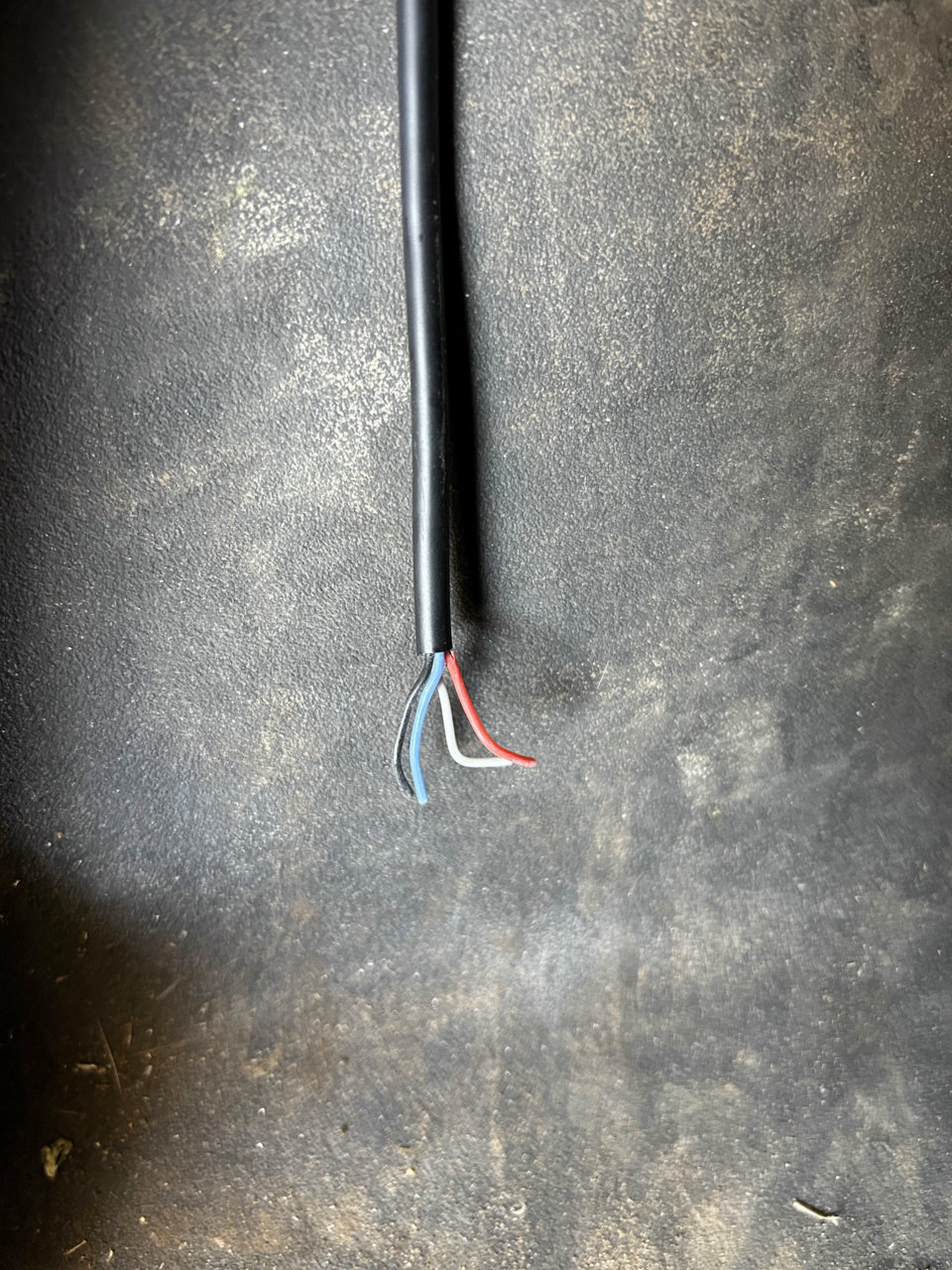

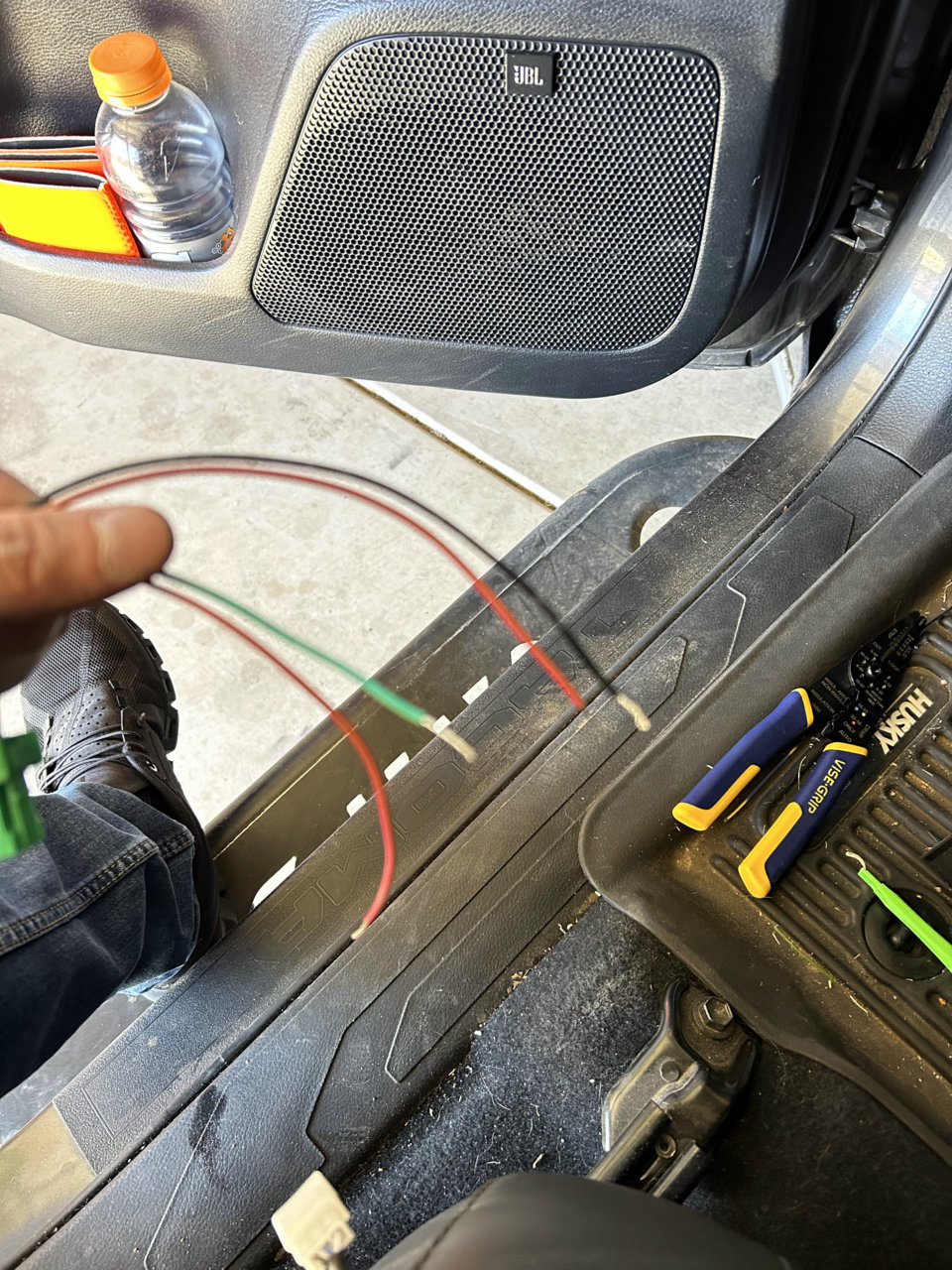

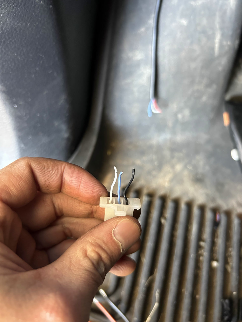

    Hello, I followed the directions to a T.
    Now doing the switch install. Unplugged the rocker switch and cut the wire before the connector to expose what should be 3 wires per their videos, but instead I see a 4th red wire. How to I make this connection?

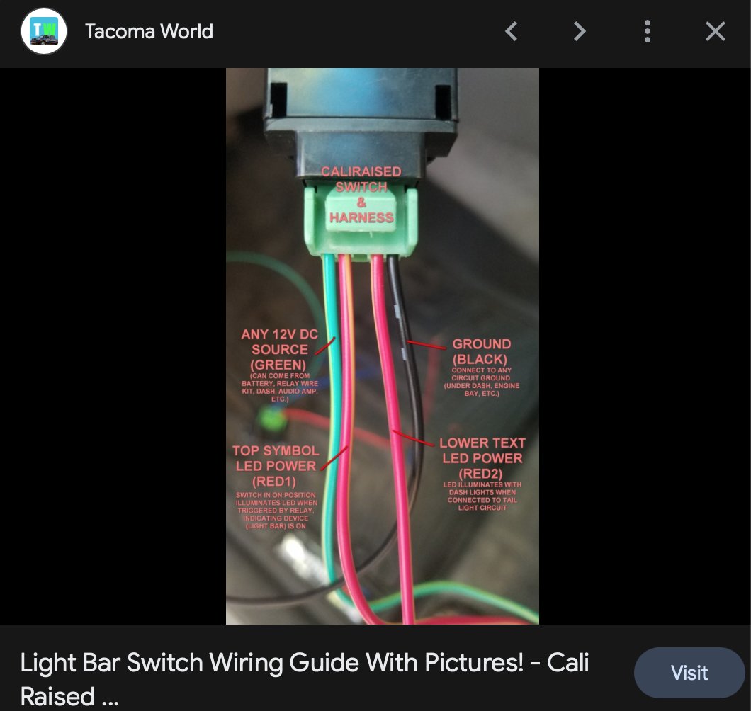

    Did you check the wiring diagram on the back of the box? On of the wires should be for switch back light.
    https://www.tacomaworld.com/threads...res-cali-raised-air-on-board-switches.617047/

    Theres no instructions, everything refers to the cali raised website. Its there dual leg harness
    https://www.youtube.com/watch?v=W4MXEJpedrM
    The wires they are exposing look a lot thicker than the ones I have exposed

    Hey @AZ_J were you able to get your switch wired up? The red wire coming from the wiring harness is no longer needed when installing the OEM switch, it is only used for the switch that came with the wire harness.
