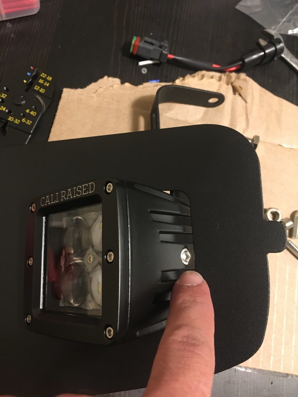

    Okay, so I cannot get the light tightened to the fog light mounting bracket. I didnt Get any instructions in my package, which really pisses me off, nor can I figure out how to assemble the damn things. The ditch lights and mounts went together easy enough but these are giving me fits. I’m pointing to the bolt I cannot Get tightened. Oh, and don’t say it’ll tighten once the nut is inside the housing because NO THE FUCK IT WILL NOT. Maybe they sent the wrong hardware?
    @CaliRaisedLed why didn’t you at least include instructions on how to mount the lights to the brackets? Was that a mishap? I wouldn’t be so mad but I took My OEM fogs out and there’s no way I can Get that screw back in without taking off the fender liner. So pissed right now. Going to bed and will try again when I get Some answers.

    For clarification, the nut within the housing just spins and spins.

    I used a butter knife to get the nut lined up with the screw in the housing and then it all just tightened down no problem.
    Are all of the nuts not tightening down, or just on that side?

    @Midknight none of the bolts for the fog lights are tightening down. I think They sent me the wrong hardware kit, maybe? The ditch lights went together no problem

    Can you post a photo of the nut in the fog housing?
    The way it should work is where the nut fits in doesn’t allow it to spin. Once you get the bolt threaded into the nut it should tighten because the nut is prevented from moving.

    I know I had issue getting space to tighten that particular nut. The bracket face and the nut sit perfectly aligned to where nothing can get between them to tighten the nut. It was a pain in the ass at the time.
    Recalling from memory of my install experience:
    I believe I had to do that nut first, then the other side, and then attempt to finish tightening this nut again. When you tighten one side, the other side starts to align to the face plate. It was almost a balancing act on how much to tighten one side before the other side's nut become inaccessible due to the bracket face plate; just a constant back-and-forth. It felt like a poorly thought out design.

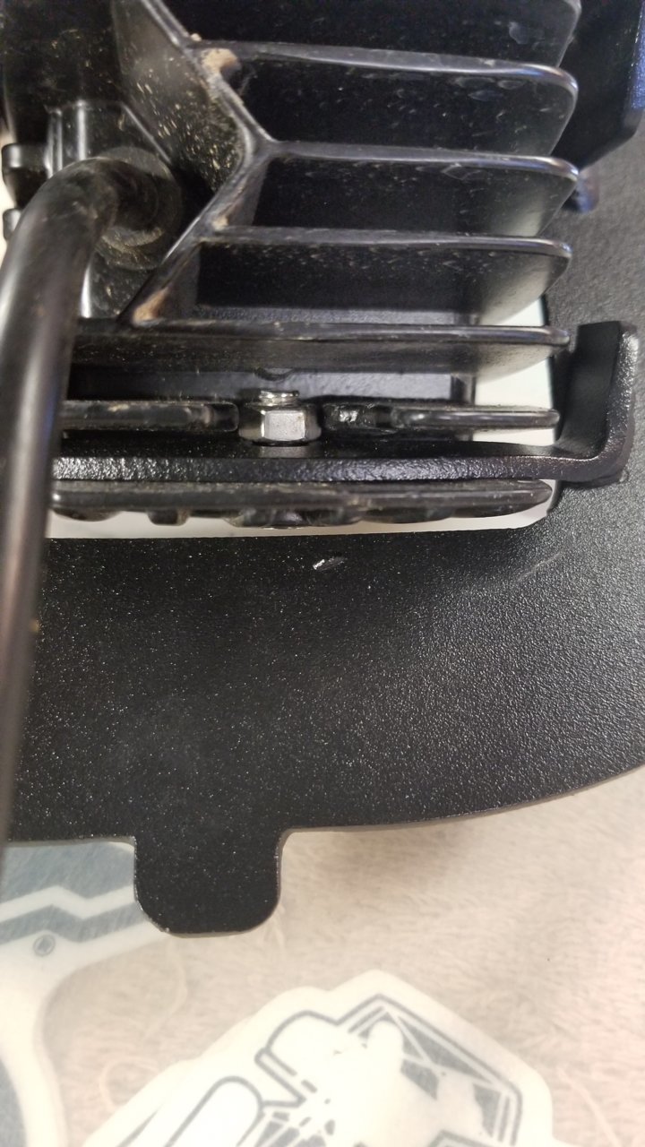

    Should look like that on the inside to keep the bolt from spinning
