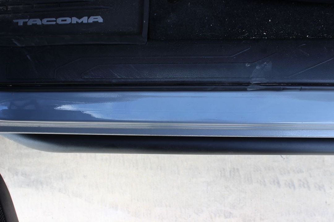

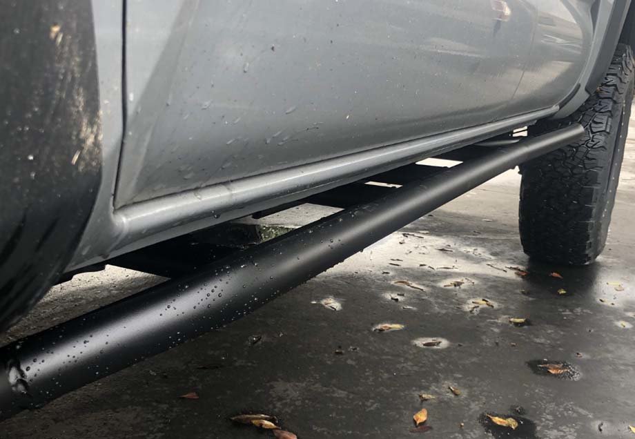

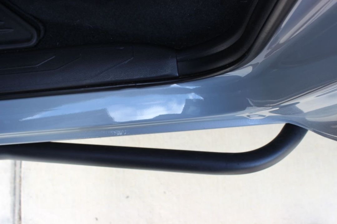

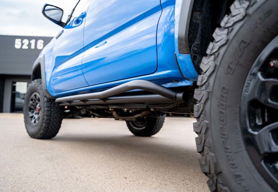

    I completely miss read the question. So the 25 degree will stick out 3" and the kick-out is around 4.5". I will send you photos so you can see what it looks like! 2005-2021 Toyota Tacoma Trail Edition Rock Sliders02_0000s_0008_Raw_5 (1).jpg 2005-2021 Toyota Tacoma Trail Edition Rock Sliders02_0000s_0003__DSC5509.jpg 2051B128-FDF0-4694-AE4A-6B0334CD1345.jpg 0BE94639-E981-402D-9DF8-E373936CA563.jpg

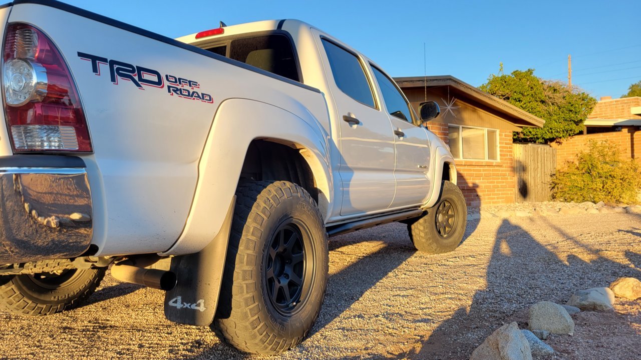

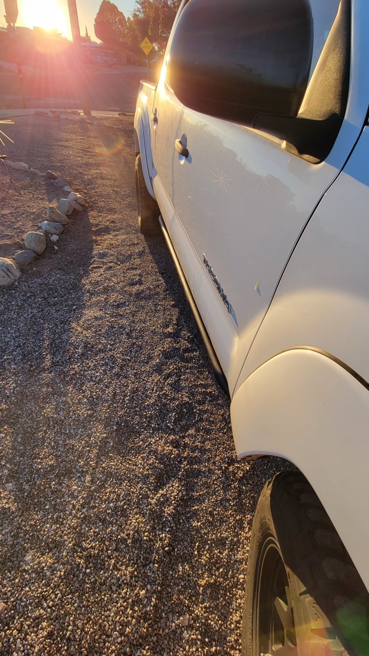

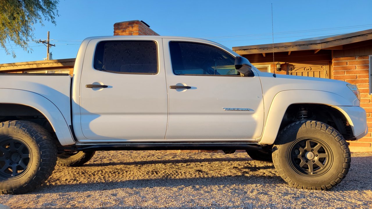

    Yay, finally able to get mine installed. Very easy for sure. Love the fit and look.

    Dang those are clean!!

    Looks great!!

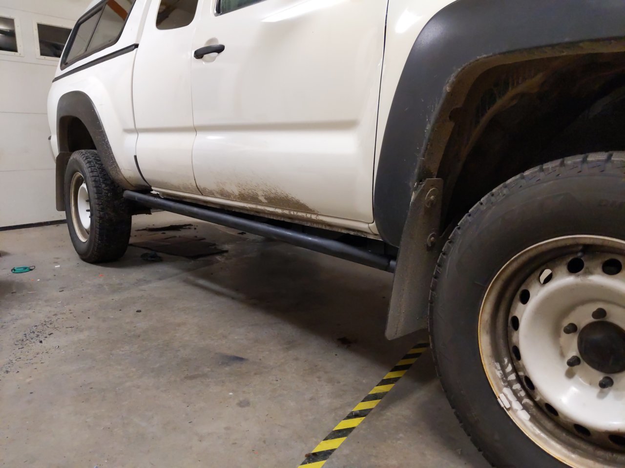

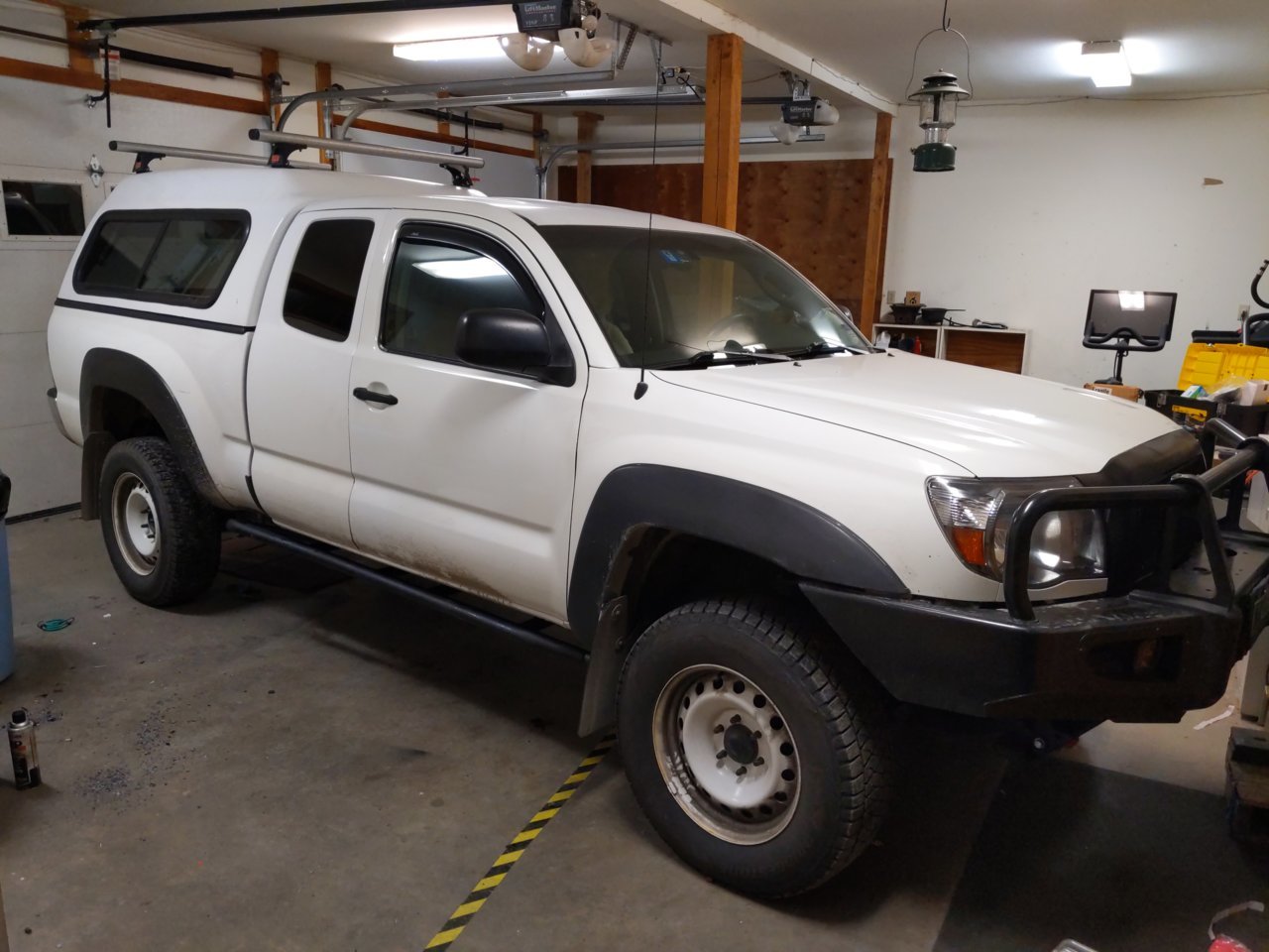

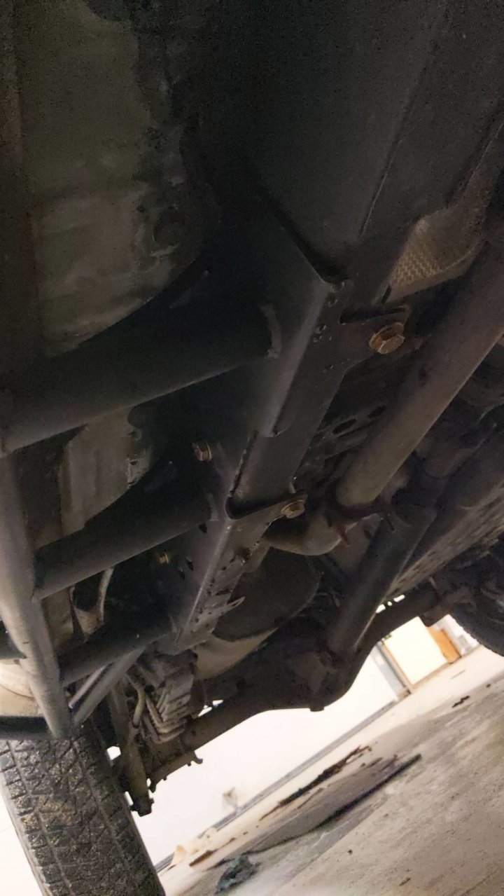

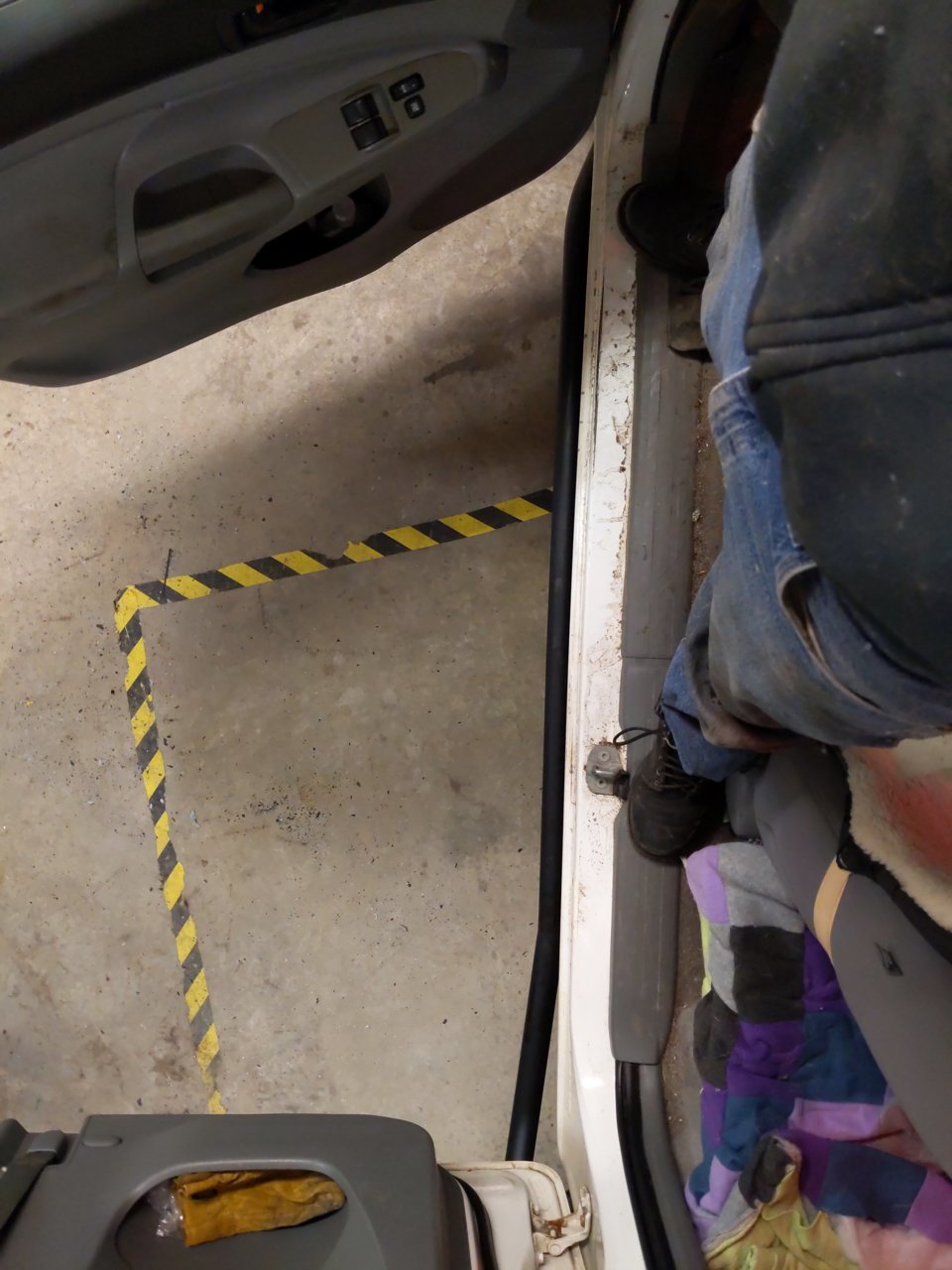

    Just finished install on an 09 Access Cab.
    I used all of the frame inserts on each side (the ones I think are referenced as "optional" in the instruction bid), but my AC does not accommodate the rearmost frame clamp. I'm not particularly concerned.
    Extremely low profile. If you creep through tight spaces or just don't like the step look, these are good to go.
    Nice hardware, great fit, and absolutely worth the money.

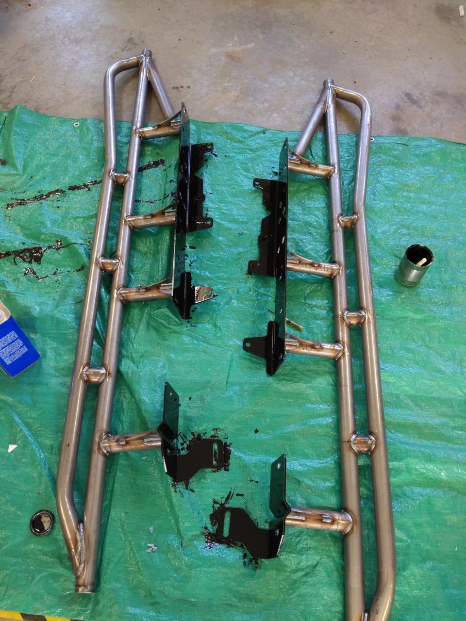

    Random detail shots:

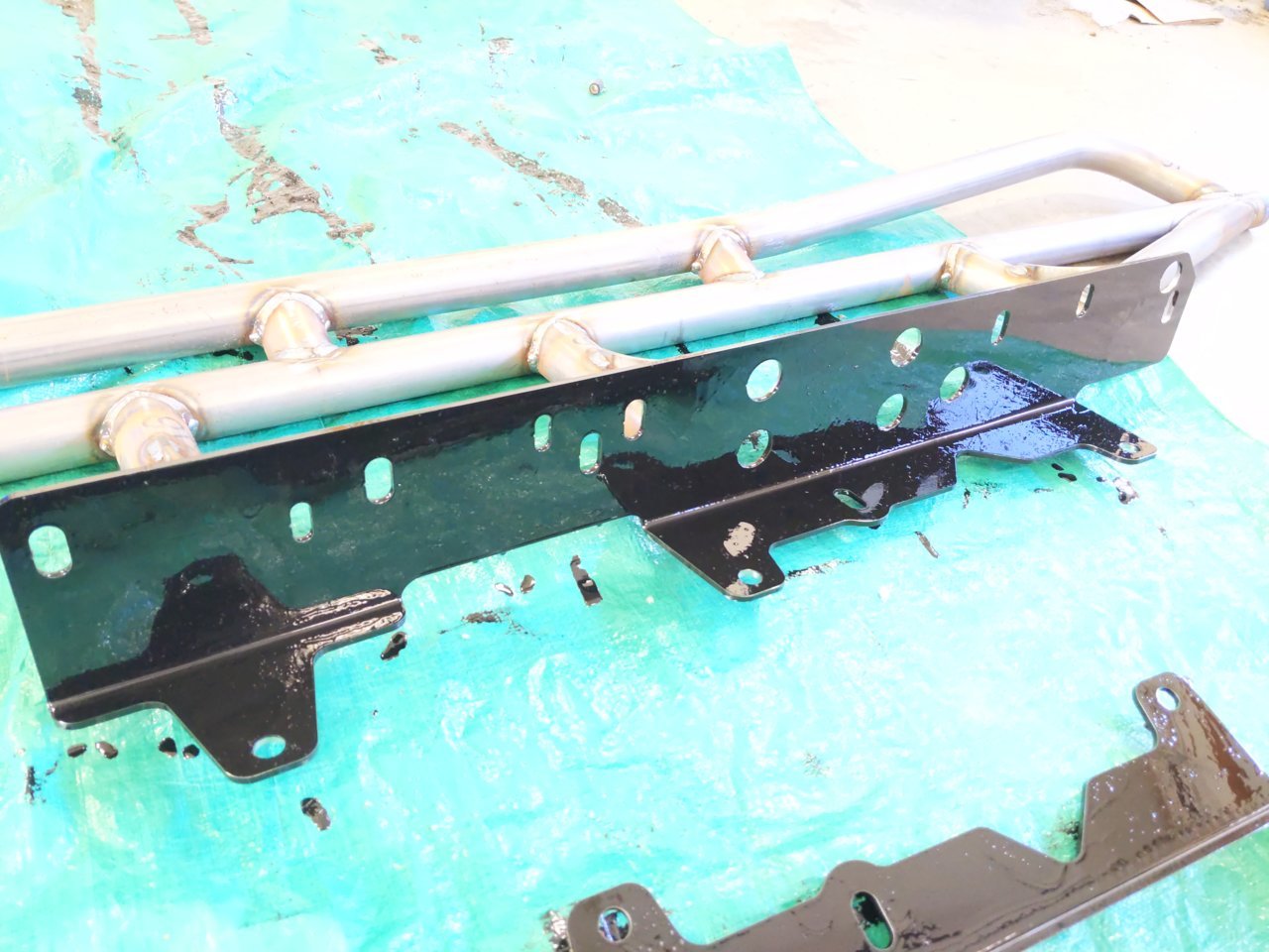

    POR-15 on interior of all mounting surfaces:
    Rearmost frame claw (???) not used on this 09 Access Cab. Four rectangular plates used. My frame is a little munged so I had to tighten everything up out of the recommended order to pull everything together:

    They're bare steel. FWIW I painted mine with a couple coats of black rattlecan and then hosed all of the mounting hardware off with Amsoil HDMP. If you wanted to go the extra mile, POR-15 the inserts and use HDMP (or FF or cosmoline or whatever you want) between the inserts and the frame.

    The stuff I used on the insides of the brackets on the sliders (and on my frame) is the POR-15 Rust Preventer. It comes in a couple different packages, this is a random one just so you know what product I'm talking about - https://www.amazon.com/POR-15-45006-6PK-Gloss-Preventive-Coating/dp/B00J2VULQ6/
    The Top Coat goes over POR-15 anywhere it will be exposed to heavy UV (direct sunlight) and isn't necessary inside the frame rails.
    POR-15 is probably overkill for the backing plates and slider brackets, but I had some leftover from doing my frame and frame plates.
