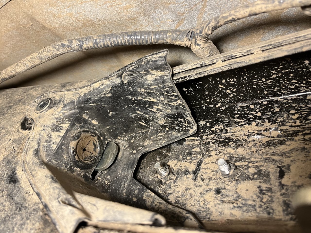

    Pardon my dust, but I just wanted to share an idea I came up with while installing these. The install video did not suggest to re-use our frame covers, and I didn't like the idea of the box section wide open after install. I was able to slot where the nut plate handle protrudes and was able to re-use the covers! With a little bit of motivation, I was able get it fastened back down into its factory hole.
    P.s. - Yes, I made sure thoroughly clean where the sliders actually mounted up, don not worry.

    Yours looks cleaner (the cut) than mine.
