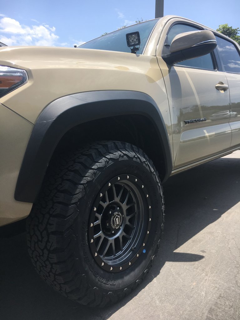

    2017 DCLB TRD OR 4x4 QUICKSAND
    Still not welded, but they're on the truck and lookin good.....

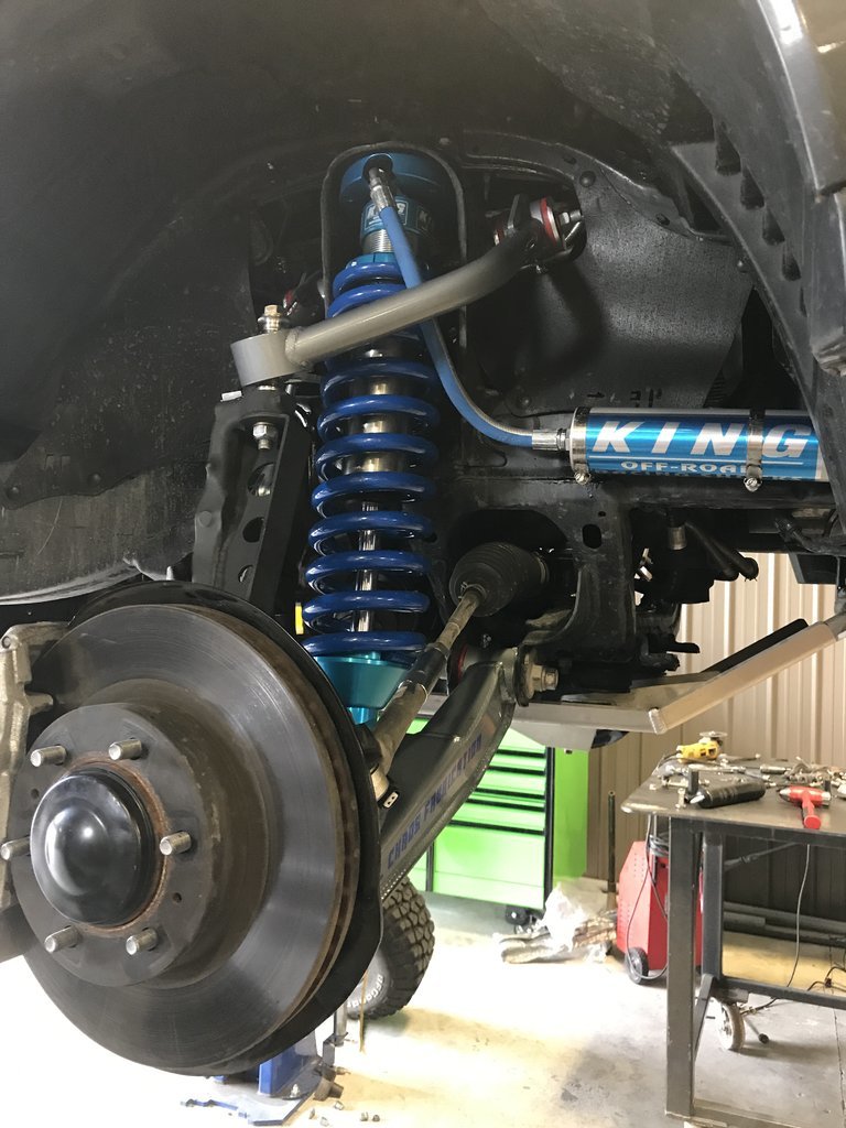

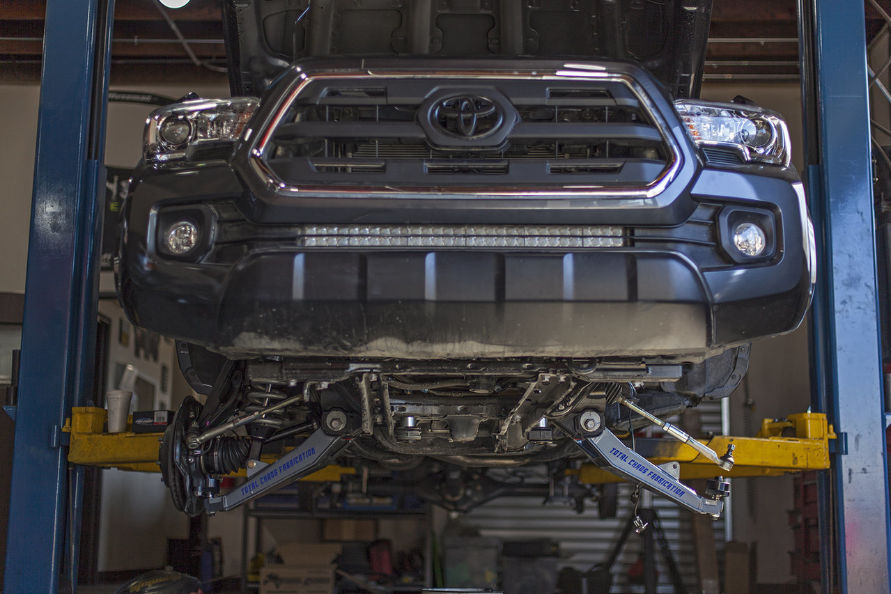

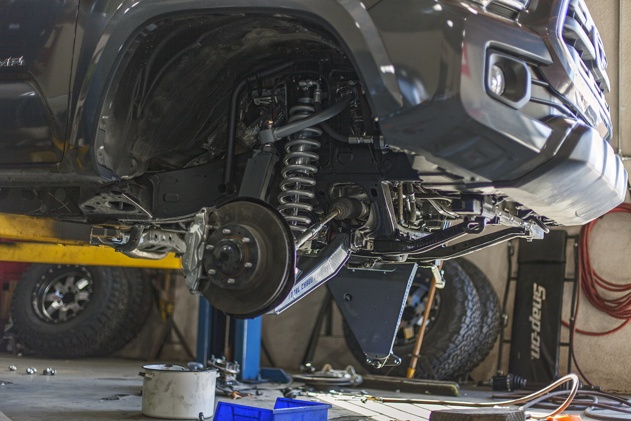

    Got a lot done on the truck yesterday. Coil-overs mounted and 2nd shock hoop installed. Ready to install the bypasses today. :bananadance:
  6. Jul 27, 2017 at 9:06 AM

    Gary at Desolate Motorsports Installed them. He installs this kit quite often so he has it down. Overall its not too bad

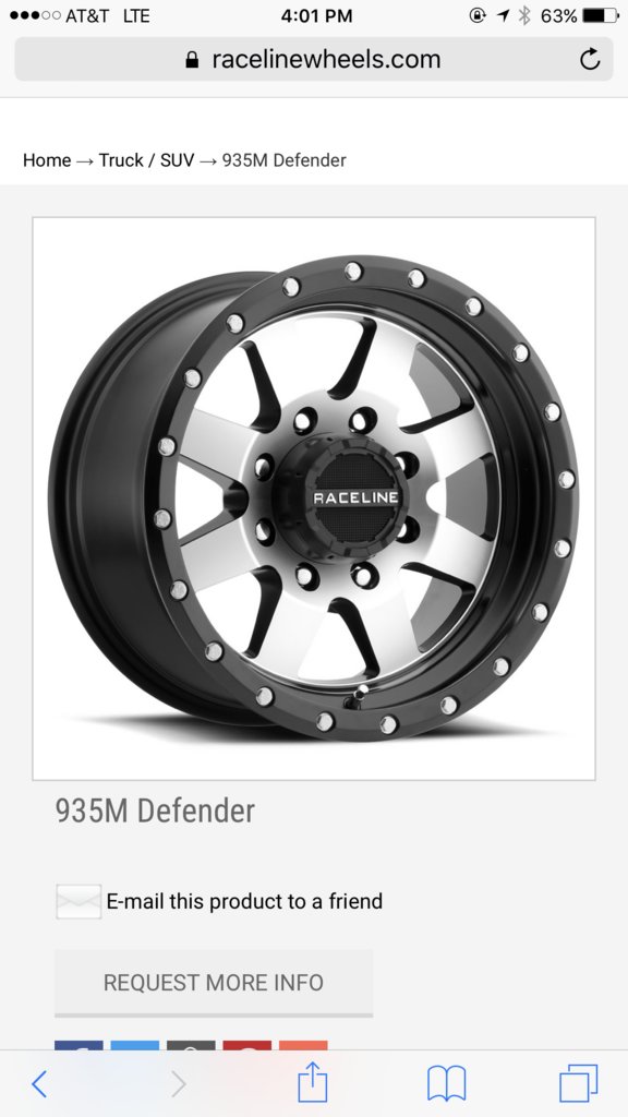

    Bilstein 6112 front, 5100's rear with blocks, camburg UCA, 17" XD's with 285/70/17 AT 3's and a blackout front grille.
    Beauty of a suspension. What brand are the rims and do you know the specs?

    @T-rev mine unsplined at a cun* hair over 30tons of force. When total chaos says you need a 20ton press to install them they were not kidding... suckers are really in there!
    @CaliRaisedLed are your spindle gussets different than the total chaos ones? Mine look way different. IMG_1246.jpg

    Good to know. Just trying to figure out if this is something I can do myself when the times comes. I've installed or at least worked on everything front suspension wise minus replacing axle shafts or messing with tie rods.
    It looks like you have the non-sway bar version of the spindle gussets, is that right?

    @T-rev yes I do but with long travel suspension the sway bar will not work. So I'm just curious what @CaliRaisedLed has because the sway bar spindle gussets w/ sway bar mounts that total chaos sell wouldn't work with the +2 kit. And the axles are a bitch and there is a lot of welding so keep that in mind!

    It looks like OP has the sway bar version. From what I understand the sway bar version still works on LT setups, they just can't use the sway bar.

    We are using Raceline defenders. 17"

    The spindle gussets are from Total Chaos

    Sway bar has been removed
