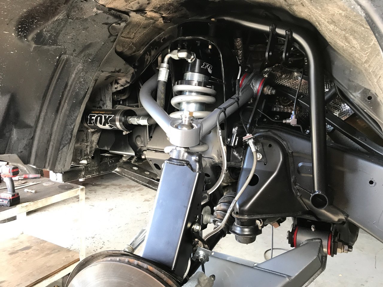

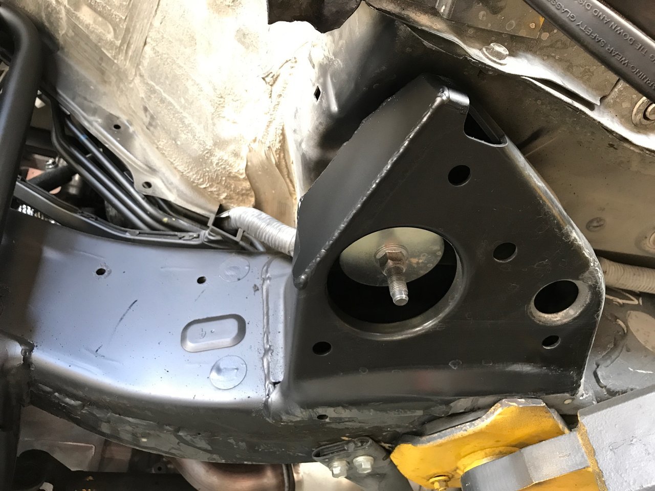

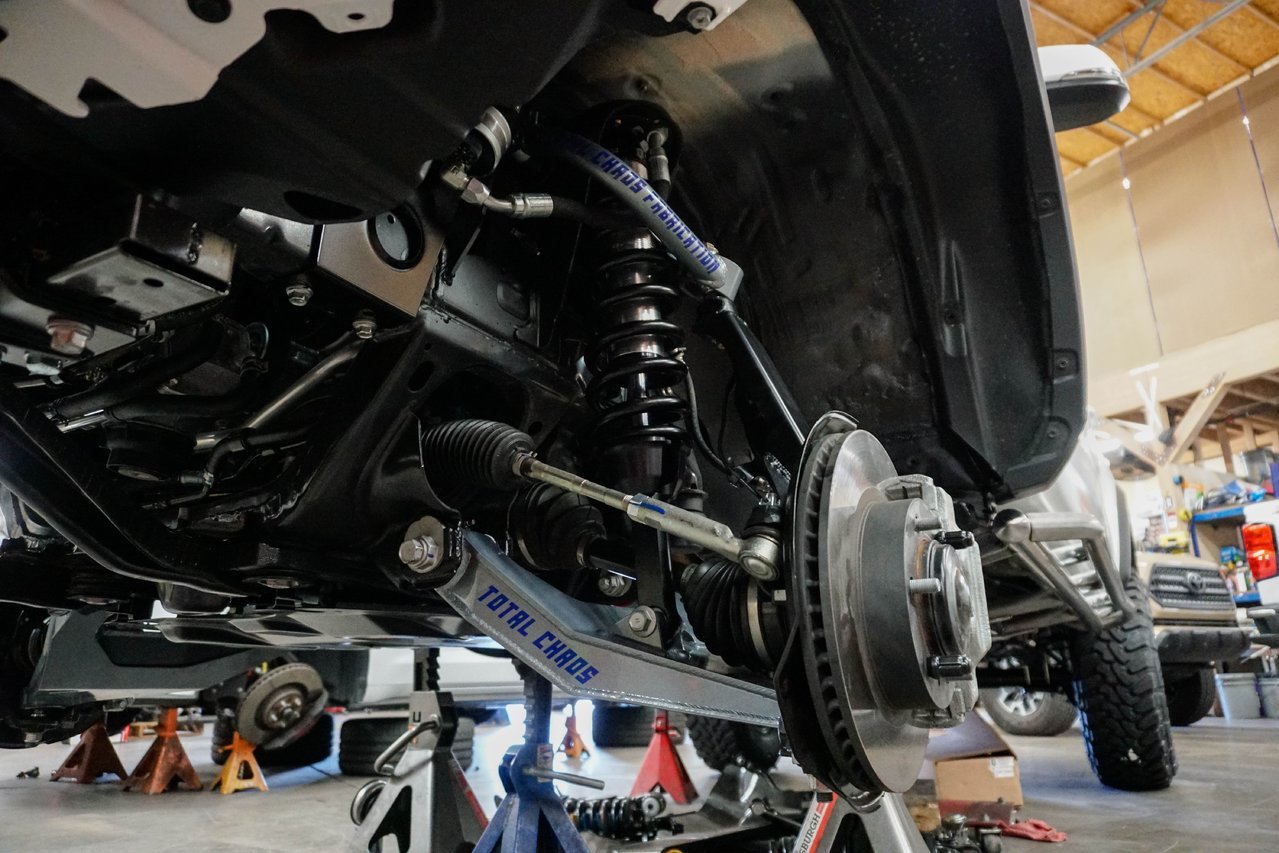

    Finished the spindles and cab mount chop
    Couldn't mount the bypasses as Fox sent the wrong misalignment spacers so we'll have to finish up mounting the bypasses next week.

    Clean Chop. I was wondering how you would fit 17x9 wheels and 285 tires without doing that.

    Ya, Gary over at Desolate Motorsports did a great job.:)

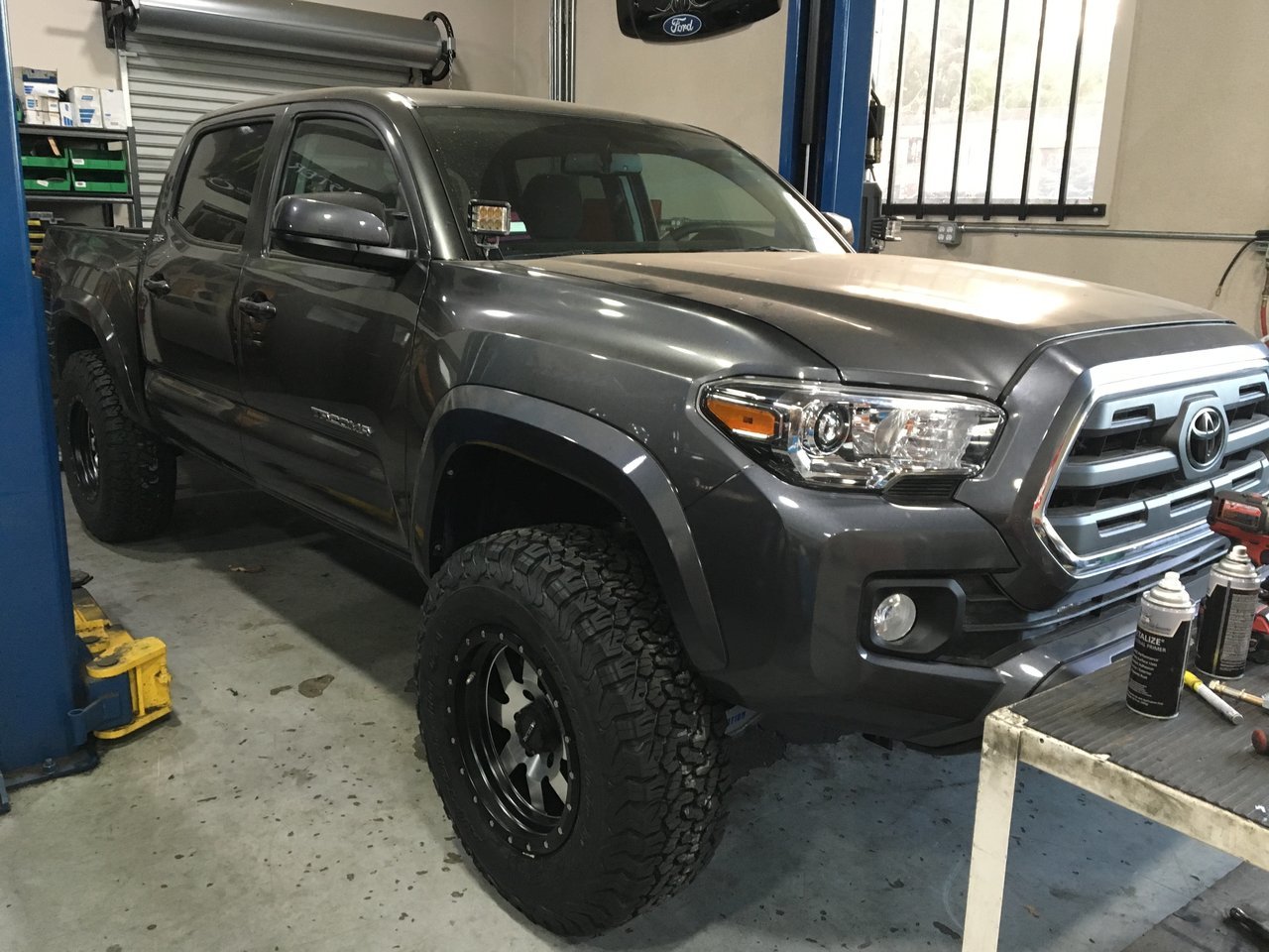

    That actually looks pretty good without fiberglass! Do the tires clear the fenders?

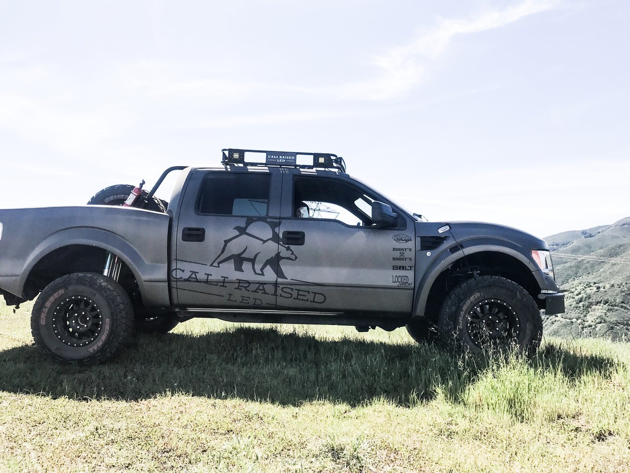

    I agree. Went with the +2 kit because I hate fiberglass. We have a fully caged LT f150 that has all fiberglass and it's awful

    This is the truck with all the glass. And to answer your other question yes everything clears

    As far as the suspension Here is the links to what is going on the truck if your interested in checking it out.
    UP FRONT:
    - http://www.chaosfab.com/2016-2017-Tacoma-2-Race-Series-Long-Travel-Suspension-Kit-86002T-R-16.html
    - http://www.chaosfab.com/2016-2017-Tacoma-Long-Travel-Axles-86305T
    - http://www.chaosfab.com/2016-2017-Tacoma-Weld-on-Spindle-Gussets-59698
    REAR:
    http://www.chaosfab.com/2016-2017-Tacoma-Mid-Travel-Rear-Suspension-Kit-86450-HD
    http://www.chaosfab.com/2016-2017-Tacoma-Rear-Shock-Hoop-Kit-86460

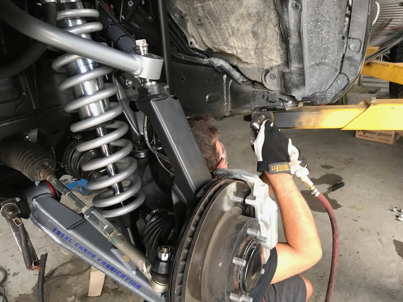

    Said it in the LTBS thread too, but that's not the TC race kit on there dude. Might wanna clarify with your builder.
    You have the standard kit: http://www.chaosfab.com/2016-2017-Tacoma-2.0-Long-Travel-Suspension-Kit-86000T-16.html
    Give aways are the lower arm angles and the uniball adaptors instead of being incorporated into the lower arm. A race series arm would look like this: image.jpg
