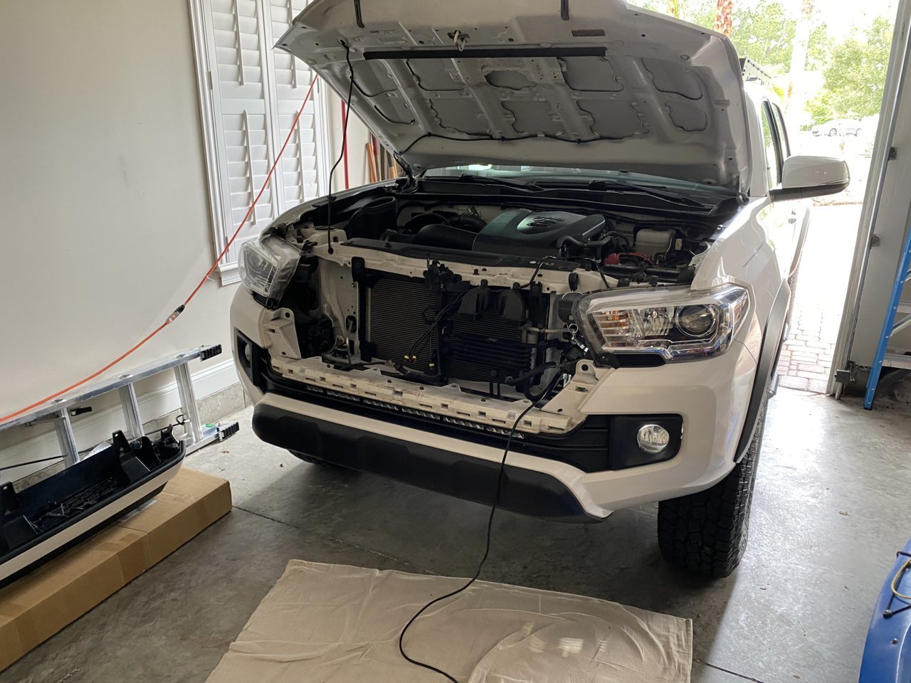

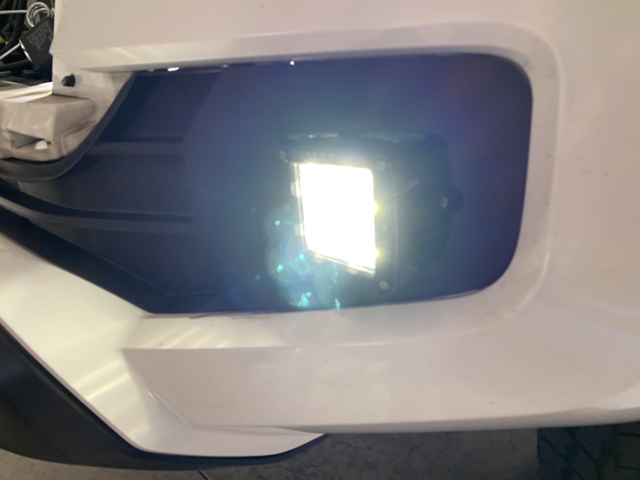

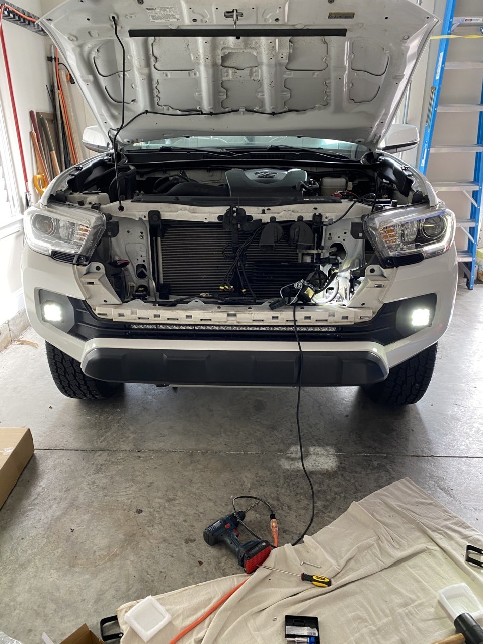

    B2F3577C-450D-45AF-9E01-B8D7EC34B05C.jpg 605ADB2A-74BC-4751-A15A-C3AFA57120BE.jpg 991187C4-F50A-4FE8-8122-BEF874ADF47C.jpg 59CFBFA1-EF53-4617-BBA2-72F210FE4F27.jpg I became frustrated w/ this install via lack of detailed instructions from Cali Raised but was finally able to seat the pods within the brackets while aligning the mounting holes properly by literally tapping the pod in place w/ a rubber mallet...covered the pods well to protect them w/ the foam shipping material they came with while tapping into place...seems the power coating made it impossible to fit inside the pod’s “ribs” by hand. Used a thin flathead screwdriver to hold mounting nut in place to tighten.

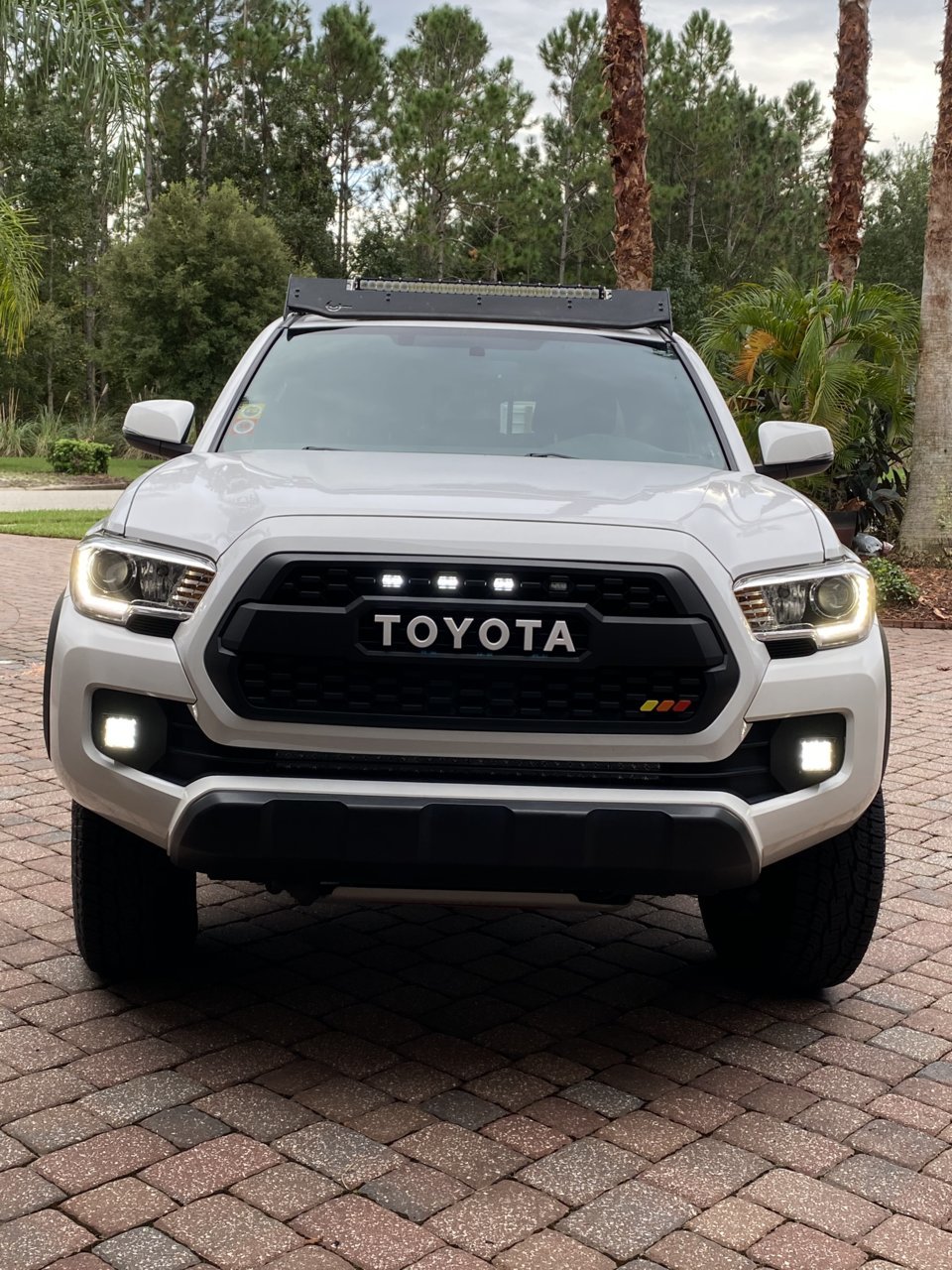

    Took a while to get them lowered as much as possible so the spot beam was at just below the same level as my headlights...wish @CaliRaisedLed designed the brackets to allow 2x2 spot beam pods to adjust lower to make street legal as possible...and....if anyone has ANY suggestions on how to drop below OEM headlight level??? Help a bro out! Plz send over all details if possible!
    For anyone else installing these, def remove the grill and air dams to install from the front vs going from below as instal video suggests as the wheel wells are in the way.
    Gotta’ say the 2x2 pods are def’ super bright and look great...match up super well w/ the Cali Raised hidden bumper LED spot bar...just looking to not blind folks and stay as street legal as possible...also worried that with an upcoming 3” lift and 285/75/R17s it’ll make all the above much worse.

    Your problem is the beam pattern - which is not SAE compliant. As much as you want to aim the pods down to avoid angering oncoming drivers - which as admirable - the beam pattern is working against you. By the time you get them down enough to solve your original issue, you'll find that you're aimed pretty well at the ground - which defeats the purpose of the driving beam pattern all together. The best beam pattern for that location is actually an SAE compliant fog pattern.
    What you really need to do first is ask what you're trying to get out of lights at that position.
