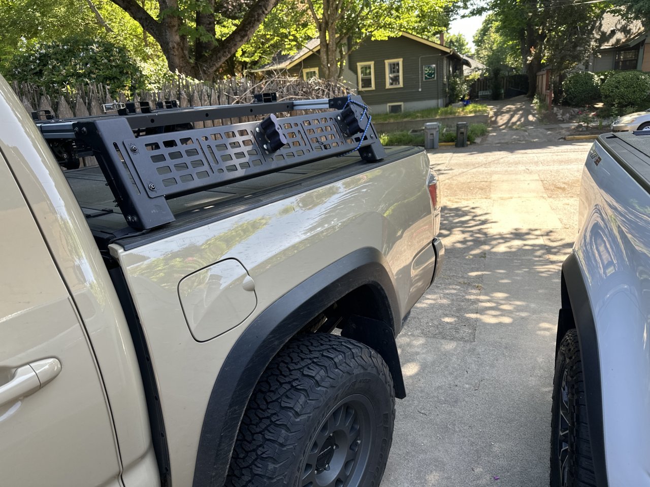

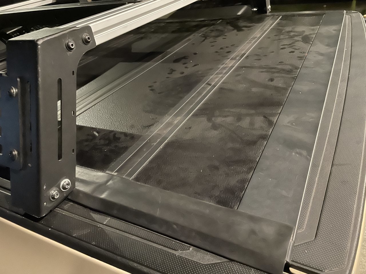

    I have a leer HF 650 tonneau and a mid-height caliraised overland rack. I made it work by cutting an inch off the cross beams of the rack and making small slits in the rubber seal of the tonneau at the 4 points where the base lands. I don't have leaks where I made the slits. the leer 650 has 4 panels, so with the rack mounted forward, the last panel can open fully; I use a bungee to keep open when camping. It took me a good 2 hours to get the rack centered and mounted, so essentially permanent.

    That looks good. I'm thinking of just cutting out the slots on the cover I have. I've got the mid-height rack too.
